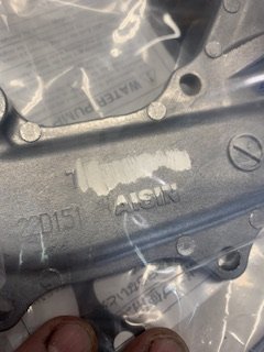

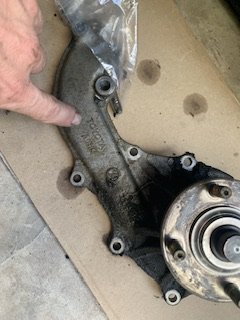

    Clock Volt meter/LSPV Delete/Hyundai 16’s/FP gauge/after 9months of wrenching ZERO oil leaks
    Funny^^^
    Look at my original OE water pump
    And then the RA water pump I installed
    Wyoming[OP] likes this.

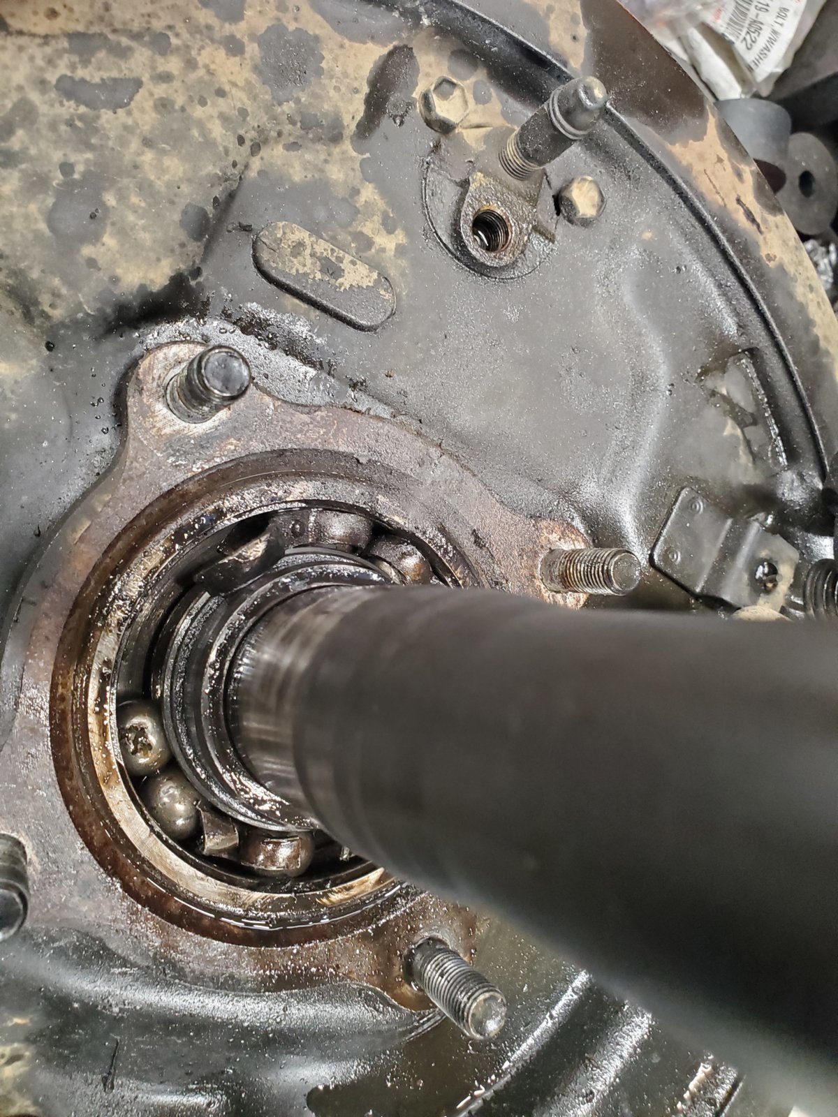

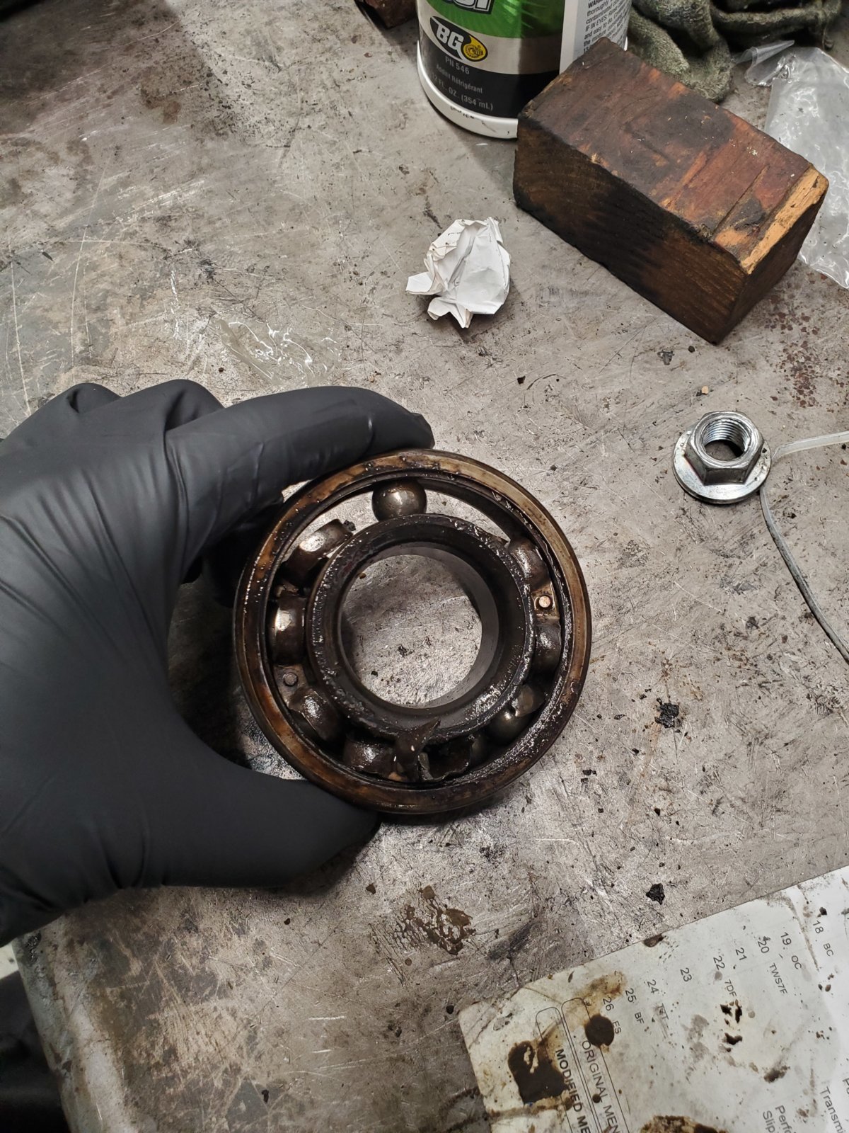

    Toyota discontinued rear wheel bearings. I just had one fail in the worst way possible and I could not get a oem wheel bearing so now my perfect truck has an aftermarket napa wheel bearing which after 4 days is still working fine.

    :confused: Not sure what truck you have, but 6 lug 1st gen front and rear(90363-40068) wheel bearings are still available...
    That bearing didn't just fail, you've had to have ignored that for awhile for it to look like that. The presence of gear oil tells us that axle seal has been blown for quite some time.
    Also, Toyota doesn't make the bearings, nor does Napa... Koyo and TIMKEN also still appear to have them available. The "OEM" ones are most often Koyo.
    Wyoming[OP] and Bivouac like this.
