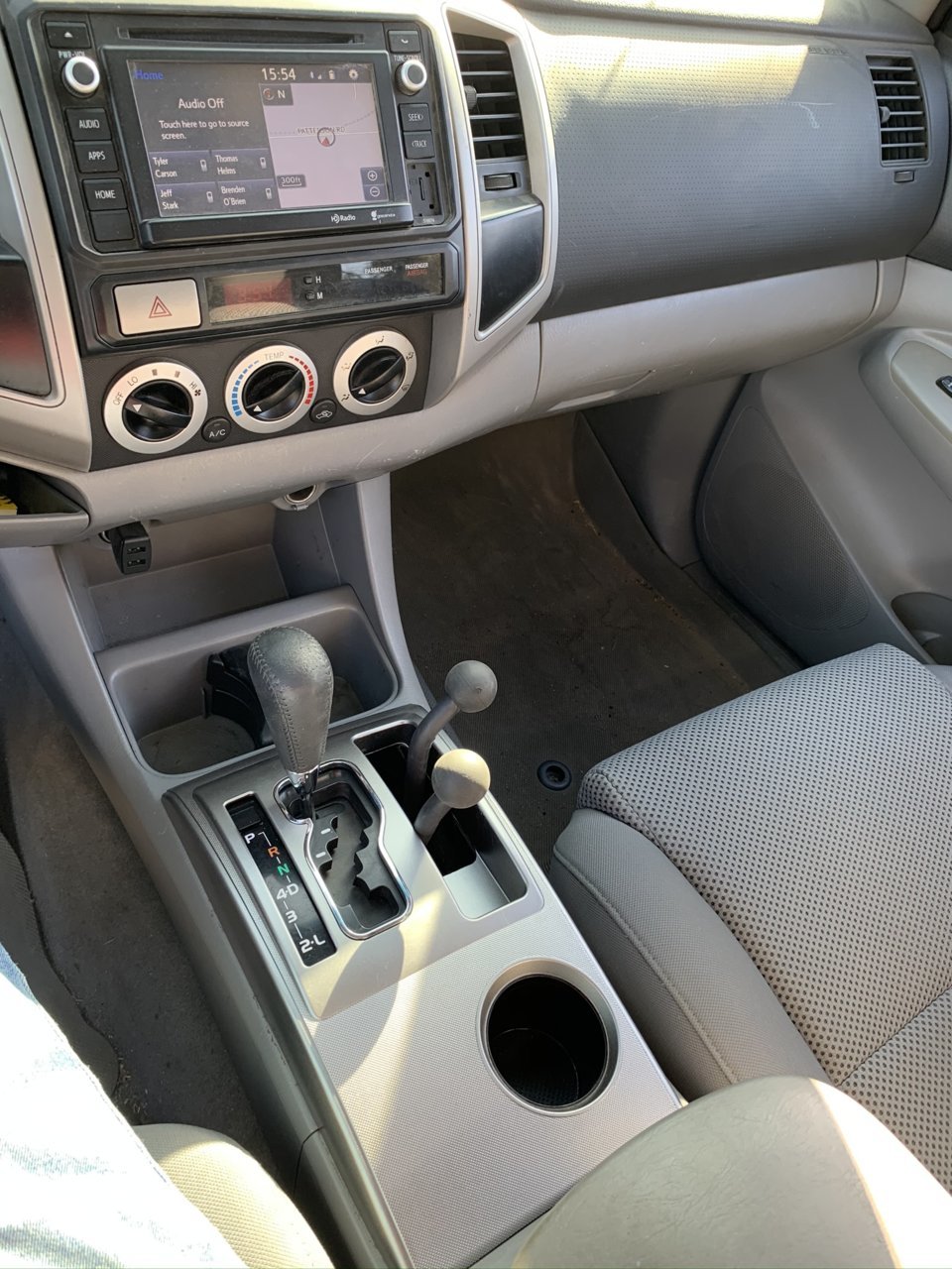

    you having the sticks come up in the cubby to the side of the shifter? How did you bend them? Taking notes for when I do my swap.
    Also, what did you do with the front diff? Keep add?
  6. Sep 27, 2019 at 3:50 PM
    #106
    foxrcing07
    foxrcing07 [OP] KO7FOX
    Aug 12, 2016
    #194389
    4,024
    Morgan
    Modesto, CA
    2019 Raptard 2001 TJ
    Dirt
    It was a prerunner, so when I planned the swap I used a non add front diff
    and I plan to have the sticks come up thru the pen slot in the console
    I bought a compact bender from harborfreight which is available for use by the tacoma public
    that being said it was $77 so not a huge investment

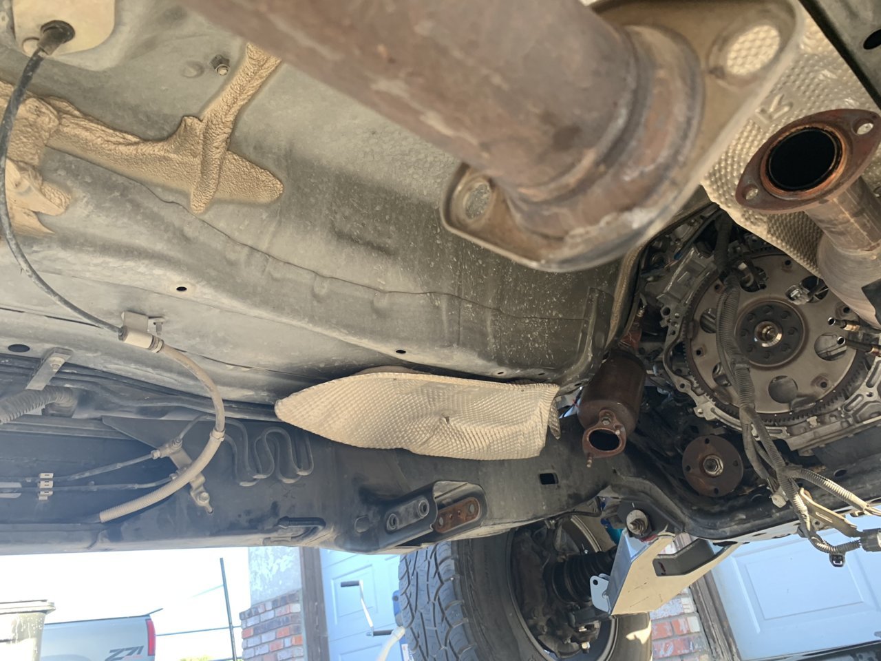

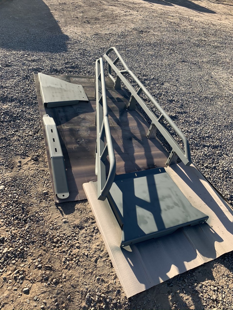

    finally closed up, still might need some tweaking
    Also picked up a BAMF mid skid and transfer case skid and finally pulled my sliders out of the barn to start getting them ready to go on the truck
    Just need to get a IFS skid ordered

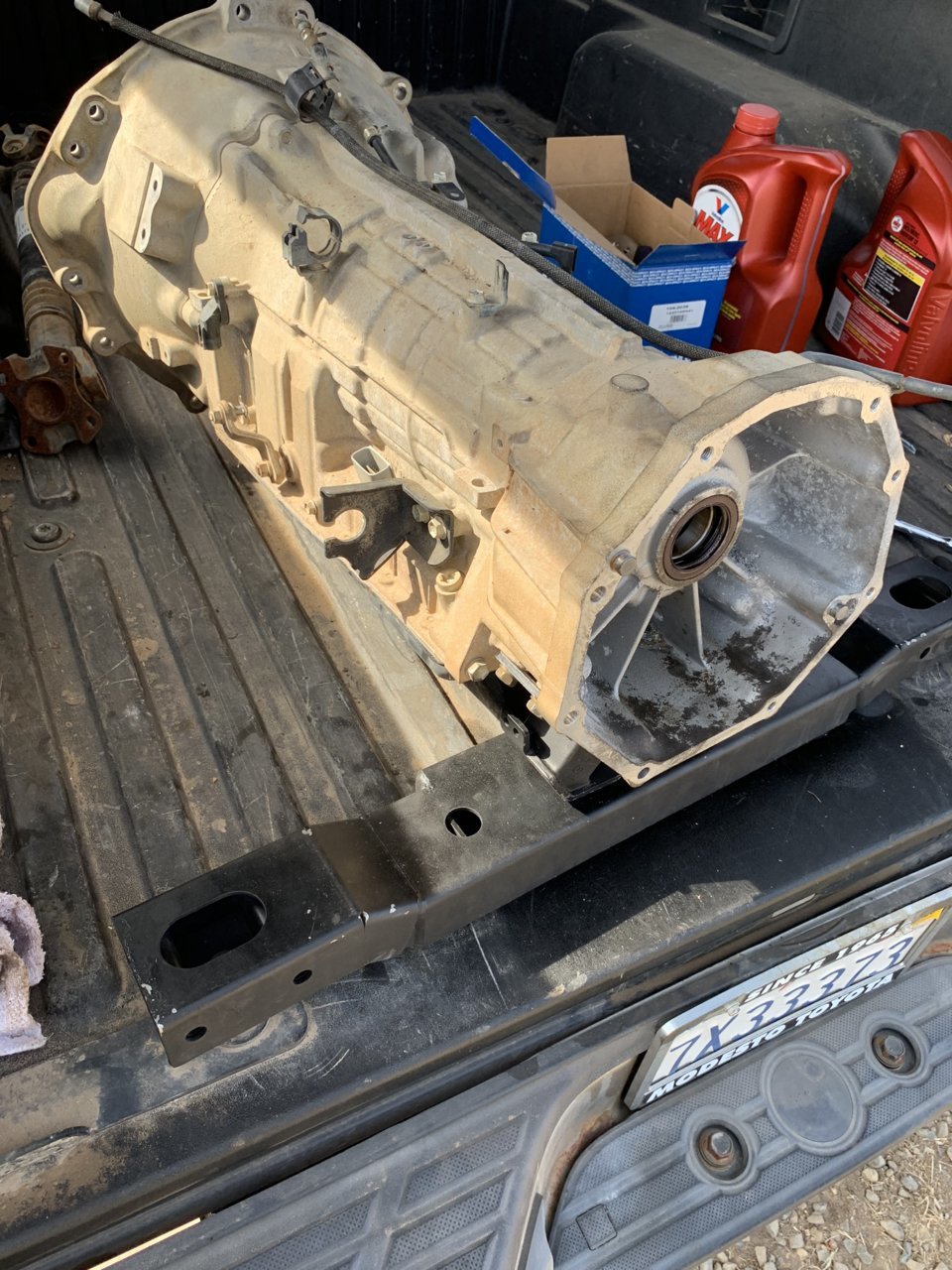

    Where did you order the driveshaft from? Do you have the specs (length, flanges, etc)? I am gathering parts for my conversion and am trying to minimize down time by buying as much as I can up front.
  17. Oct 10, 2019 at 10:44 AM
    #117
    foxrcing07
    Aug 12, 2016
    #194389
    4,024
    Morgan
    Modesto, CA
    Dirt
    I bought an oem driveshaft from a wrecking yard, if you do that you have to move the crossmember that holds the carrier bearing back (the holes are there)
    I just ground/drilled the rivets from the cross member to frame and moved back to the other holes that were already in the frame and then bolted it in place
