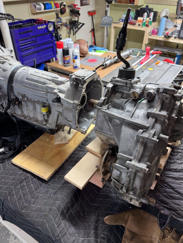

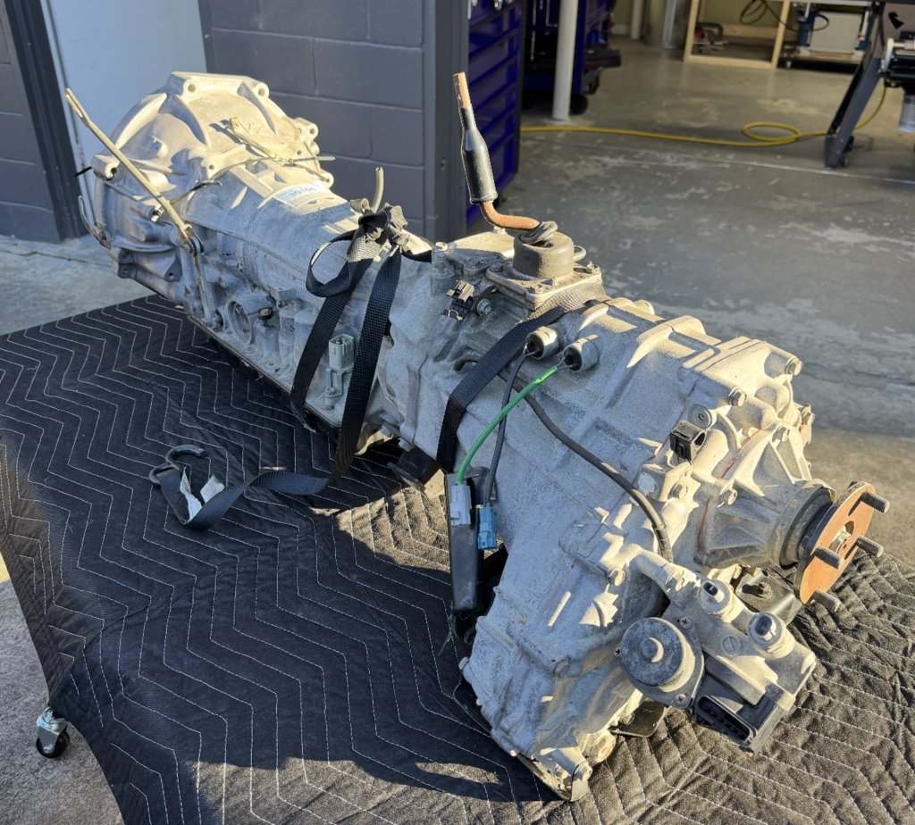

    Ok so an update with where I'm at. As noted I got the trans from a 2000 4Runner, which came with a mated MultiMode T-case. Which is super cool, however largely not useful to me as I'm not interested in embarking on the journey of adapting a multimode case, and I'm not even sure if it's possible starting from a PreRunner. I was able to source a junkyard '98 4Runner J-shift Tcase, as well as a 4Runner front driveshaft. I'm just going to sell the multimode eventually. Trans is in amazing condition, j shift and front driveshaft not so much as you can see from the pics, however the internals and fluid from the case seem great, it just needs to be cleaned up which is fine. I'm going to do a complete overhaul on all driveshafts, so I've already cleaned up this front (degreased, u-joints removed, surface rust removed with evaporust) and I'm going to paint it and replace all the u-joints that I can access. I also plan to get them balanced before installation. I'll probably be in cleaning and restoration mode for quite some time, I'm just going to replace/restore as much stuff as I can as I don't see why I wouldn't go the extra mile if I'm already committing to all of this.

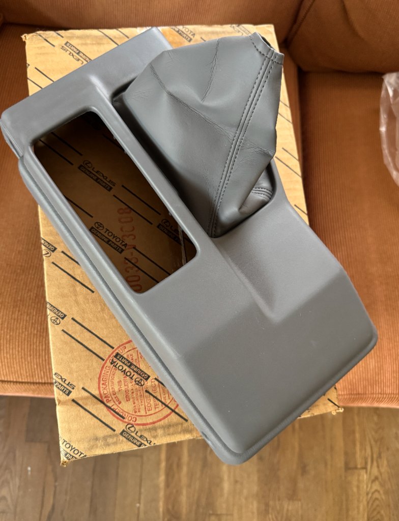

    Forgot to mention I secured this (now discontinued) new in box shifter bezel from another member here to match my charcoal interior. I'm a sucker for the details and it makes me so happy knowing I'll have a crispy interior set up as it would have come off the lot from a 4x4

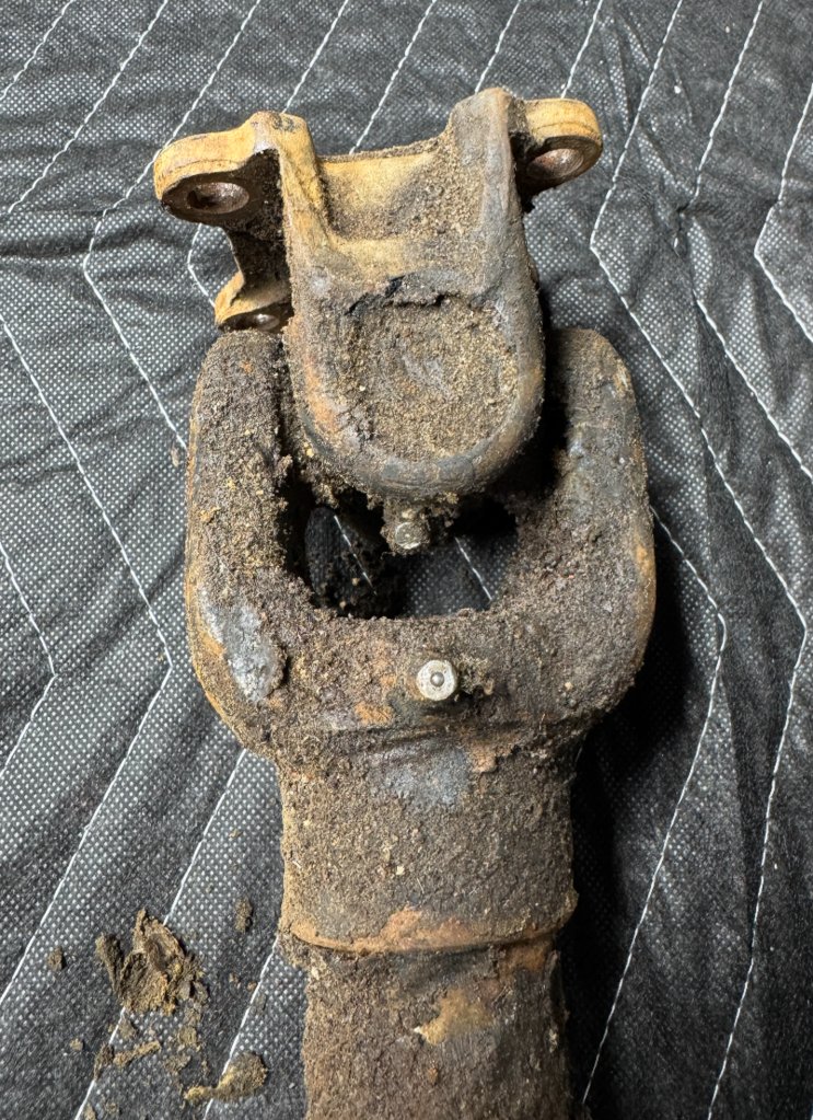

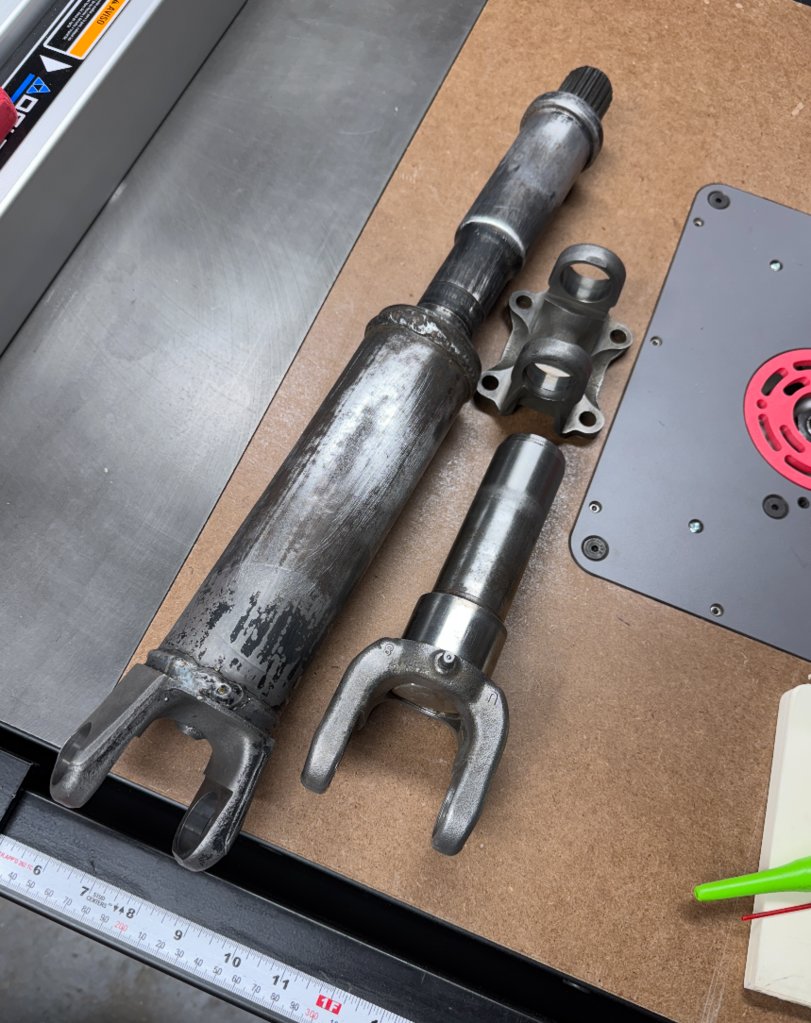

    Today's update, got the front driveshaft cleaned up and U-joints removed. Can't say I enjoyed that process.. new u-joint kits have arrive at the dealer. I also finally popped the multimode case off of the trans and put my j shift up there to make sure everything looked right. That multimode case is a behemoth compared to a normal j shift. Everything looks good, one thing I need to figure out is whether the guide pins at the trans/t case union should be in the trans or the t-case to start, I have a peg in the same hole on both pieces, so just need to figure out which one to pop off, although it probably doesn't matter. I also decided I'm going to do all of the input and output shaft seals on the trans and t case just because, but also I'm going to do my rear main seal as well. Seems like a crime not to do it when it'll just be a few bolts away behind the flex plate after removing my A340E. Having a hard time sourcing a front diff and rear drive shaft for some reason, the search continues.

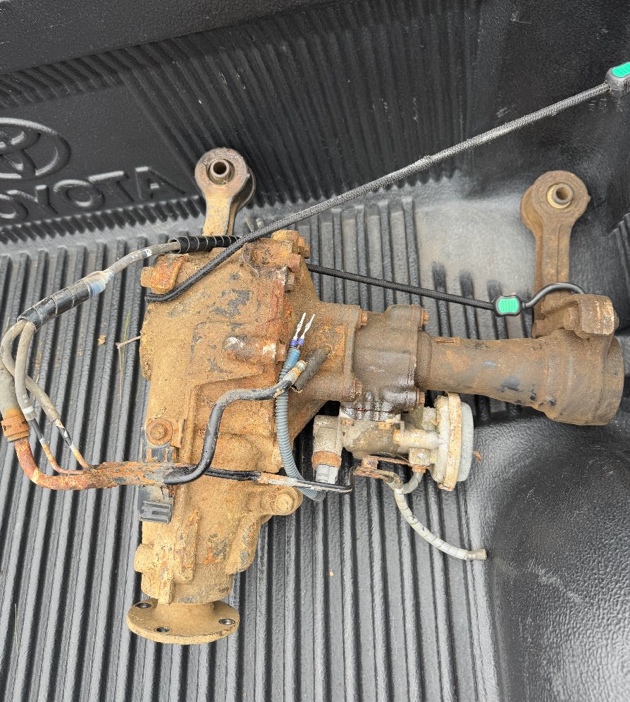

    Picked up a front diff and rear driveshaft! Which completes all of the junkyard parts that I will need for the build, the rest of the part collection will just be online ordering. I don't seem to have much luck sourcing any parts not caked in mud or grease lol, but oh well, the internals are good.

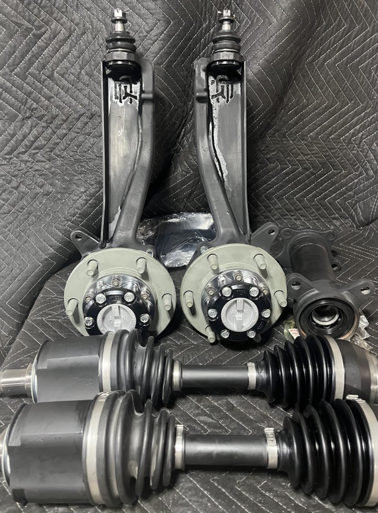

    Don’t forget these, they pair well with that J-shift transfer case and alleviate any potential or future issues with that ADD system.

    Do you mind expanding a bit? Looks like a non-A.D.D. Diff tube (I’m just planning to use the clamp lock method), CVs (anything special about these other than being for manual hubs?), and reinforced knuckles with manual hubs (any reason for the reinforcement?)

    Sorry forgot the quote your message but see my reply “Do you mind expanding a bit? Looks like a non-A.D.D. Diff tube (I’m just planning to use the clamp lock method), CVs (anything special about these other than being for manual hubs?), and reinforced knuckles with manual hubs (any reason for the reinforcement?)”

    1. The knuckle reinforcement is an additional option, pending upon your level of use or abuse as the neck on this design is weak. However, it isn’t for everybody for sure.
    2. The manual knuckles are simply that and nothing more. Allow for the use the 2WD LO, non spinning CVs equal less boot wear, some claim MPG from parasitic loss, able to remove if broken without having to worry about the wheel bearing.
    3. Manual diff tube just pairs with it all as an additional option as well if you are looking to go completely away from ADD. Again, I have a lot of customers that use the hose clamp technique but this is just an extra option as desired for the purist.
    Other than what you pointed out already, all OEM seals, hubs and gaskets in the rebuild designed for use with or without ABS.

    Sweet! I definitely won't be a great candidate for reinforced knuckles haha it's a bit of a pavement princess I just want to have 4x4 capability on. I'm planning to just swap the guts of my current prerunner knuckles with all the gear for manual hubs, but I'm definitely interested in the manual diff tube swap as ideally I don't love jerry rigged solutions. Do you sell these? Curious what you get for them if so. This is a 4.10 set up if that matters for the tube, not sure what internals are contained within this part of the diff or if that matters for gear ratio. Thanks for the details!

    1. I rebuild these kits as manual conversions or just rebuild for folks that need new bearings.
    https://www.tacomaworld.com/threads/for-sale-4x4-manual-hubs-spindles-knuckles-and-cvs.709082/
    2. The manual differential tube is universal for any front differential. You just pop off the ADD setup then apply fresh Toyota FIPG and bolt it up. I provide new OEM outer seals on them when they are shipped as well.
    3. I will send you a PM with the full list of options that you can choose from including Upper Ball Joints for a full bolt in setup. You can either send me yours to convert or just send them in to me later once you swap for a core refund. Your choice. I ship these directly to your door via UPS. Although, I will be in Lenoir and Semora next month!!!

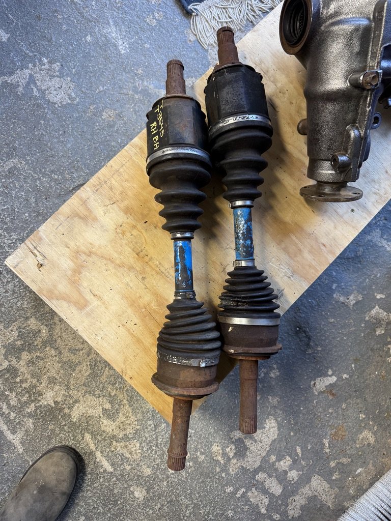

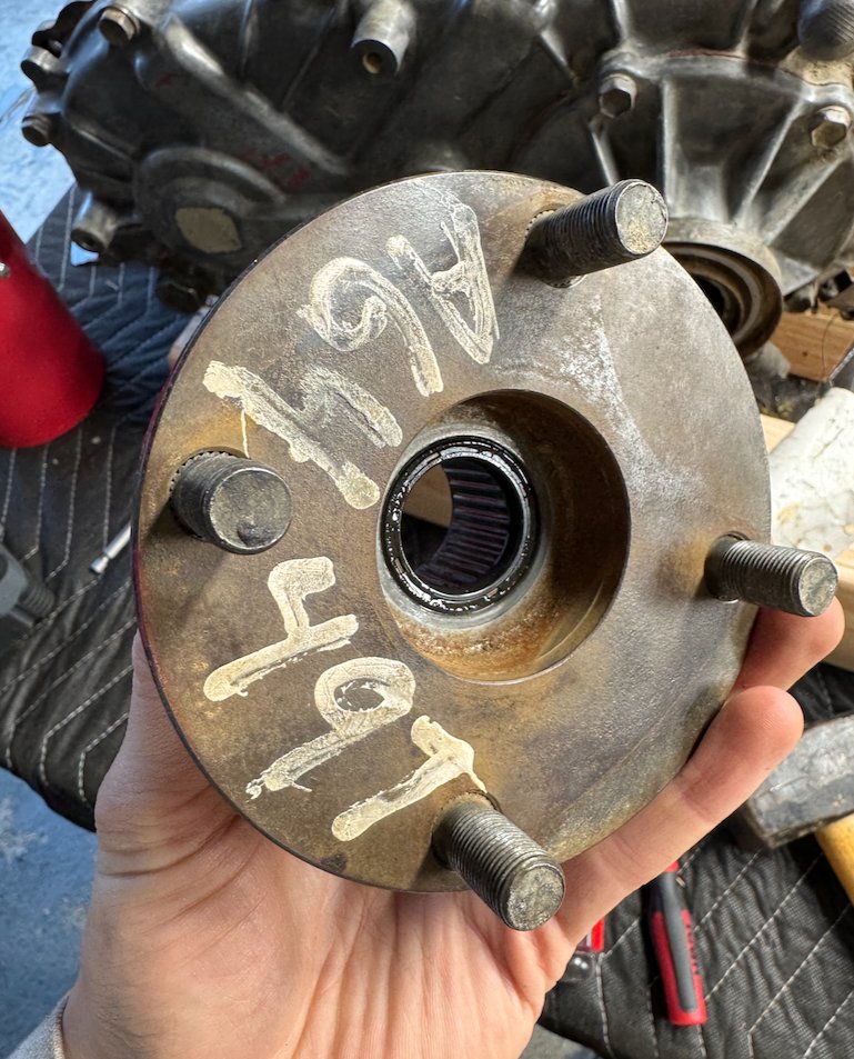

    Picked up some junkyard manual hub CV axles today for $35. I swear I haven't sourced a single clean part this whole journey lol. 85% of my time now is cleaning and refurbishing/rebuilding. I also realized the rear driveshaft I have isn't the correct size, so I need to get that swapped.

    I converted my 2003 tacoma V6 about 3-4 years ago. Did a lot of research before doing the conversion. It really is pretty straight forward as everything is almost all bolt on aside from a few mods. Totally worth it at the end. 4wd is much much more fun. Good luck with you project. Everything is looking good.

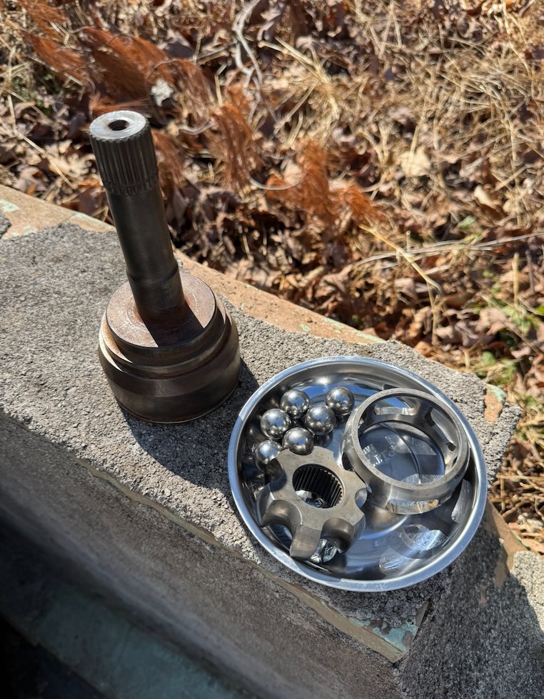

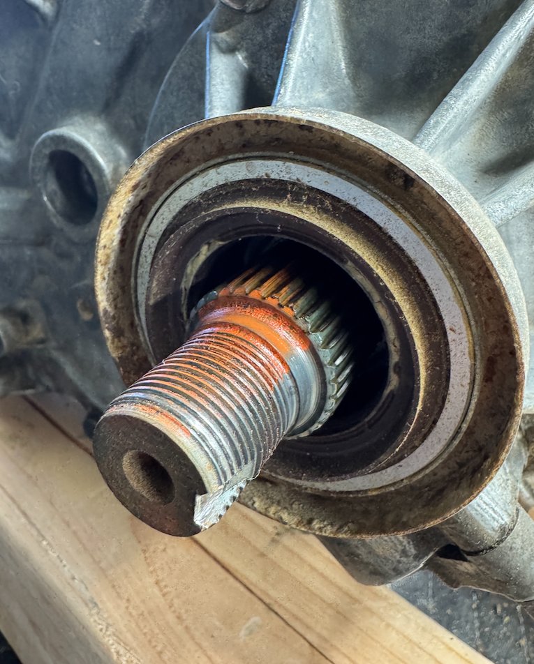

    CVs while a bit rough looking initially have actually cleaned up really well, and by the grace of god I got the entire assembly apart (including the side Toyota doesn't tell you how to take apart). Everything is taking an evaporust bath and once I get the reboot kits I'll be good to go with OEM CVs. I was originally going to get aftermarket CVs and hubs but now this makes me want to track down some OEM hubs too. I also popped one of the flanges from my transfer case off, came off easy although unstaking the 30mm nut wasn't as easy. I'm going to overhaul all of the seals and such and restore/repaint the flanges too.

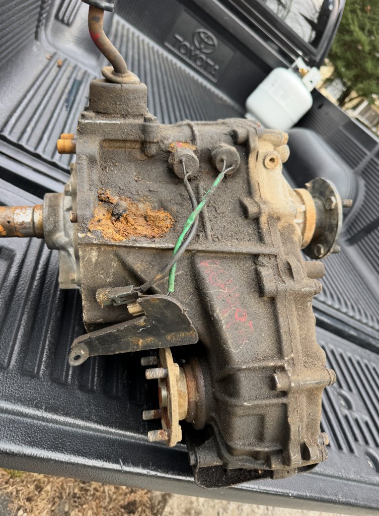

    I've had pretty good luck I'd say, I got the t-case, front shaft, and these at the junkyard so far, all within an hour of me in western NC. I've just been checking on car-part.com for stuff as I need it and have had decent luck that way so far. That said nothing I've gotten from the yard has been in great shape. Luckily I don't mind the restoring process but I'm kind of getting bottom of the barrel stuff lol. Theres also a few guys in the area that have 1st gen tacoma and 3rd gen 4runner specific junk yards, which is where I got the diff and rear shaft. I feel grateful that I was able to source the trans first from a private seller and it's in excellent shape, everything else I can get away with restoring myself.

    Toyota discontinued those OEM outer CV seals, you may get lucky and find a dealer with some in stock but they are removed from most dealers now unless they have them on the shelf. Just FYI.
