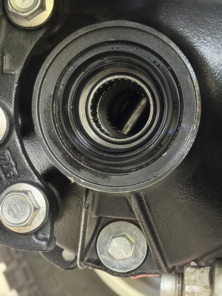

    Finally got around to replacing that leaky driver’s side front diff seal and it appears to have done the trick. It’s still a mystery to me because it was seated perfectly flush and upon inspection there was no damage to it, so who knows, clearly something was up with it. Pic shows the leaky seal seated. I also made a short of the job, check it out, I’ve been trying to post more vids
