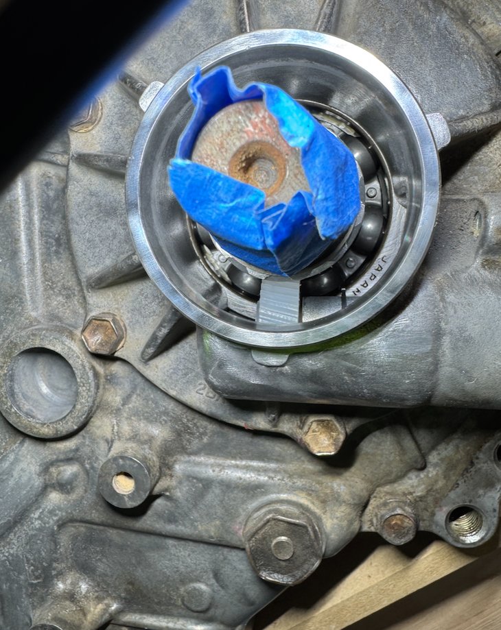

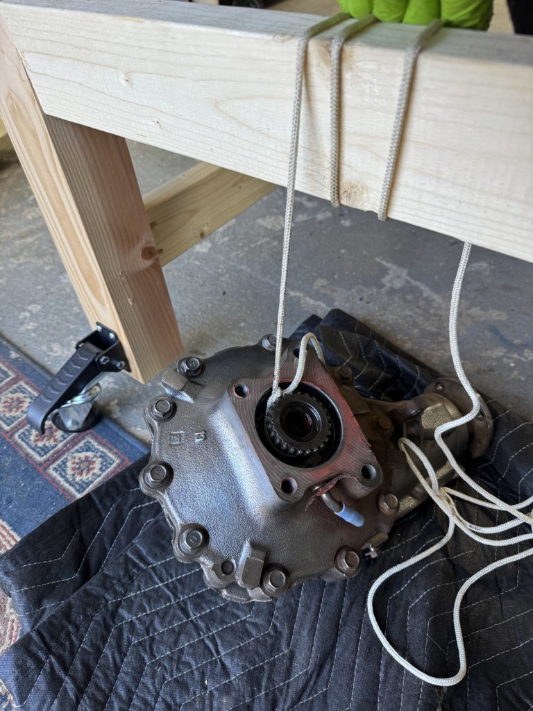

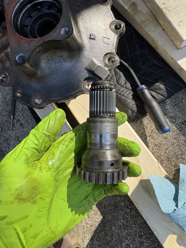

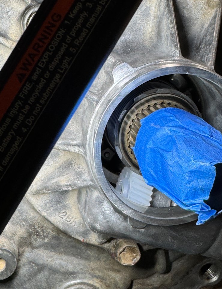

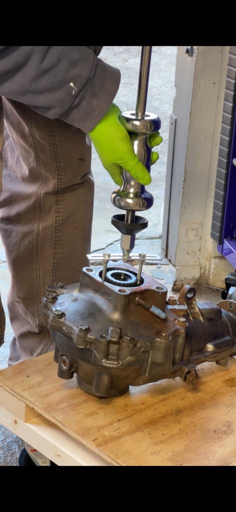

    A ridiculous battle with the A.D.D. Intermediate shaft today as I tried to swap in a manual diff tube. It’s held in with a similar C-clip that holds your CV into the diff, and I had the same trouble as Timmy the toolman did in his vid. Thing would not budge. I don’t understand all the posts just being like yeah use a screwdriver to lever it out. I made a custom slide hammer jaw, tried suspending the diff from the intermediate shaft and hammering the body down, and every variation of prying I could. In the end I had to open up the clamshell, and then it was just a few easy taps from above to get it out…infuriating. Well, at least I was able to confirm it’s got 4.10 gearing, and I’m able to thoroughly clean the innards/shell more easily. Any reason I can’t give the main gear cluster a brake cleaner bath?
  5. Feb 28, 2025 at 1:33 PM
    #25
    Toyoda213
    Toyoda213 Well-Known Member
    Nov 8, 2017
    #235466
    1,040
    Jimmy
    SoCal
    2003 V6 dlbc Prerunner 4x4 converted
    When I did my 4x4 conversion the plan was to slap a manual tube on but was not able to get that shaft out. I tried numerous times and with different approach and just couldnt get it out. I finally decided to just roll with the hose clamp mod. Glad you were able to get it out

    That was definitely my original plan too but I figured what the heck if I’m only doing this once I might as well go all in lol. But yeah it’s nearly impossible without disassembling the shell I feel, the FSM depicts some wonky special service tool, presumably a custom puller

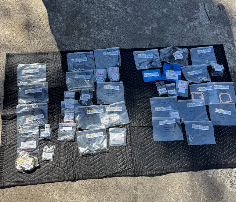

    Picked up a massive parts order from the dealership today, I'm on a first name basis with the parts guys now lol. Massive bummer is that I placed the order which was like $350 literally one day before Toyota started a 25% off all parts promo...so that sucks. I still have to buy some big ticket parts so will still take advantage of it though (I had no idea you could still buy the manual hubs brand new from Toyota, so definitely getting a set). This order was mostly hardware and seals. Also finally getting some paint on the parts, finished up the CV axles, front diff brackets, and front driveshaft. Everything looks so good cleaned up with the fresh hardware. I'm getting kind of sick of the restoration phase of this project but I know it'll pay off in the end to have crispy parts when I'm putting it all together.

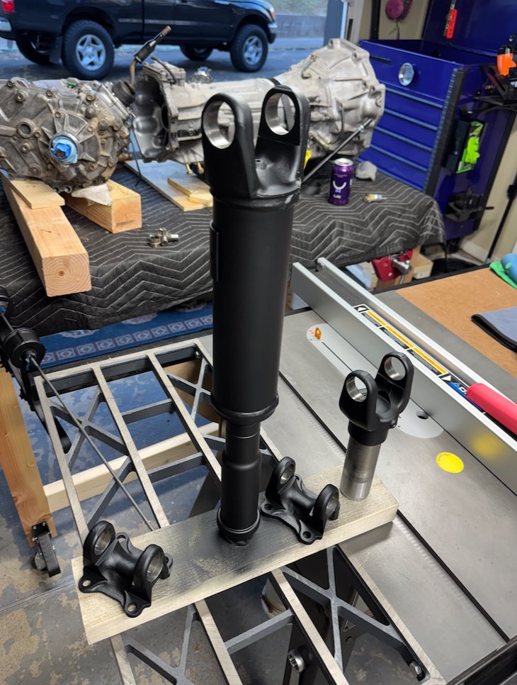

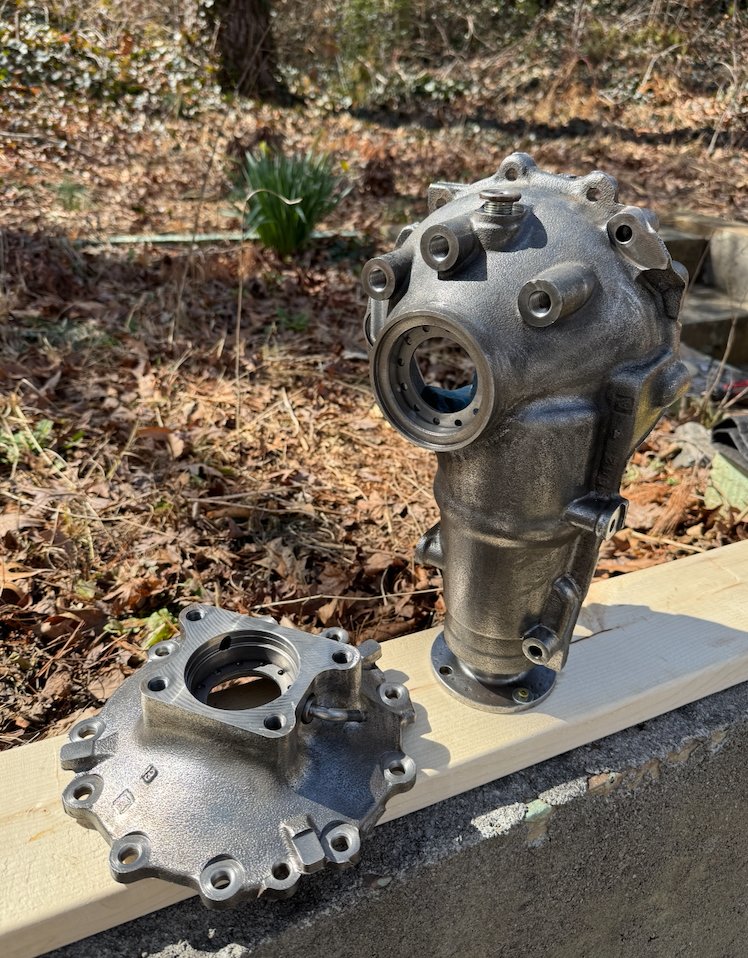

    The black I'm using is just Rustoleum Flat Black, but I've either been using self etching primer or a rust encapsulator first! The driveshaft I was able to sand down to bare metal pretty easily but the CV stuff and the diff had some areas of light pitting so I just got as much of the rust out as I could with evaporust/wire wheel/sanding/die grinding and then coat it with the encapsulator. Seems to be working well, we will see about longevity! Everything is going to have quite some time to cure since I'm not really close to installing yet.

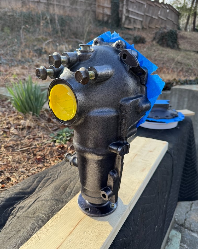

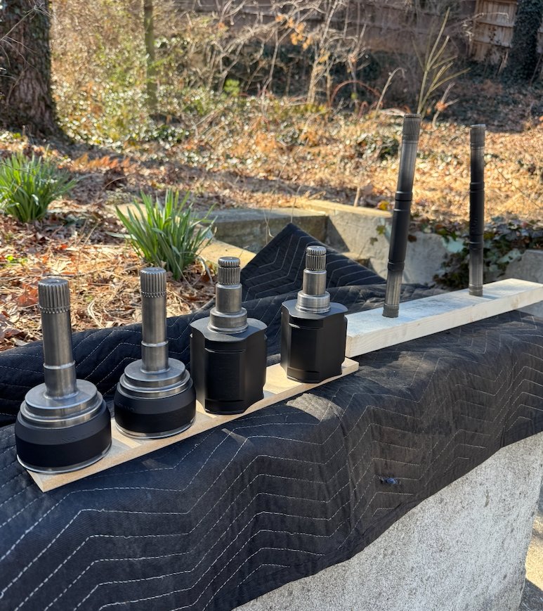

  17. Mar 5, 2025 at 2:33 PM
    #37
    dngrrngr
    dngrrngr [OP] Well-Known Member
    Jun 5, 2023
    #426170
    136
    Western NC
    2003 3.4L Auto XtraCab PreRunner 4x4 Conversion

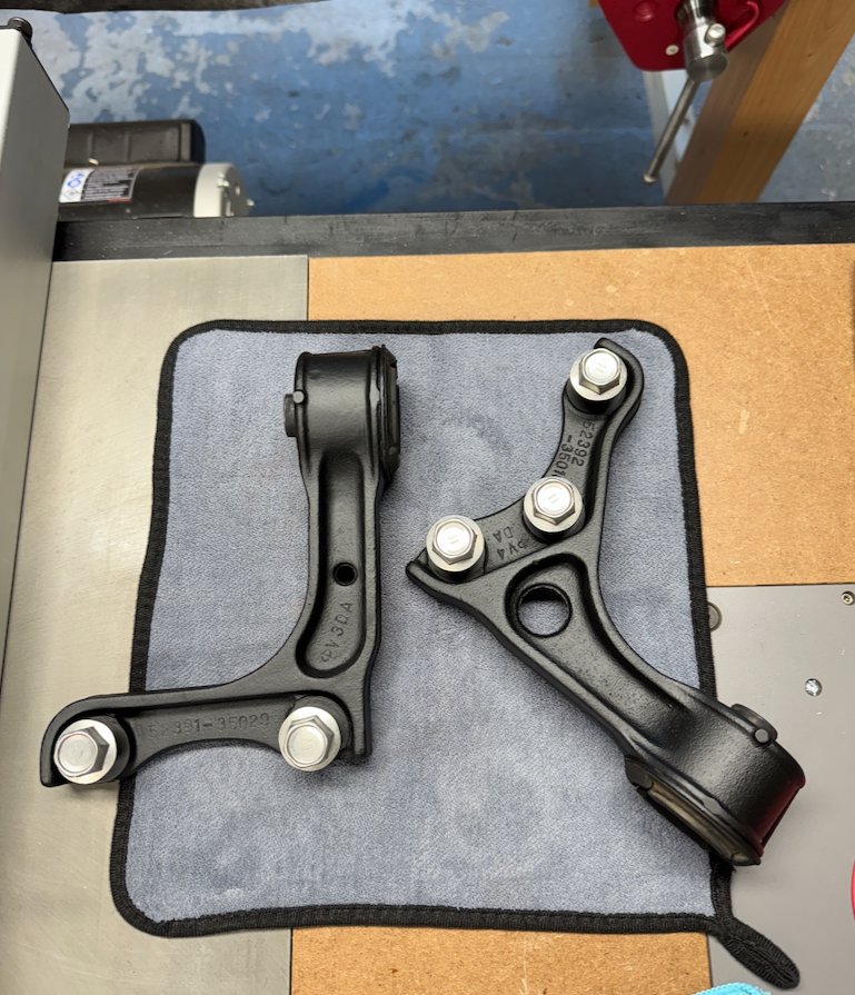

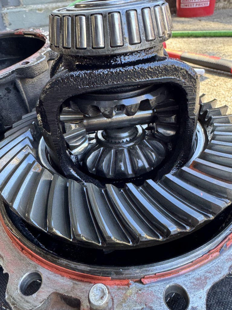

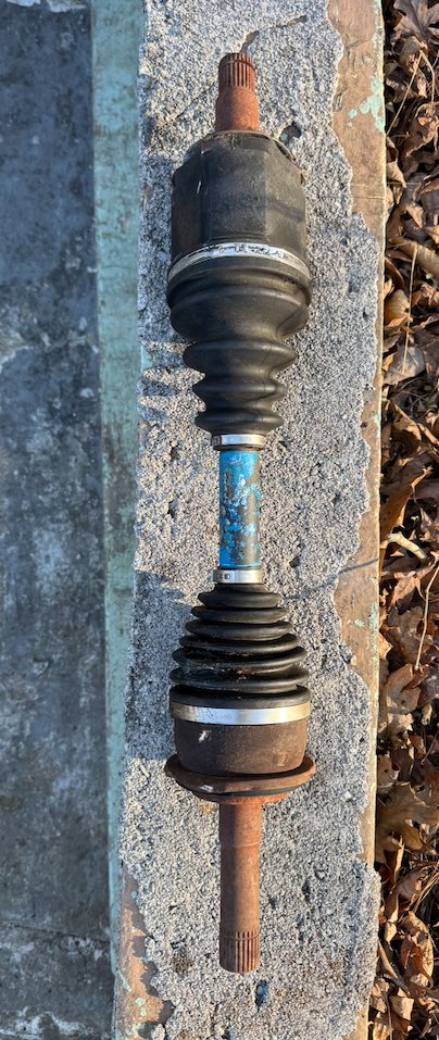

    Finished getting the front diff down to bare metal today and got it masked to paint. First coats today were with a rust reformer, will top coat it tomorrow with flat black. While that was drying I also got the new seals on the CV axle and reassembled one of them with a new reboot kit. The side with the star bearing was a pain to get back together, but lots of swearing later it's all sealed up with 100% OEM parts! Before and after pics for comparison of when I picked it up from the junkyard.

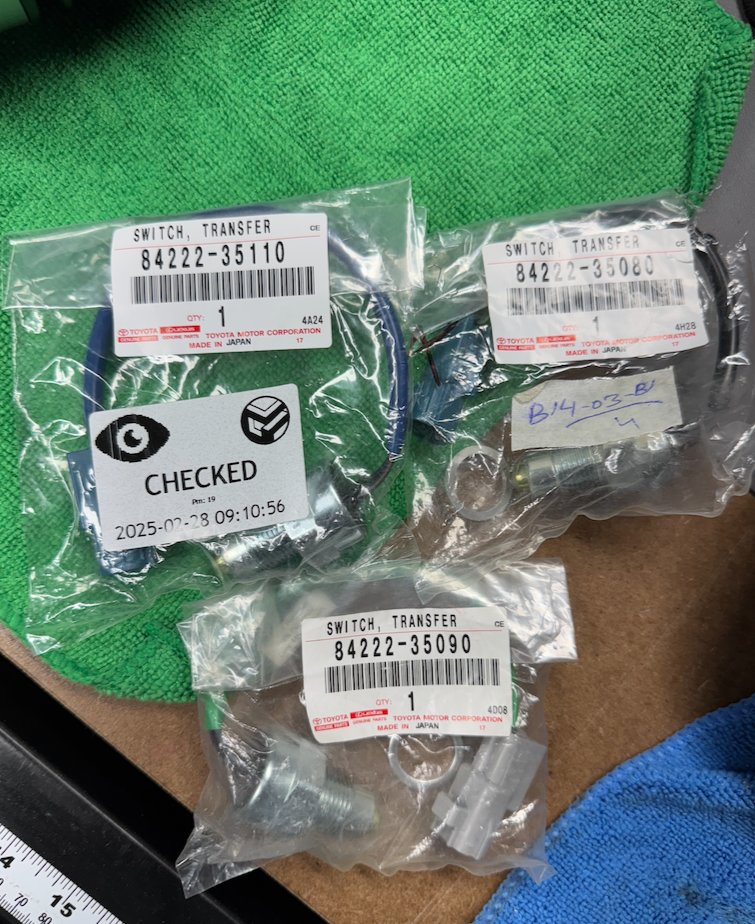

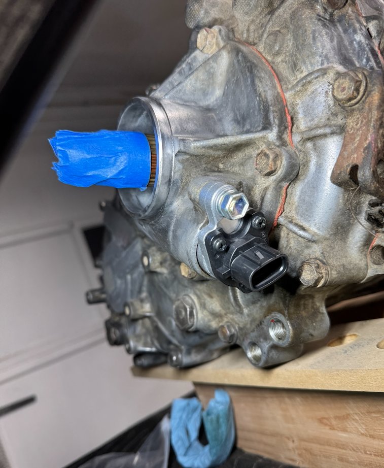

    Also just got my PartSouq delivery, I ended up ordering the three transfer position switches, VSS, front diff rear mount, and a few other things through them. It seems like for big ticket stuff its worth it to use them, even though shipping can stack up quick. I think I saved something like $300 vs. buying through Toyota online, most of the items were roughly half price what they were from Toyota. Shoutout @Area51Runner for the VSS write up, I just mocked up the sensor and everything appears to be good to go. Switch fits in the transfer case perfectly and the 30 tooth plastic worm gear matches up inside the t-case and turns with the gear!
