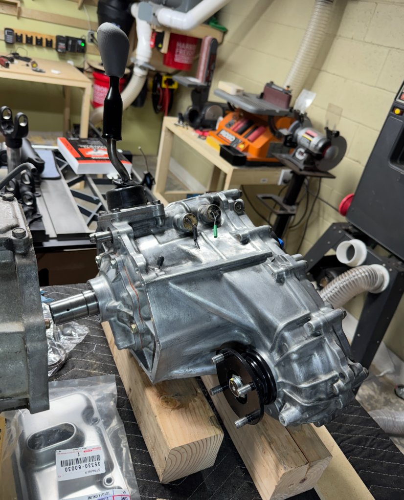

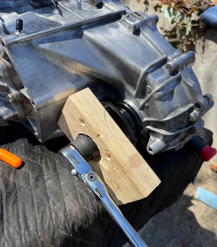

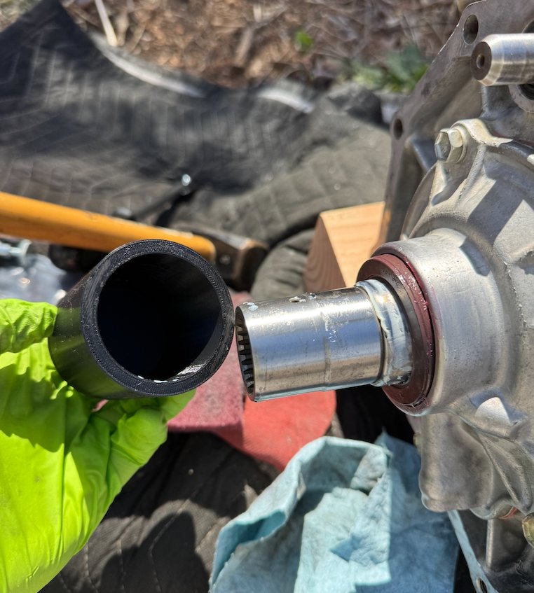

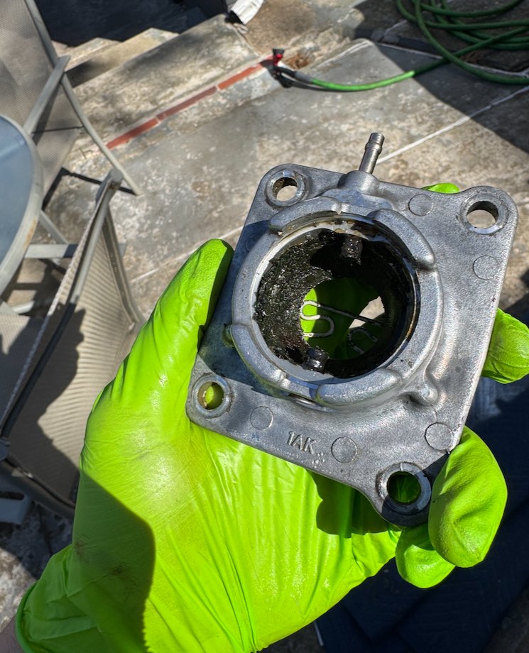

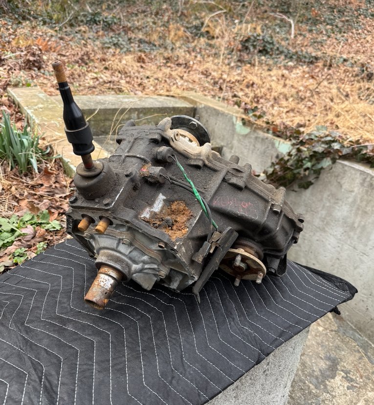

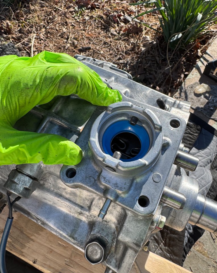

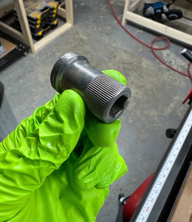

    Good progress on the transfer case today, I've given up on trying to clean up the case any further, it's not as good as the other parts I've restored but it's good enough. I ended up 3D printing several custom seal setting tools to make my life a bit easier for some of the trickier placed seals, and they've been working great. Got the front driveshaft flange back on (peep the custom "special service tool" I made to be able to torque the flange nut lol), installed the marlin crawler shifter seat (the OEM seat was totally disintegrated, seems to be common), and popped in most of the seals. Also started to restore/paint the rear driveshaft, I never want to remove a u-joint again in my life, I fought this one particularly hard.

    Tcase cleaned up pretty good. Careful with them small keys where the shifter goes. I've heard if those fall out it's a mission getting them back in

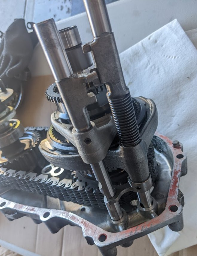

    Actually, around the shifter is fine.
    Those "keys" you mentioned typically fall out when you split the case open and don't pay attention to how you monkey about with the shift rails/clutch sleeves. Ask me how I know :rofl:.

    Oof yeah I am really hoping to avoid splitting the case open at all loll. That said I didn't notice any free movement of the keys while I had the shifter out, so good to know that is a fairly safe procedure!

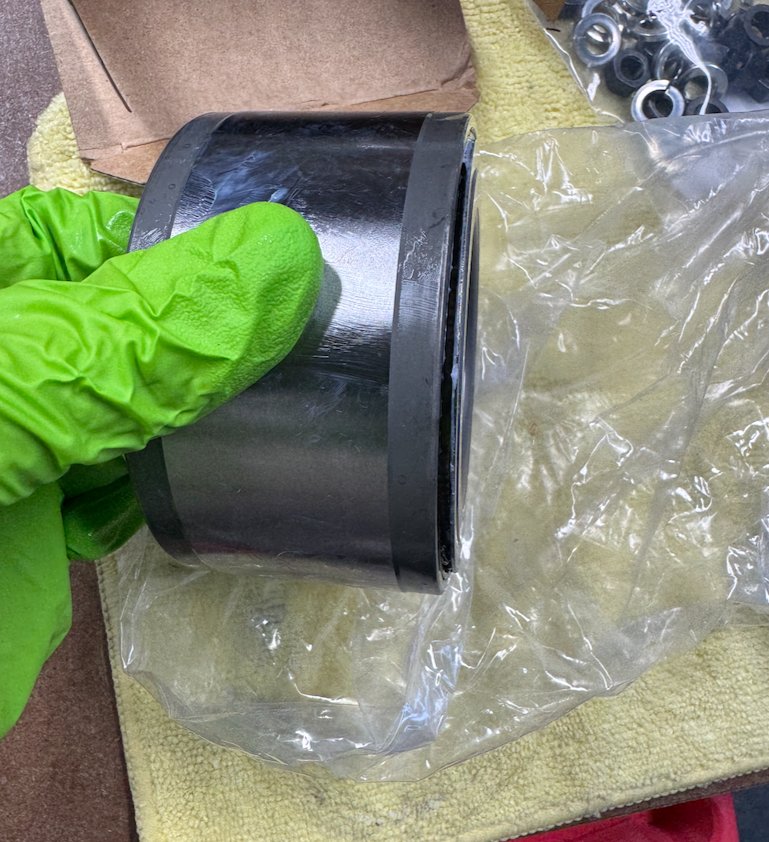

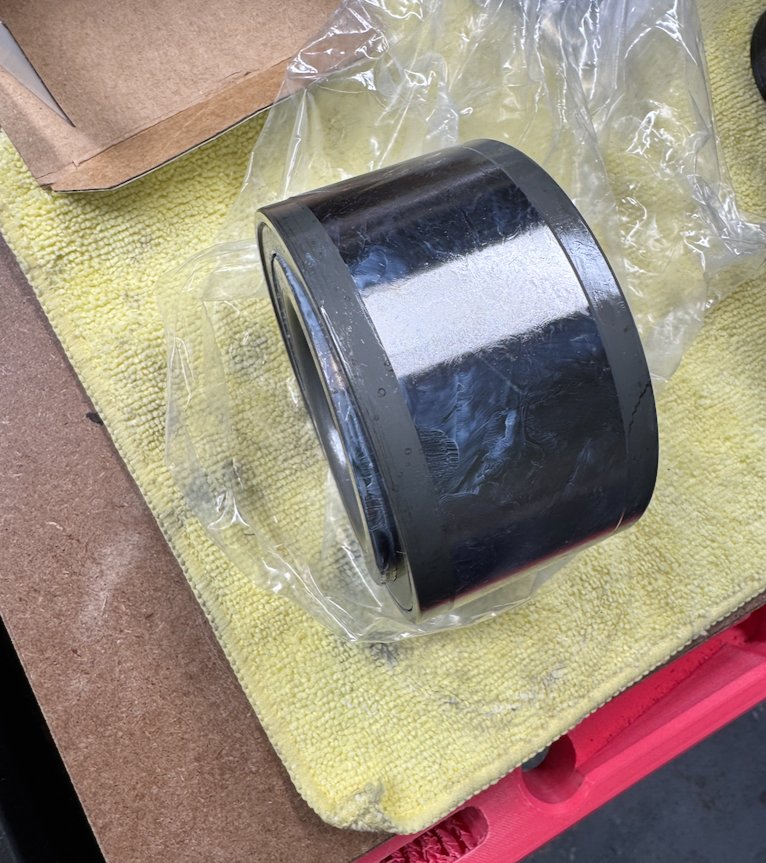

    Also, my first big dummy move of the build, I grabbed the box for my brand new Koyo wheel bearing upside down and it fell about two feet onto the concrete floor...inner race popped right out, and now after I put it back in there is a ton of slop. About $70 down the drain unless I'm missing something with all the free play, the other new one I got doesn't have that much play. Is what it is, at the very least I guess I will have a nice exact fit press sleeve for getting my old bearings out.

    Sorry to inform you, but you can’t use it as a press sleeve either to remove your old bearings.

    Haha yeah that's true I guess it would be counter productive, I think I was thinking of using it to insert your new one, but at that point you'd already have the old bearing out of the spindle anyway. Ok fine, it's a total $70 loss then, maybe I'll find some use for it somewhere lol

    hopefully your koyo bearing is legitimate. Last I check, the color wasn’t black like yours, it was chrome. Unless Koyo recently changed.

    #426170
    119
    Western NC
    2003 3.4L Auto XtraCab PreRunner 4x4 Conversion
    Hmm it might just be the pic but it is chrome, I ordered it from YotaShop so I would hope it's legit
  17. Mar 13, 2025 at 8:09 AM
    #57
    02hilux
    02hilux What do you mean there’s no road, I’m here
    Sep 14, 2016
    #197244
    6,238
    Planet: EARTH
    looks black. Is it stamp Koyo / Japan?
  18. Mar 13, 2025 at 8:19 AM
    #58
    zippsub9
    zippsub9 Well-Known Member
    Nov 3, 2014
    #141634
    4,565
    Halfmoon, NY
    14 DCLB
    Shit bolted onto other shit, and junk.
    It is black on one side that gets protected under the hub. It is polished on the other side exposed to the CV. KOYO no longer exists, it is now JTEKT.
