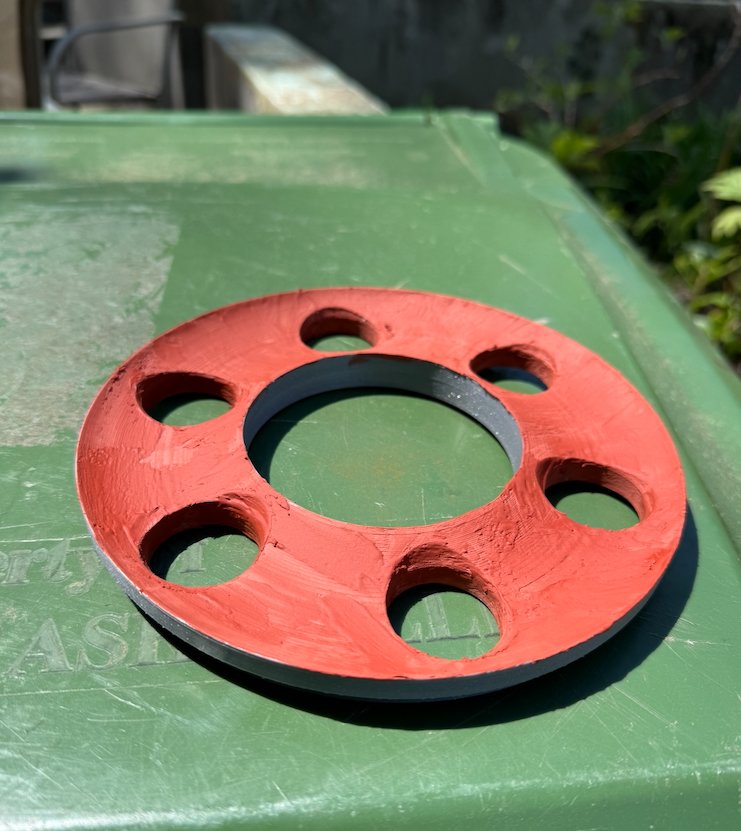

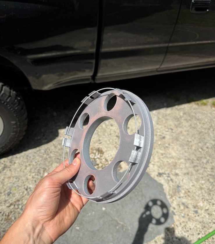

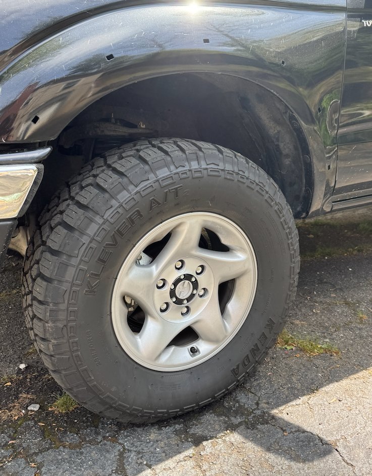

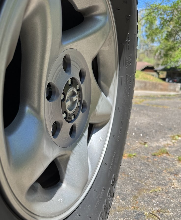

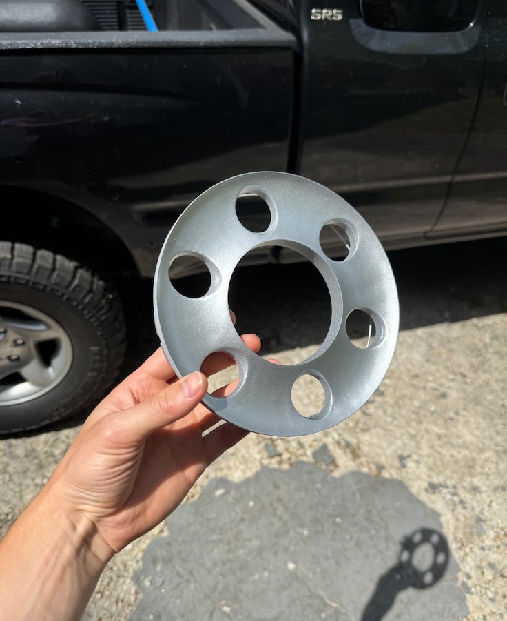

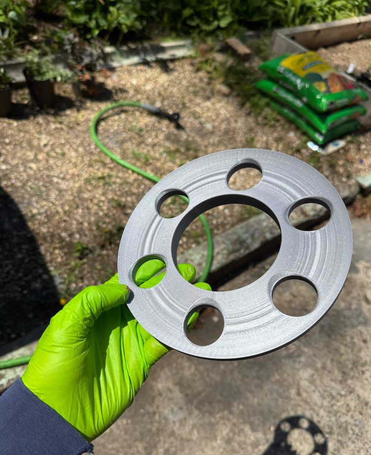

    Ever since getting the lockouts installed I haven't been super happy with the aesthetic of the front wheels without the hub cap. After doing some research on OEM stuff, Toyota did offer an alternative hub cap with the cutout for the lockout on some of the earlier year stock wheels, but by the time the starfish wheels were offered as a "premium" 16" option, manual locking hubs were no longer a factory option (as far as I can tell), so it wouldn't make sense for Toyota to produce them. That left me SOL for finding a premade option.
    I started a side quest of designing and 3D printing my own caps, and just finished them up today. They aren't perfect, but I'm really happy with how they came out. Started with a silver PLA filament and dialed in the contours and dimensions of the main face plate, then did some measurements on the old hub cab to get the retaining clips as close as I could. To get a clean finish, I used bondo spot glazing putty and sanded smooth before primer+paint+clear. I printed the clips and face plate separately, then super glued them on, and used the internal metal ring from the old caps. To my surprise, they actually fit really well (a bit snug, but I'd rather that than too loose). I don't think I've seen someone else come up with a solution for this style OEM wheel, but curious to know if I missed anything. I'd be happy to post the STLs if there is any interest.

    I am pretty sure I have some OEM if you want them, but those look great!

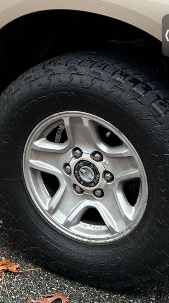

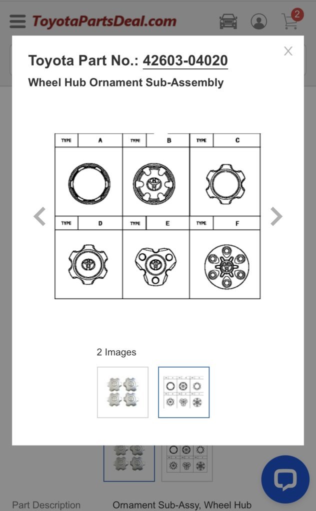

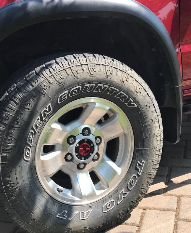

    Really? I’m curious what they look like! All the diagrams I’ve seen haven’t had the star center cap with the lockout cutout. But given I already printed these I guess I’m all set haha. It seems like Type A & C in this diagram would be the only ones to work with the lockouts, with the starfish cap being type F here

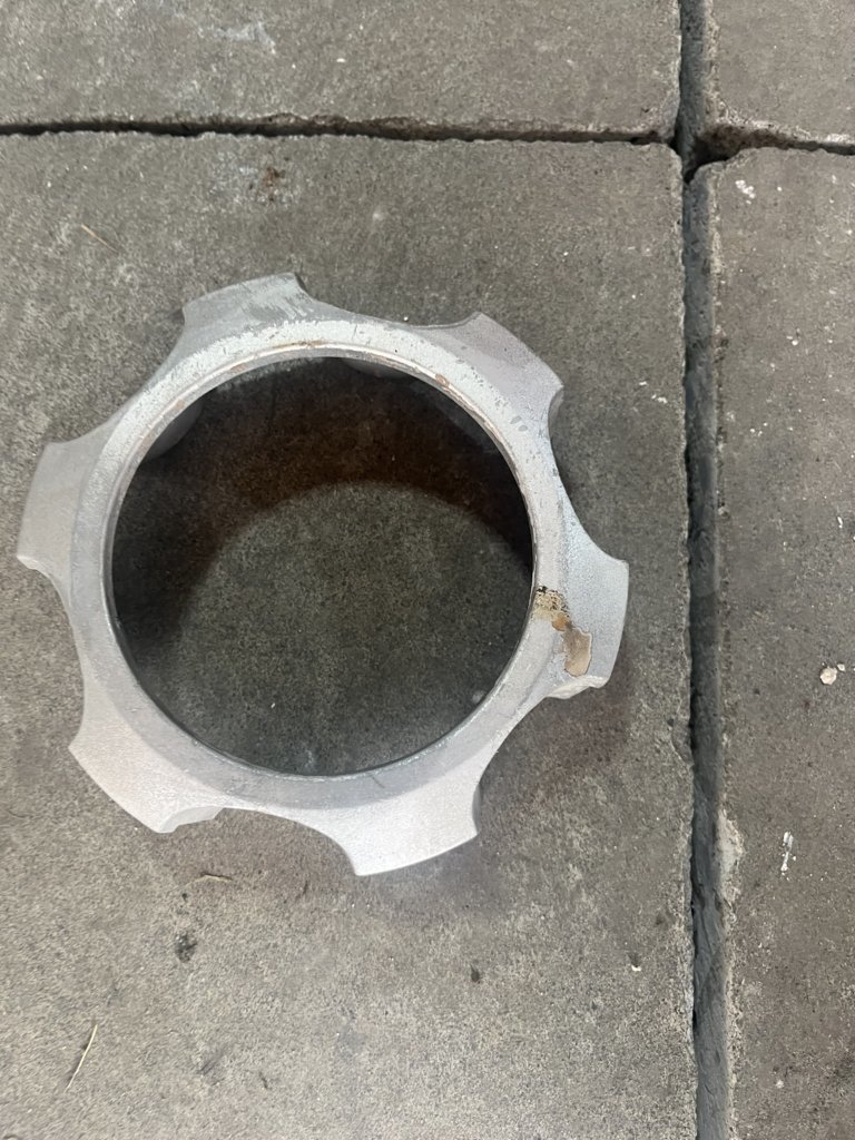

    I will dig them out and get a pic for you.

    Ah ok sweet, but yeah that style would only work with some of the earlier wheels Toyota offered like the ones below. Unfortunately on the star wheels the entire lug nut is inside the center cap area vs. split in half like this style, so it's a significantly larger cap. Thanks for digging it out though, I know those are a bit difficult to source these days.

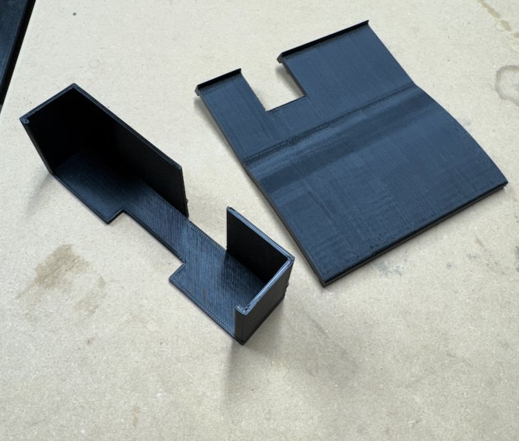

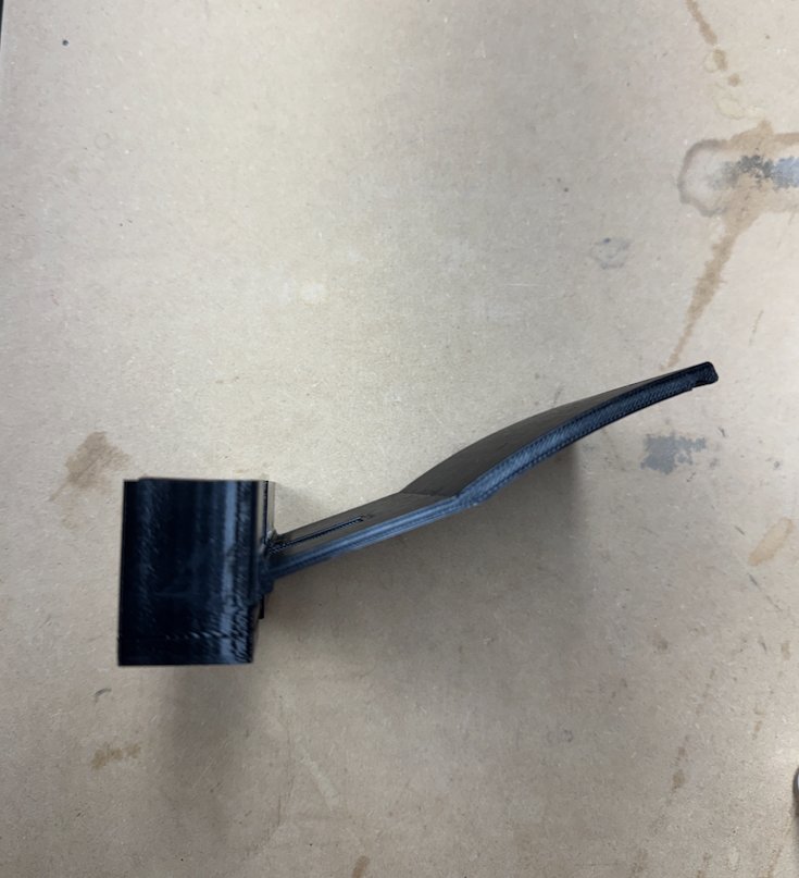

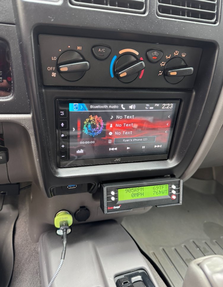

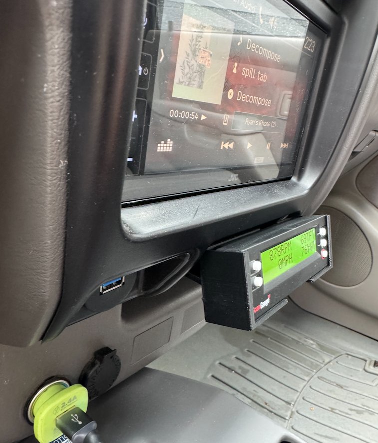

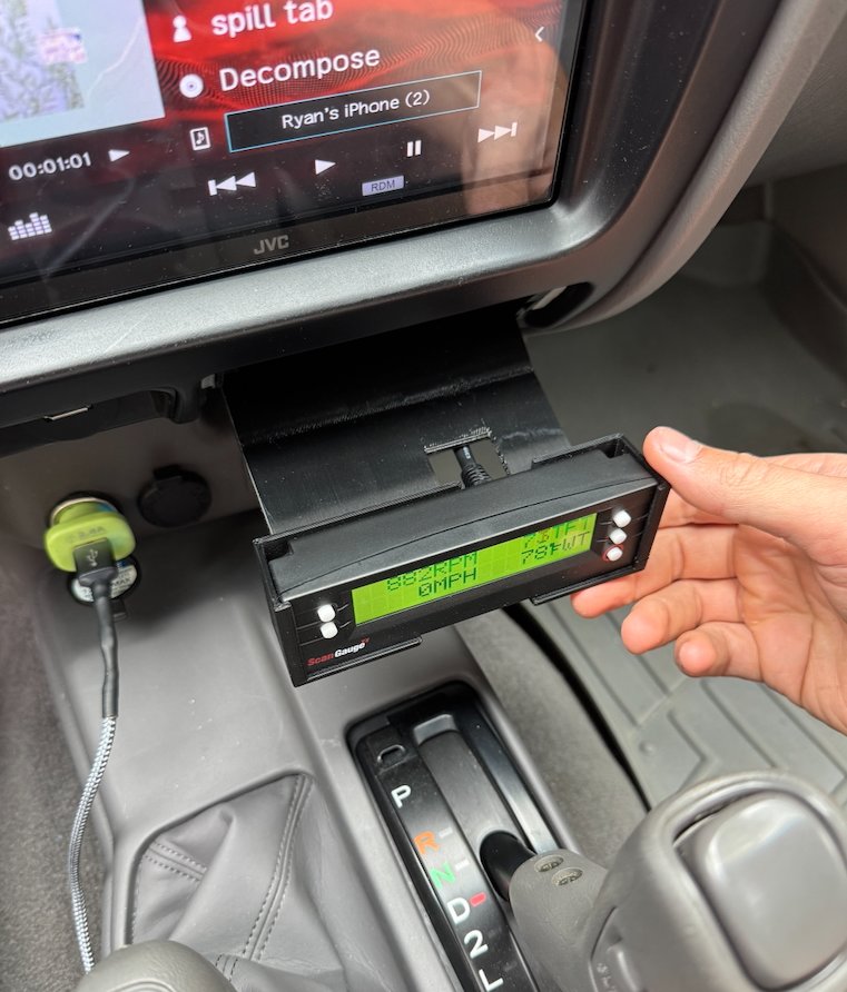

    Picked up a ScanGauge II which has been very helpful for keeping an eye on things especially my transmission temp as I'm breaking in the A340F. There's lots of info out there on mounting solutions, but I came across this one, and figured I could pretty easily design and print one myself. I completed it today, and it actually works great. I mirrored the shape and cutouts on the stock ash tray, so now this thing basically clicks into place like the tray does (the etsy version seems to just be a flat piece?). Anyway, I'll probably get around to posting the STL files for this as well as my hub caps. I like how you can route the OBD II cables right behind the ashtray and out the back, makes for a really clean solution that's not right in your face.
