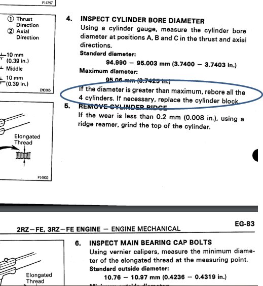

    Looks like maybe they can be bored. This is from the 96 manual I have:

    Oh you can bore them. But not too much.
