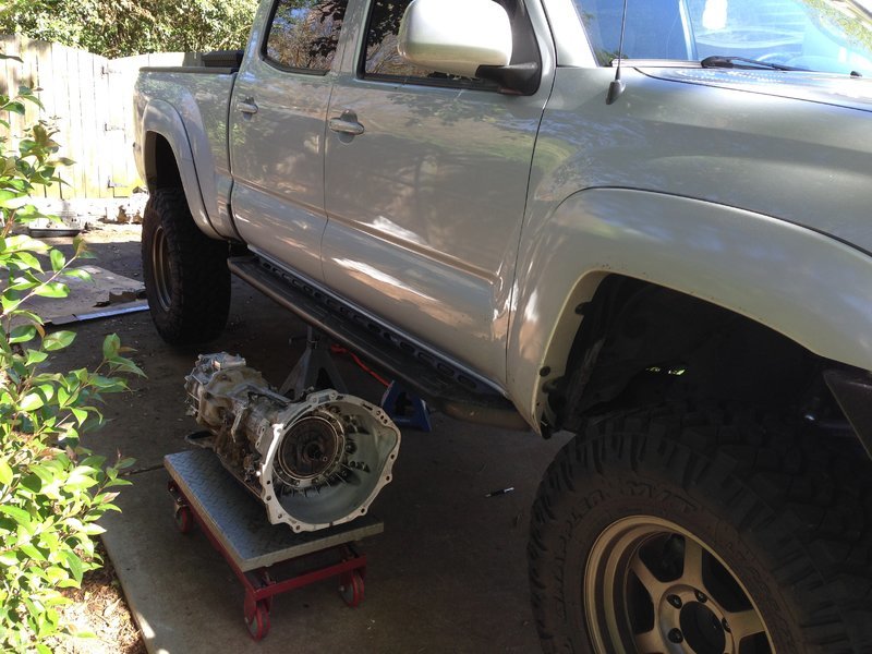

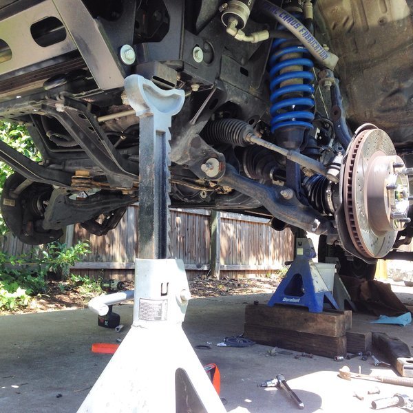

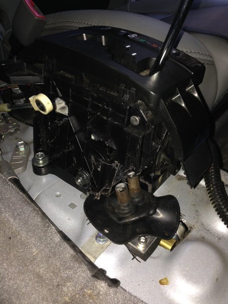

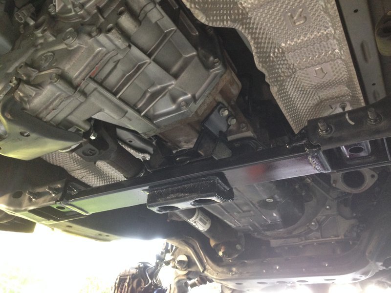

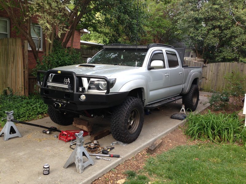

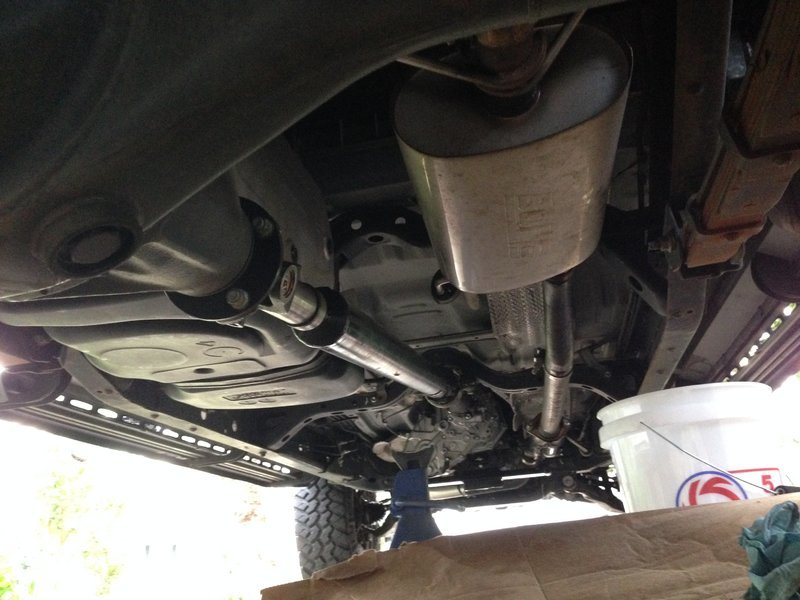

    Lots of progress on my peerunner, almost ready to drive again

    A conversion? How tough was it on install and finances? The thought of doing that has crossed my mind more than once.
  12. Apr 22, 2016 at 4:54 PM
    #2352
    ajohnson
    ajohnson Glamour Shot
    Apr 19, 2009
    #16145
    8,496
    Andy
    Charlotte, NC
    07 DCLB TRD Sport Prerunner 4x4
    Things and stuff and such
    Hardest part was swapping the transmission by myself. I spent about $2k for everything needed, collecting parts for two years.

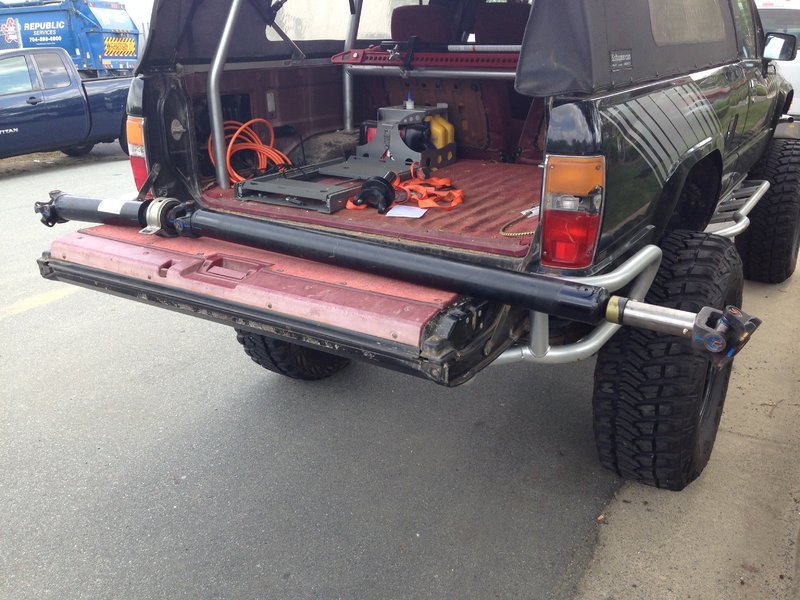

    I've been DD'ing the crawler for the last three weeks while I worked on the conversion.

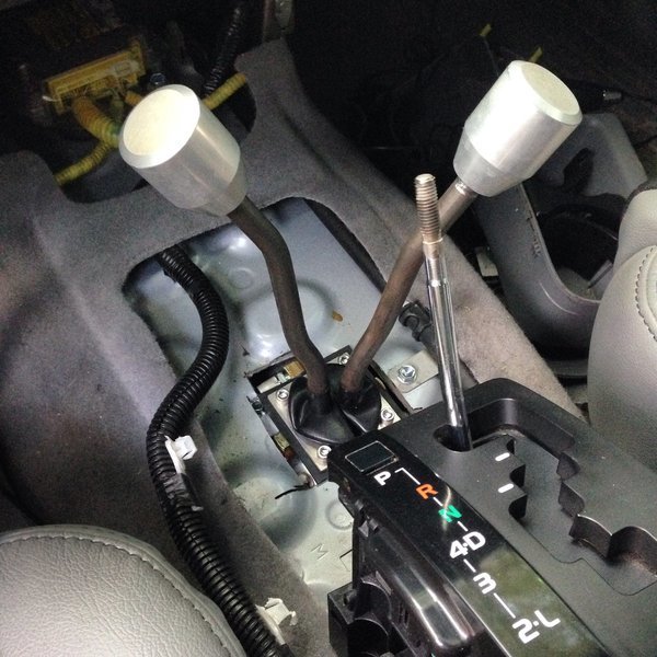

    I only have 64k on this '07. I got lucky with the parts, bought most of them from friends. Most people end up spending $3500-4500. I also put 4.56 gears in the front diff and twin sticks in the FJ case (didn't include those with the $2k). I still need to fab the shifters to go around the auto shifter.

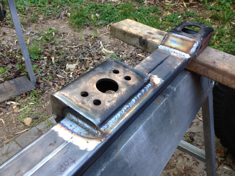

    If you want to build another one of those cross members and make some $$$ then let me know. I'm in the process of getting parts to swap mine, and that's one of the few things I lack and really don't want to have to build. How're you operating the add though?

    I don't really feel like making another one :laugh:, I used the ends and center of a 4x4 crossmember, it's different from the prerunner. You will need the transmission mount too.
    The ADD is wired to a SPDT switch mounted in the dash. It's easy to wire but I bought the RST harness to save some time.
