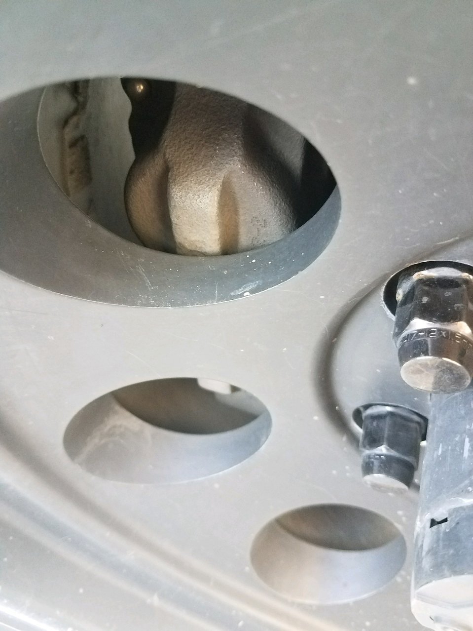

    Prerunner sr5 here, spoke with a sales rep for 4wheelparts.com about pro comp 16x8 rims he claims there is clearance issues with the brake calipers. Can someone confirm or refute that claim. If true would 17x9 rims fit a stock suspension prerunner platform? Lift is not desired. TIA

    What's the backspacing on the rims? It seems that would be the issue. 16x8 is a pretty common size

    I've got the Pro-Comp 7069 which are 16x8 w/ 4.75 back spacing. They are pretty close to the brake caliper but no issues.
    EDIT: its a 4" back spacing

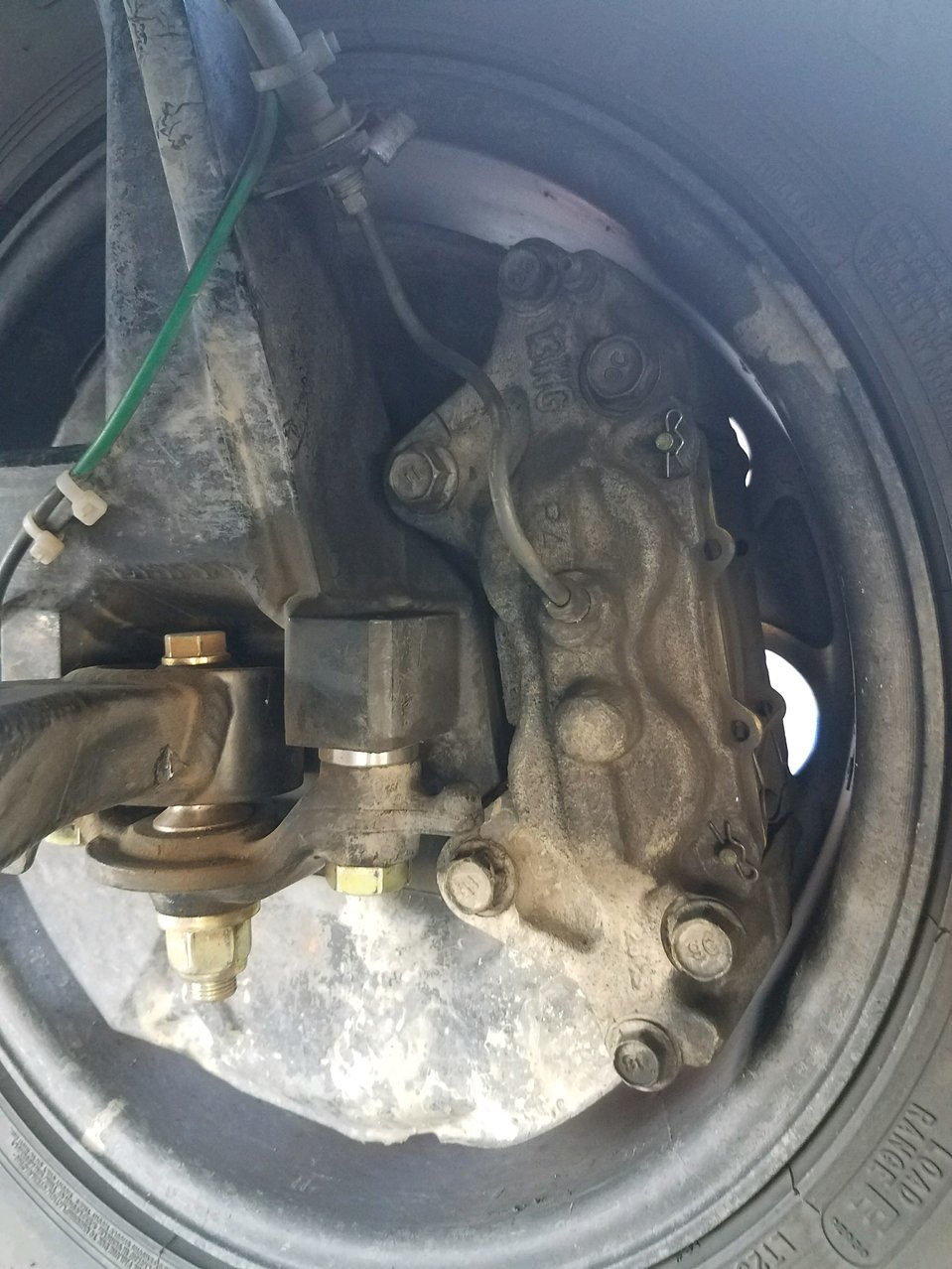

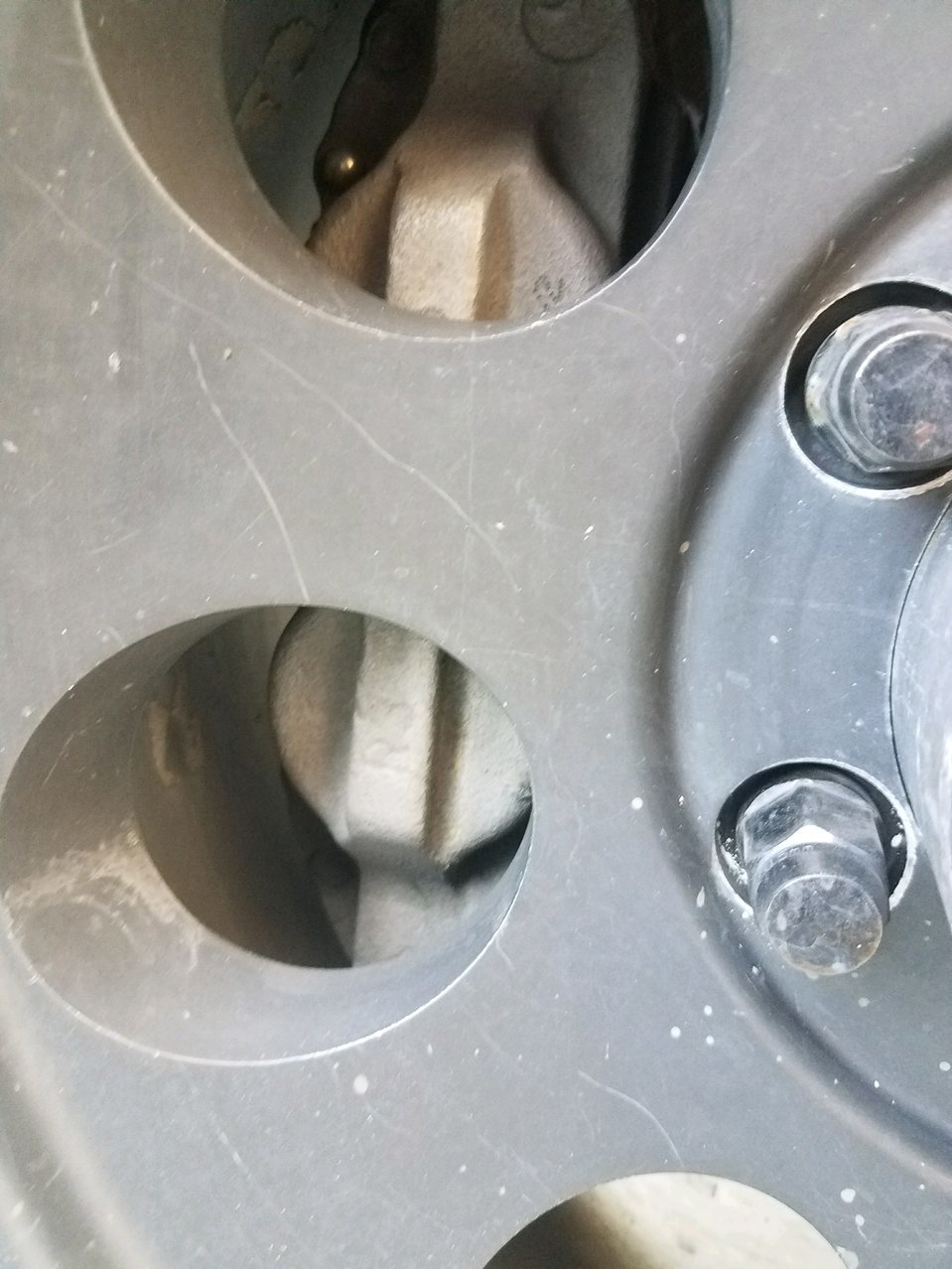

    Maggot that is exactly the style and size I initially chose 4" back spacing and -12 offset. Another member lifted, albeit, stated the same as sales rep. Member stated after fitment he had about 1/16 clearance from the calipers.

    ll be honest, it's close and had me worried at first so i threw on some spacers. Took the spacer off after about week and took my chances and I've had no issues at all. FYI, i run my truck pretty hard too.
    Here's some pics;
