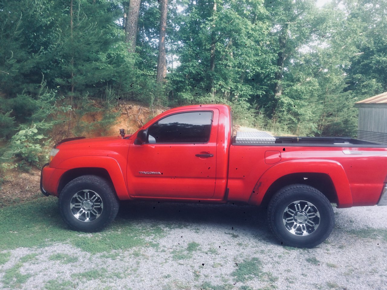

    Take some pics of the leaf pack and underneath it out back, and then of top of the coilovers up front, and we should be able to tell you if its stock height or lifted

    Kk will do first thing tomorrow and I appreciate it man my tires rub a little in the front and toyota replaced all the leafs in the back so I’m curious if the tires and new leafs might be what’s got it sitting a little higher . It’s ab 10 at night here so I’ll go out in the am and take pics and update thread

    Sounds good. No prob. You can also get a measurement from the center of the hubs to the bottom of the fender flares and that is another way to tell if its lifted. Stock height trucks are typically 20” from center of hub to flare in the front and 22” in the back
    (Give or take a half inch on the driver side for the taco lean)

    That’s what I needed to kno I’ll still take pics in the am . I’m guessing my truck needs to be on a paved level surface to get accurate measurement ?

    Yes level for sure, paved surface would be the easiest way to make sure its all level. Typically the drivers side reads a half inch less in ride height than the passenger. Both of my tacos have the lean

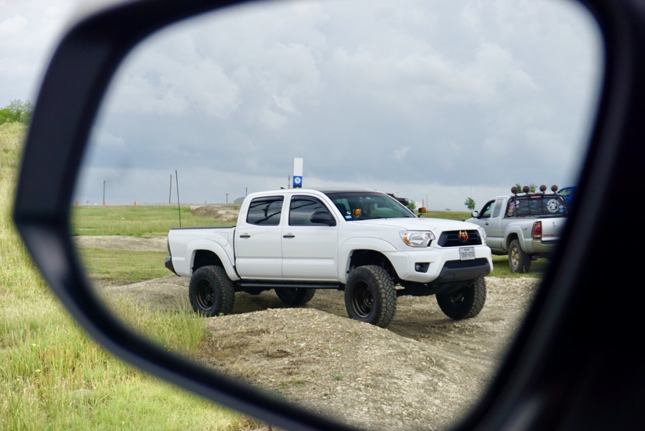

    PreRan the offroad track at COTA before the crew hit it

    Don't get them F5s dirty.
