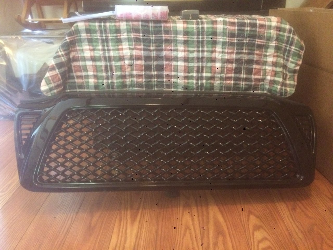

    Yea that’s not bad I’ll def have to save up but a lot cheaper then I was expecting when it’s all said and done I’ll post pics lol just
    GOt this in their mail still waiting on headlights to match . So lift will probably be my next purchase

    Nice! Gonna look great!
