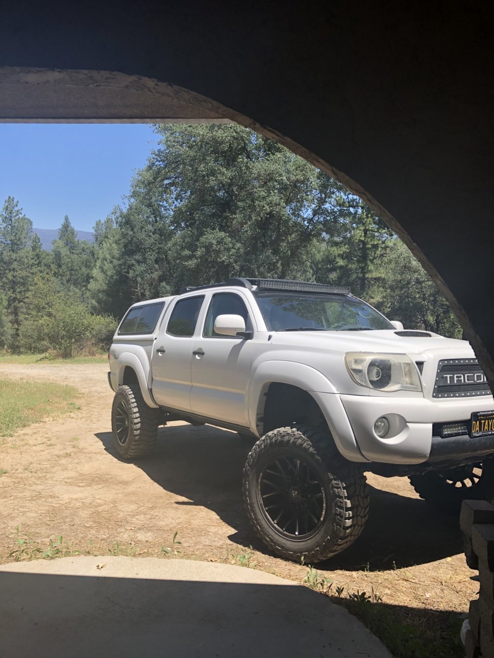

    2006 TRD Off Road prerunner
  13. Jul 22, 2019 at 3:30 PM
    #6653
    05prerun82
    05prerun82 Your local friendly Taco Mule TTC#0202
    Aug 11, 2018
    #262485
    19,804
    Brandon
    Fredericksburg
    2006 aclb prerun
    Memphis sound system volant cold air intake
    Damn he lifted and got big tires
