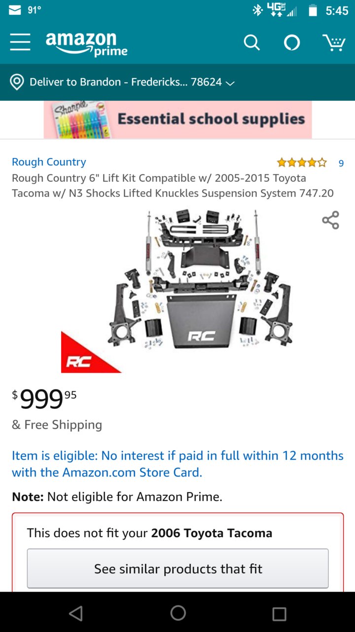

    Screenshot_20190723-174528.jpg For example rough country makes a 4 and 6 inch bracket lift it's a full kit comes with shocks and everything you need perfect for Mall crawlers and it's under a thousand bucks

    I wouldn't recommend it but if you're never going to take your taco off roading and you're just going to park it at the mall it's probably a perfect kit

    @knightofzero - don't do that ^
    There's no reason to on a PreRunner since it doesn't have a differential that needs dropping "drop bracket lift" - you have to cut the frame with those. Totally not practical for a PreRunner
