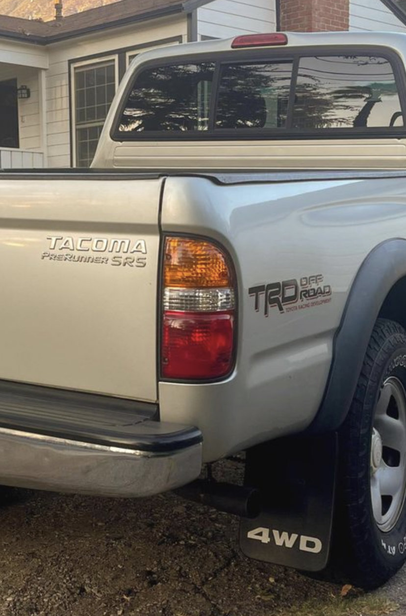

    Hi - I have a 2003 Tacoma SR5 with 4x4 that has a pre runner badge on the tailgate and I cannot figure out why. I am the second owner so I don’t know the trucks entire history, and would appreciate your insight - or best guesses! Thanks!

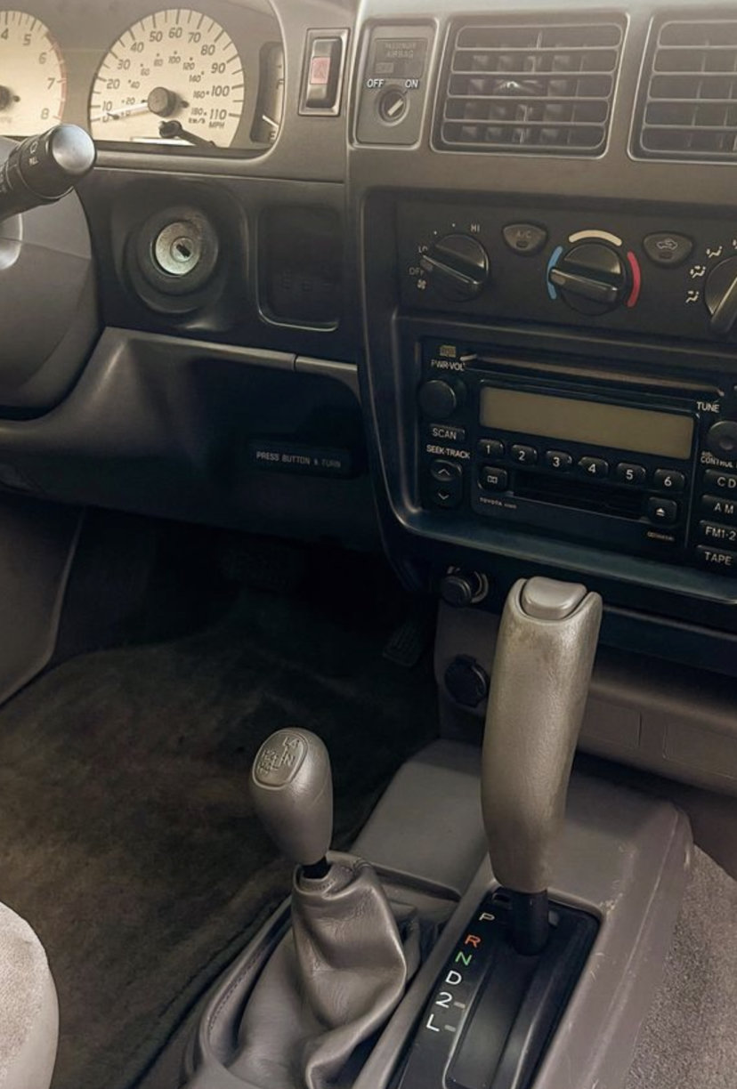

    following, that looks like a 2 wheel drive truck with 4 wheel drive mudflaps. What's the interior show?

    The interior shows me that it is a 4x4.

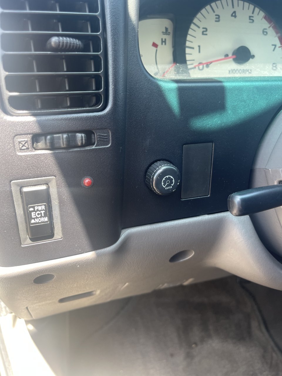

    @ellejay Do you have rear lockers? There's a button on the left side of the steering wheel that says RR DIff Lock.

    There is no button.

    Interesting. That black cover next to the dimming knob is where the RR DIFF LOCK button should be. Tacoma TRD's should have came with that option, at least my truck came with that option. Maybe someone else can chime in.

    You do realize badging and/or stickers can easily be added or removed?
    Maybe the previous owner did it him/herself.
    Maybe there was an insurance claim, and the company accidently added said badging.
    Maybe someone stole the tailgate, and it was replaced from a Prerunner.
    Lots of different reasons. But to ask something like that on such an old truck can net many different possibilities that many of us will never know.

    The previous owner has obviously done some swapping or badge installing. A factory TRD truck would have a diff lock, and a button in the blank spot next to the dimmer.

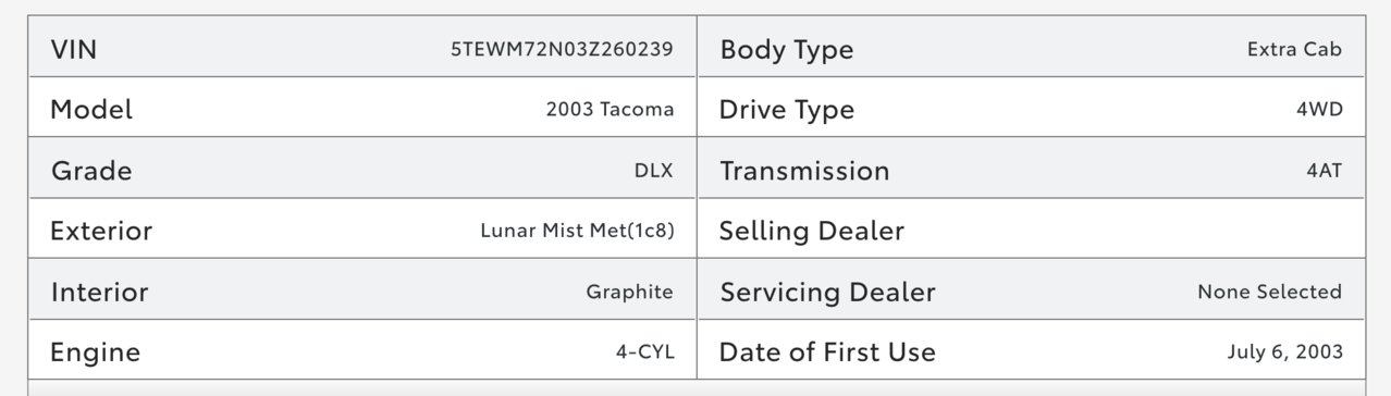

    Thanks for the tip. Here's what I got when entering my VIN at Toyota.

  18. Sep 6, 2022 at 9:43 AM
    #18
    bonifacio_629
    bonifacio_629 Well-Known Member
    Oct 20, 2018
    #270049
    544
    Walther
    Virginia
    2018 Tacoma TRD Sport, 6MT 4x4 DCSB, Inferno
    Predator steps, TRD cat-back, lots of orange stickers.
    Not all TRD-package trucks came with locking rear diff. I've seen other TRD trucks that didn't have it. My guess is the Prerunner tailgate was swapped from an actual Prerunner. A giveaway for legit TRD-or-not is whether you have orange backlit interior lights... non-TRD trucks I'm pretty sure were green.
  19. Sep 6, 2022 at 9:47 AM
    #19
    bonifacio_629
    Oct 20, 2018
    #270049
    544
    Walther
    Virginia
    Wait, you have white gauges. Yet another indicator that it's a real TRD-package truck.

    Previous owner may have had to replace the tailgate and just got one from a Prerunner without removing the emblem
    Although I don't recall the Prerunners having "Prerunner SR5" on the tailgate....I though it was Prerunner V6 or just Prerunner (for the 4cyl)
    4x4s simply had SR5 on them (under the Tacoma emblem).
    So it might (probably) just be that the PO wanted to put a Prerunner emblem on it for whatever reason. People do weird stuff like that all the time
