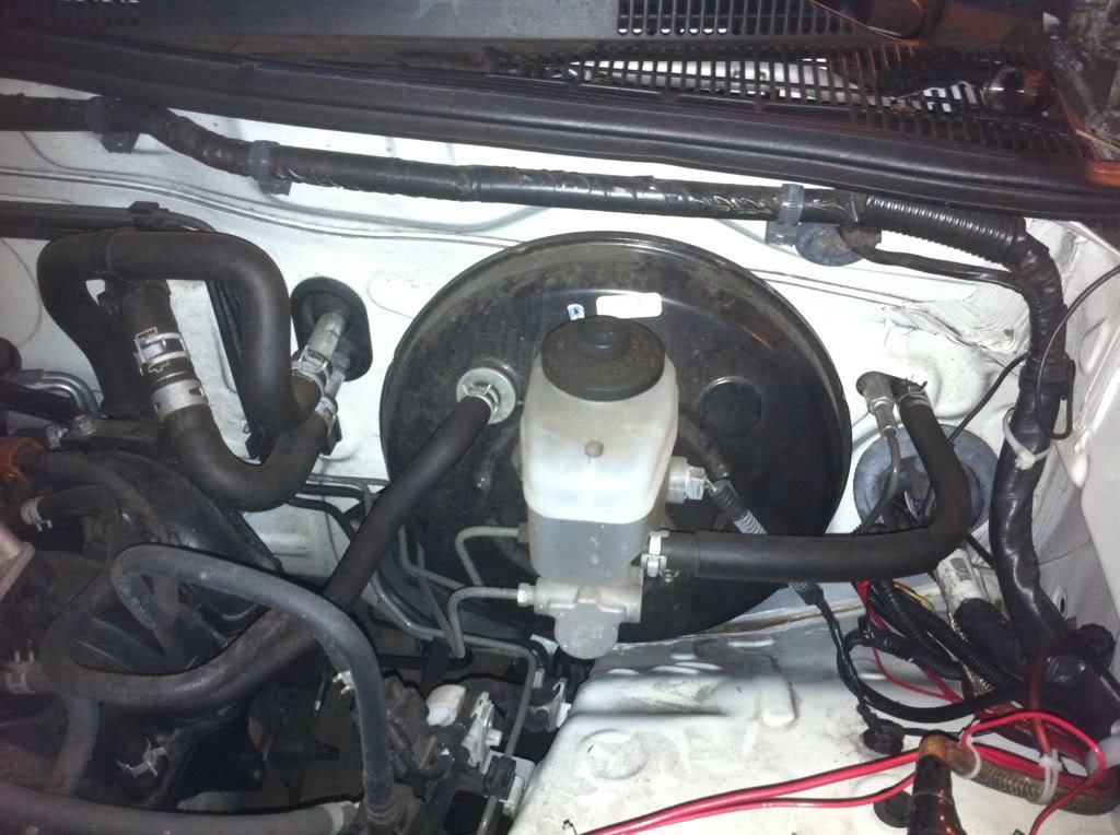

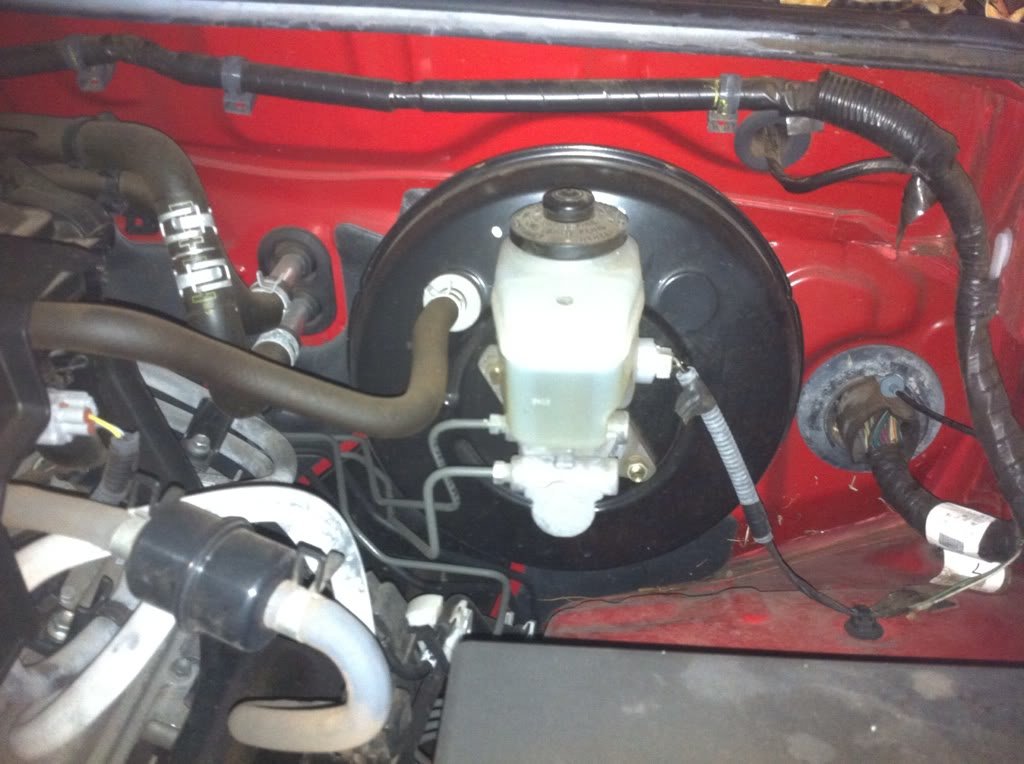

    the master cylinders on the 2nd gens are pretty massive. and i'm pretty sure they are the same size (see below) it's been already stated on XRU and such that there is no real need for an upgrade master cyinder with the TRD BBK or even larger BBKs (one guy i remember was running a 355mm bbk stoptech kit and the master cyl was enough stock)
    my truck:
    My dad's truck (V6 DCLB PreRunner)
