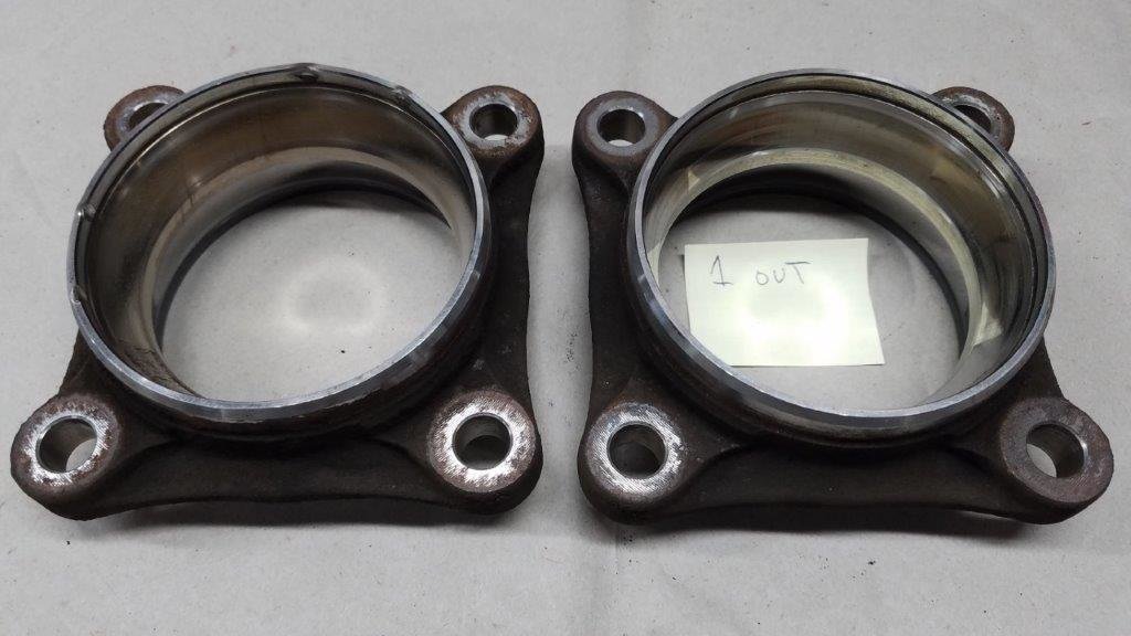

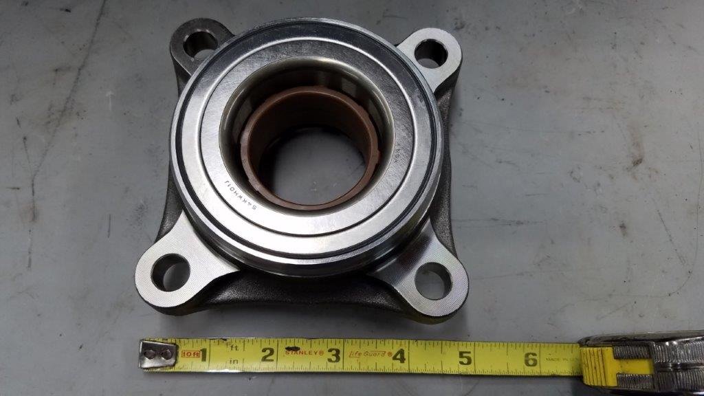

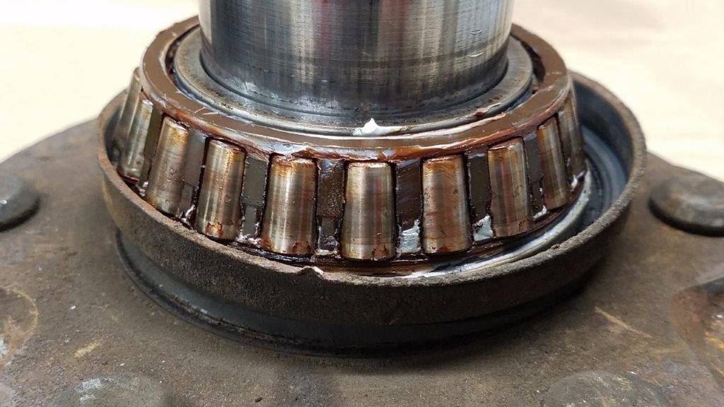

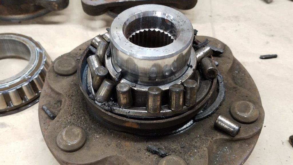

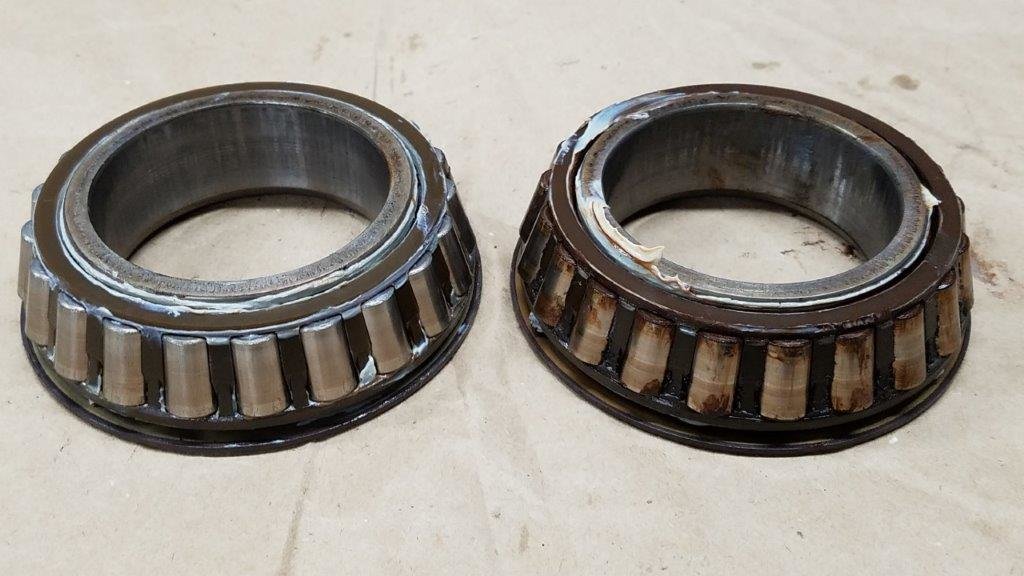

    There are two sealed tapered bearings mounted face to face in each front assembly. The outer side of each bearing is sealed and the insides are open so they can technically share grease with each other.
    The one below has just started to go bad. Only occasional noise when driving and was quiet when rotating it even with the pads removed.
    Housing / race below. One per wheel.
    Good LH and bad RH bearing that were pressed off the hub. The one on the RH was the mating bearing with the first pic
    The one below sounded like gravel. Not my truck. Lucky this didn't fail catastrophically
    Edit:
    New Toyota bearing assy. Basically one bearing drops in each side and it's held together by the plastic insert which gets pushed out when the hub is pressed in.
