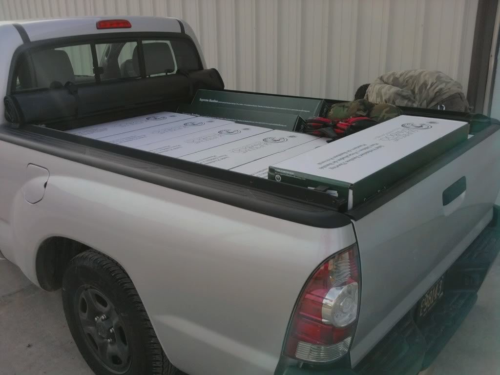

    Regular cab 4 banger FTW.
    1200+ lbs of hardwood flooring (added another 500+ lbs with me and my buddy + a lot of other tools).
