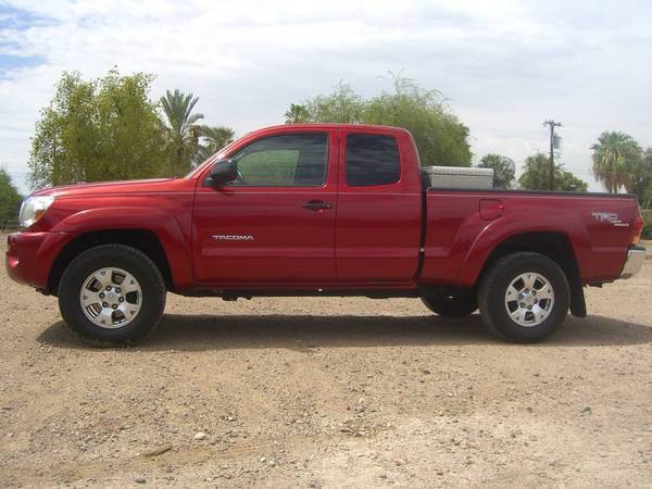

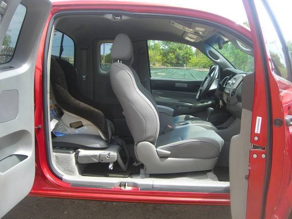

    Pictures!!!

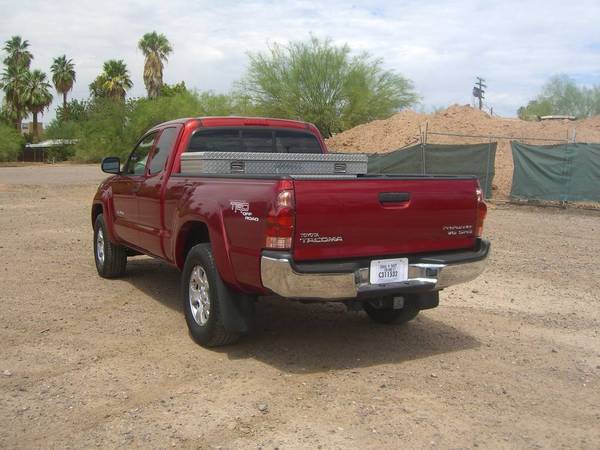

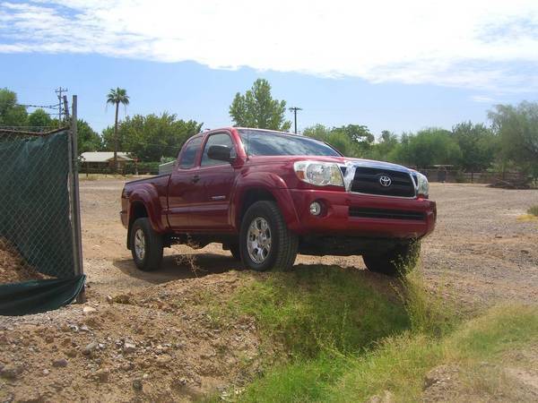

    There is enough room in the access cab for my 3 and half year old son to be in a car seat in the back and my wife still has enough room to sit up front!

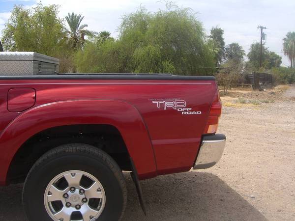

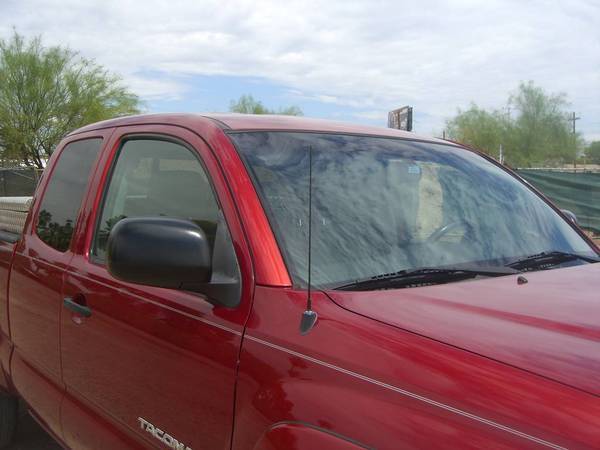

    Shorty antenna.
    Power outlet in bed, should be sufficient to charge batteries for my cordless tools.

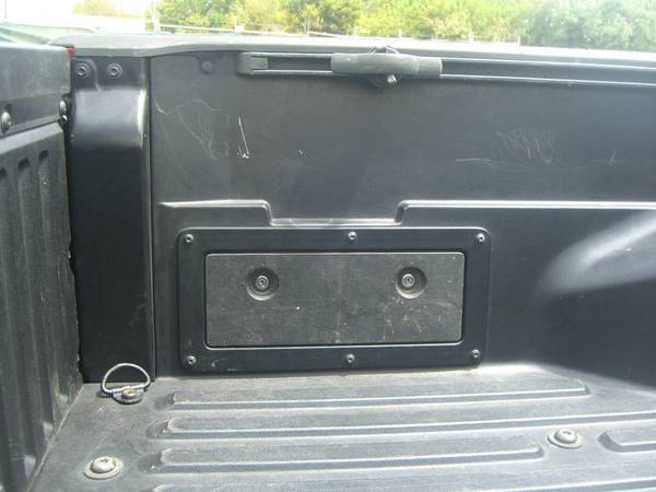

    Lockable bed storage compartment, so my ratcheting tie downs don't disappear.
    Diamond plate toolbox.
    Tried the elocker :D The truck climbed this mound without any tire spin. My 5 lug didnt even go half way and started spinning one rear wheel.

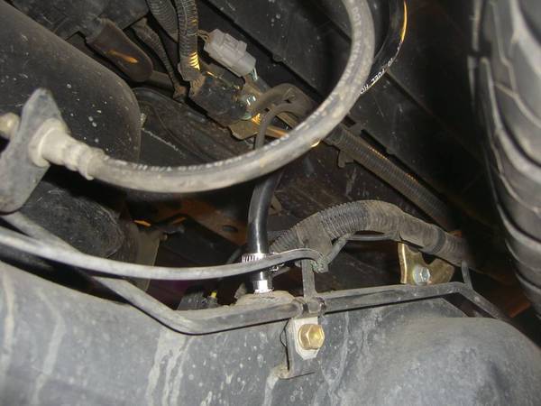

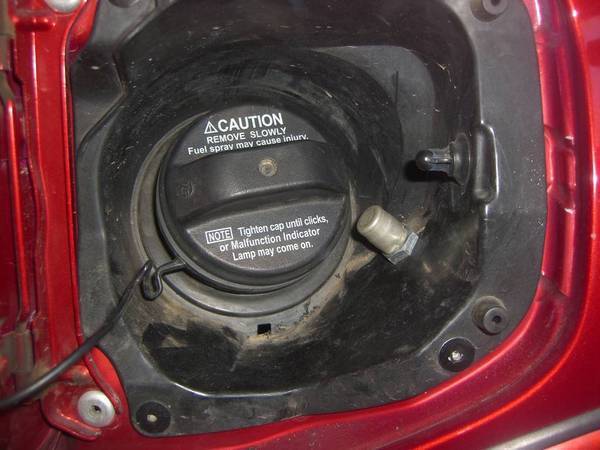

    The first mod! :D

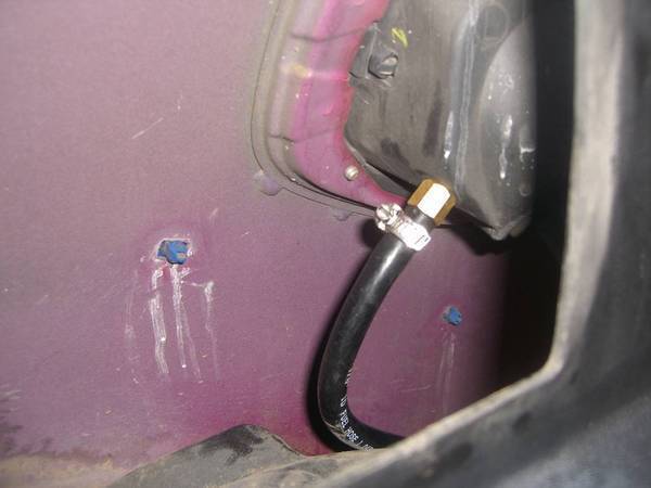

    Relocated the rear diff breather, cost me $20 in parts and will prevent any water from entering my rear diff.
    Parts;
    - Camry union Part #90404-51026
    - 1/8 NPT to 1/4" Barb fitting
    - 5' of 1/4 fuel line
    - 2 screw in clapms
    - 2 zip ties
    - teflon tape
    Breather installed, I re-used the stock piece.
    Barb installed
    Fuel line on barb, clamped
    Camry union installed

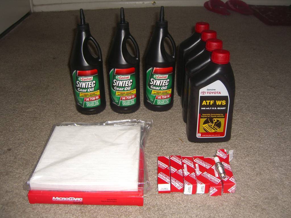

    With 120k miles and used vehicle, the smart thing to do is to change all the fluids, spark plugs and filters. I checked the oil and it is nice goldish color, I confirmed with the dealer and they changed the oil and filter when they took the truck in. It doesn't have OEM Toyota oil filter, but it will be OK until the next oil change. Next oil change I will switch to Castrol Syntec 5w30 and OEM Toyota oil filter. Air filter is little dirty, but OK for now. I am not sure if I will get high performance filter or Intake... There is intake on ebay for $80 shipped very similar to K&N intake LINK --> http://cgi.ebay.com/ebaymotors/05-0...ssories&fits=Model:Tacoma&hash=item4cf9375b00. I assume the only weak part is the filter, which can be easily changed...
    On saturday I am doing;
    - automatic transmission fluid change - using Toyota ATF WS
    - rear differential fluid change - using fully synthetic Castrol Syntec 75W-90
    - spark plug change - using OEM Toyota spark plugs
    - installing in cabin air filter - the truck didnt come with one
    Teaser pic!

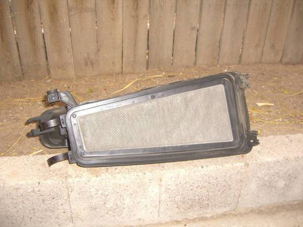

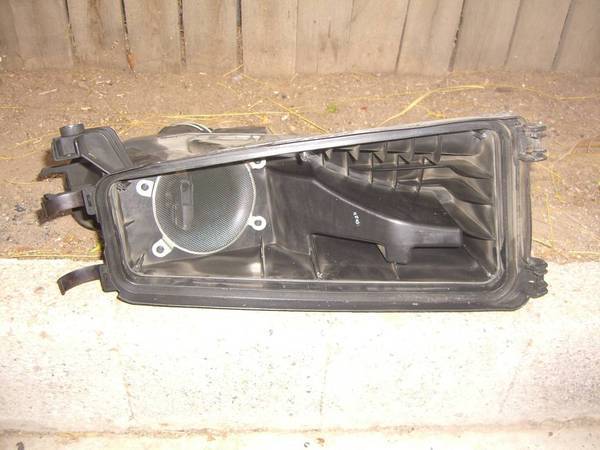

    Since I was already messing with my truck, I took off the charcoal filter as well.
    Intake with charcoal filter;
    Charcoal filter removed.

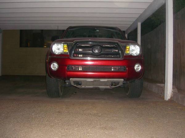

    Picked up used OEM accessory skid plate on craigslist for $50! Couldn't pass this up. Even though its not the toughest skid out there for the light off roading I do it will do just fine. It looks the best out of all the skids available for the Tacoma and closes up the gap between the stock bumper and the OEM skid nicely...

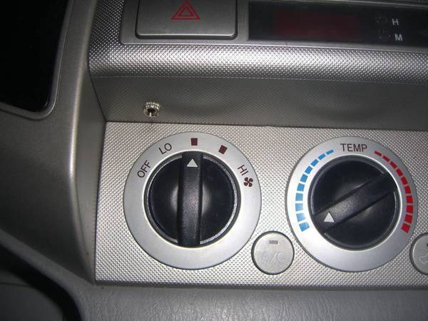

    I also did DIY AUX input. It works great! I found an awesome spot for it, its right above the knob which controls the speed of the HVAC fan. Its hardly noticeable...

    Um... If you used the original diff breather, I don't think that will work, I believe the original diff breather only lets air out, but not in, so I think you will have to replace it with a filter to let air back in so water will not get sucked in through the seals.
    Someone please correct me if I'm wrong.
