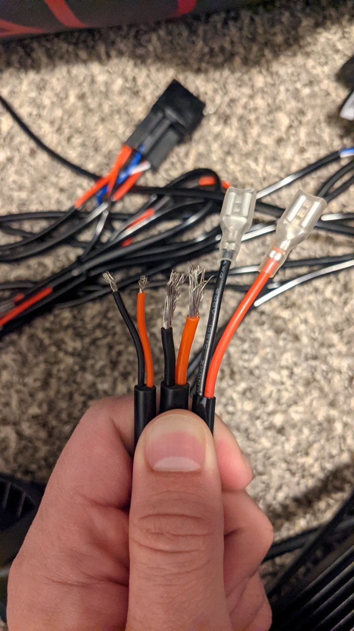

    Any ideas on wiring these up better? The female disconnects are how the switch wiring was done but the wires from the lights don't have anything on them..
    Should I just get male disconnects and call it good or is there a better way I should do this (short of soldering?)

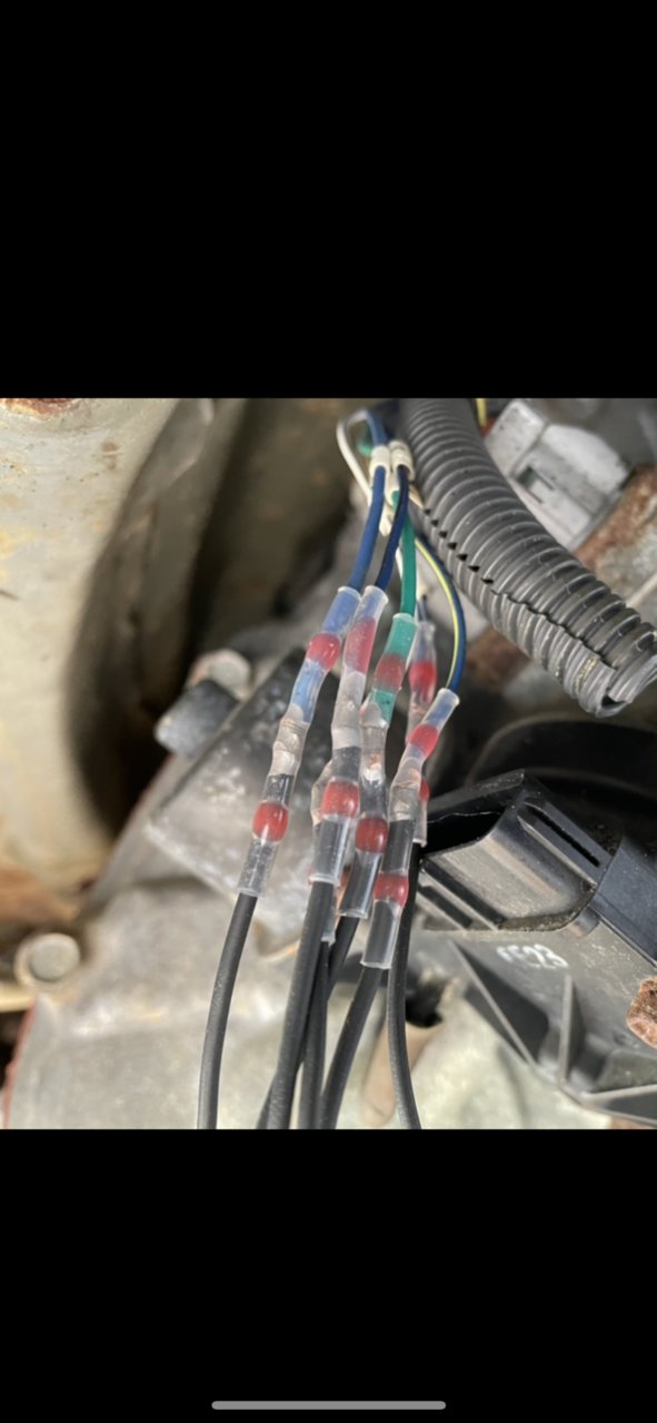

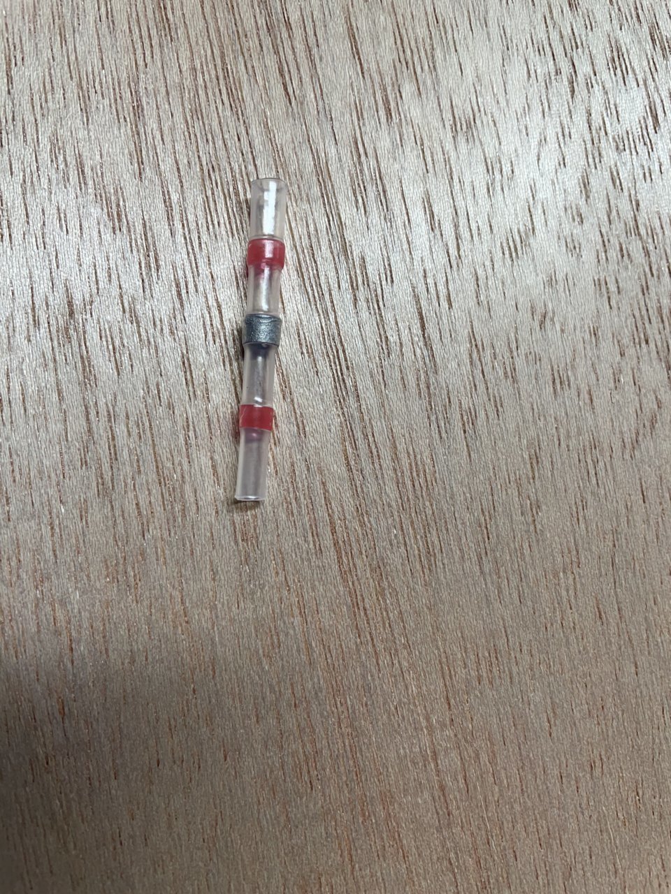

    I’ve used these. They are water tight, strong, permanent connection. They are soldered but idiot pruff. Heat gun and wire strippers all that’s needed to make the connection.

    In action on a Tacoma

    Looks good to me. If I had an extension cord long enough, I'd just solder the damn things but these look like they'll do just as well.

    You do have to use a heat gun. I had mine turned up to the highest setting, 20-30seconds. Make sure you let them cool before moving them around to much. Good luck
