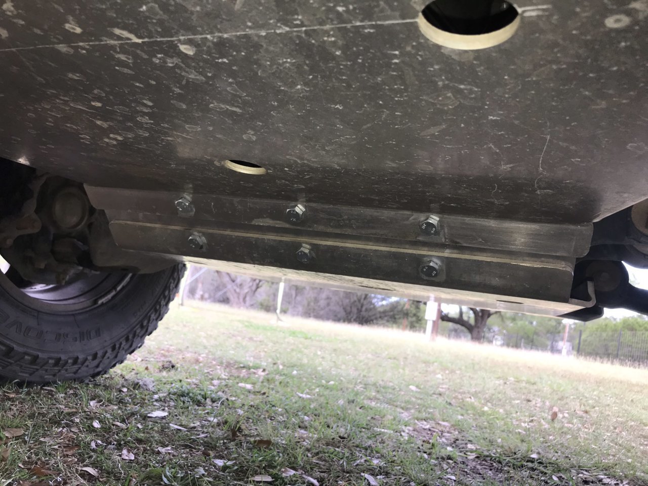

    The front (IFS) skid from most companies will bolt right up. It's the mid/trans and transfer case skids that will cause you issues.
    I have a full set of pelfreybilt skids on my 09 2.7L PreRunner. I had to make an extension to bridge the gap between the front skid and the mid skid- see pic below. Other than this they bolted right up.

    That looks awesome, from what I know though, that company is no longer around unfortunately. I'll have to go with the IFS skid then. I appreciate the help
