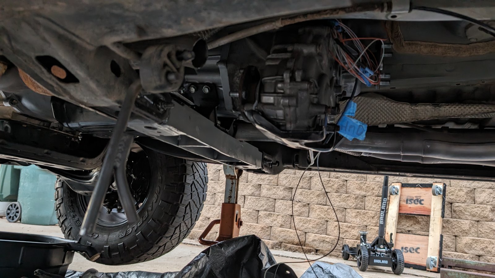

    I'm literally about to finish up the front end this weekend by adding cv axles and I'll be done with my conversion in about a week, while during the week only working on it after work a couple hours. It's heavy stuff, but not that complicated and I did it on my driveway floor by myself except for an extra hand during the transmission swap.PXL_20240118_011002441.MP.jpg

    The actual conversion will take a weekend if you have all of the parts. The hundreds of hours though definitely is spent on researching and purchasing/locating parts lol

    I always laugh when people say stuff like what that guy said. It really only cost me like 3 grand lol and you could probably knock it out in a couple of weekends if you worked on it all day. Almost everything is bolt on. It was well worth it like you said sense i already had alot invested and truck was paid off def made sense. @gotoman1969 look over my build thread. also the above link labeled conversion guide for dummies is really good.
