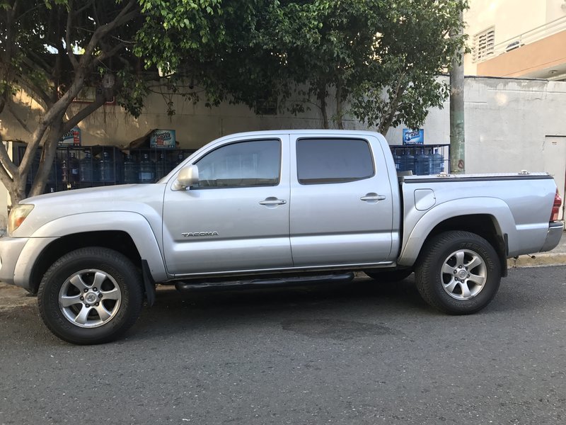

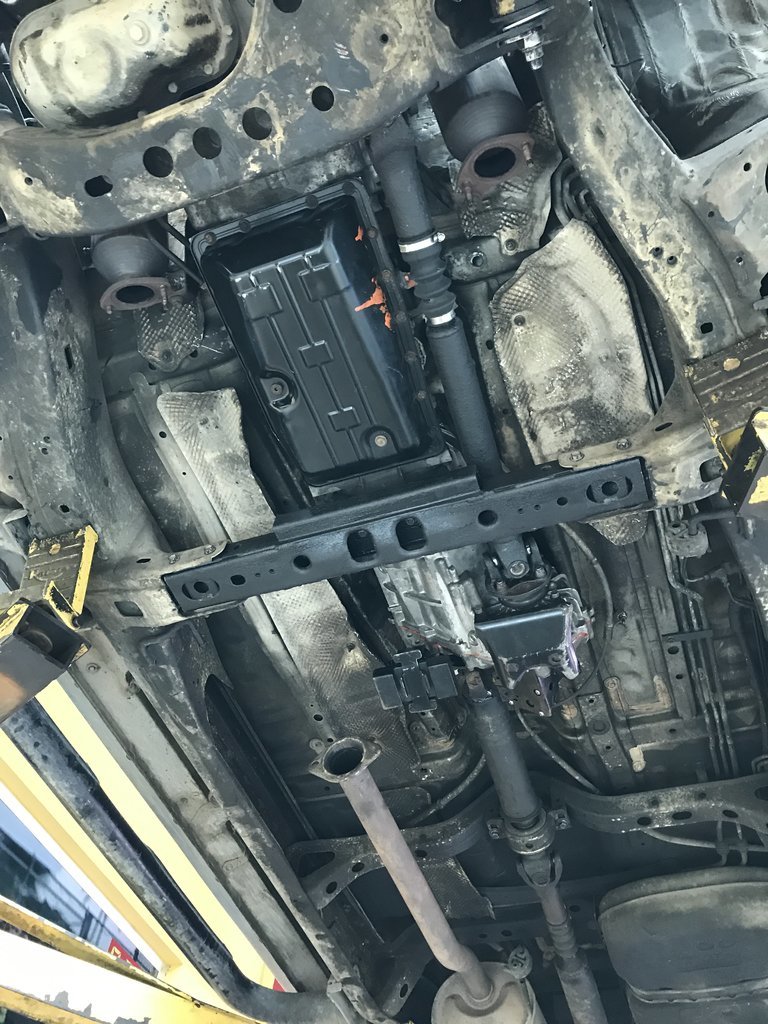

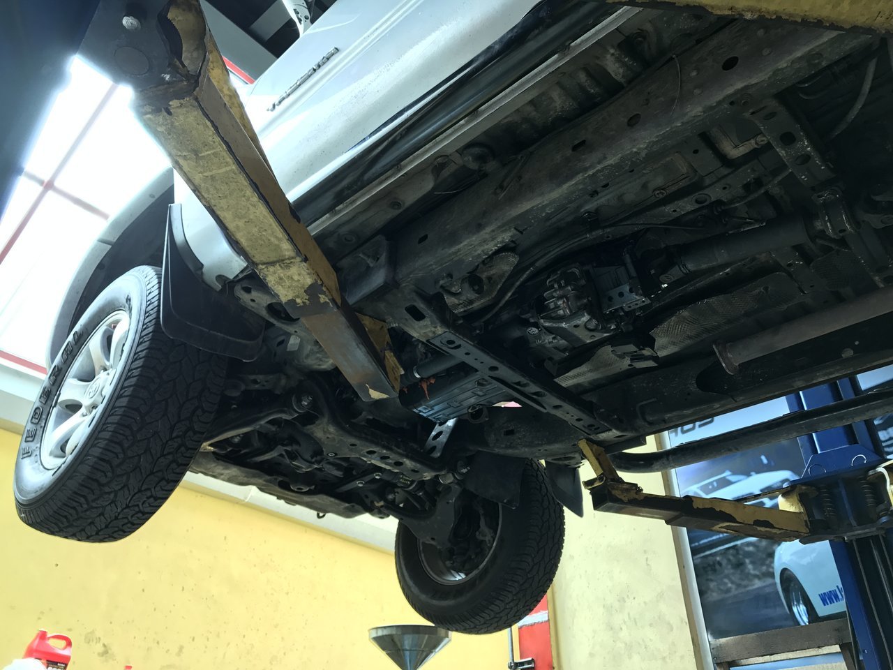

    Bilsteins 5100 set at .085 Rear custom 1" add a leaf 265/70 R17 tires. Custom made aluminum tonneau cover with bike rack. 4x4 conversion with 4Runner transfer case.

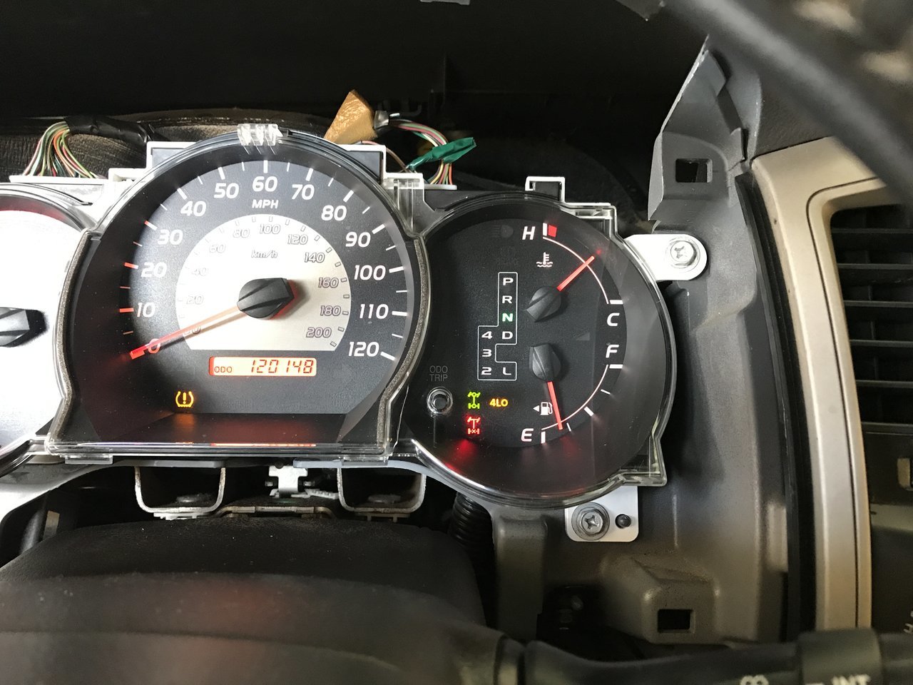

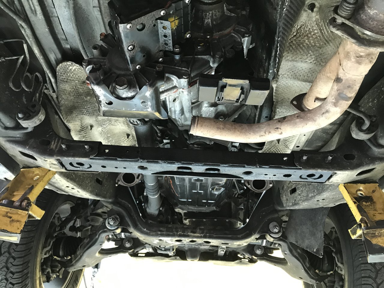

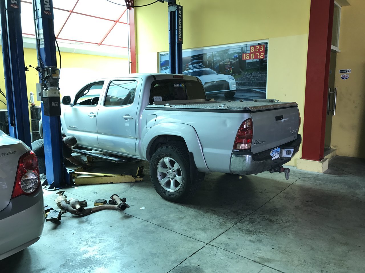

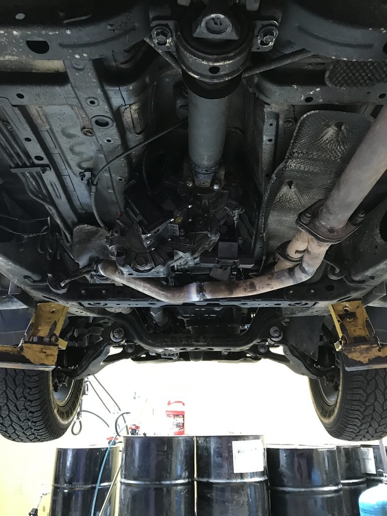

    Conversion is done. Ride around neighborhood, everything working perfectly. feeling great satisfaction right now. Just pending exhaust piping work.

    Next to my job's Nissan Navarra, which has been my ride while Tacoma was out of service.

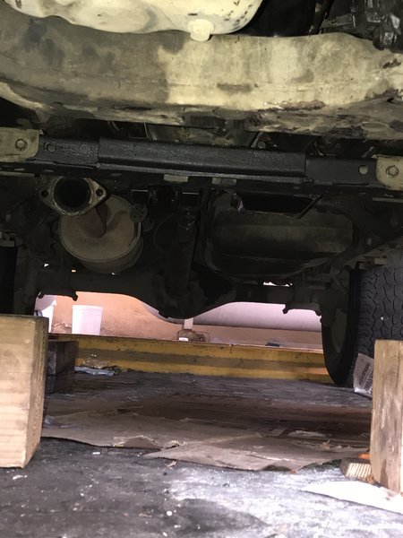

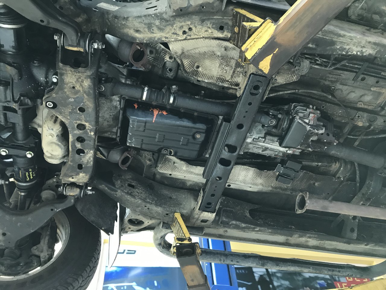

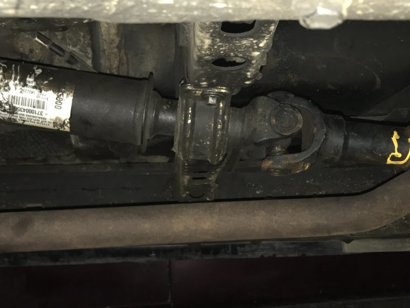

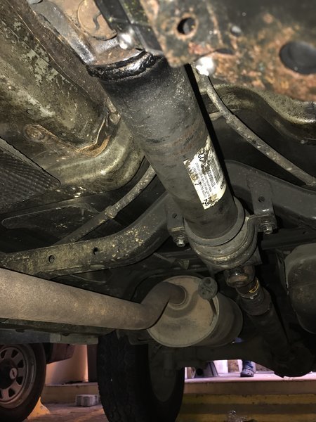

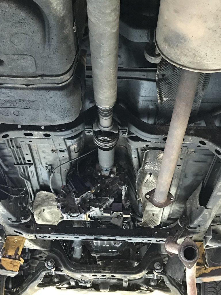

    IMG_0845.jpg IMG_0846.jpg IMG_0847.jpg IMG_0852.jpg IMG_0854.jpg IMG_0839.jpg IMG_0845.jpg IMG_0846.jpg IMG_0847.jpg IMG_0852.jpg IMG_0839.jpg Let's make exhaust pipe work

    IMG_0861.jpg Exhaust done, althought I'm not too happy how it came out,I will modify again to separate pipe more from front shaft. Mean while, this project is considered complete.

    What hasn't been modified?
    I wonder why they dident just route it behind the tcase.
    But congrats on the project!!! It's defiantly nice to have 4x with center locker!! :cheers::goingcrazy:

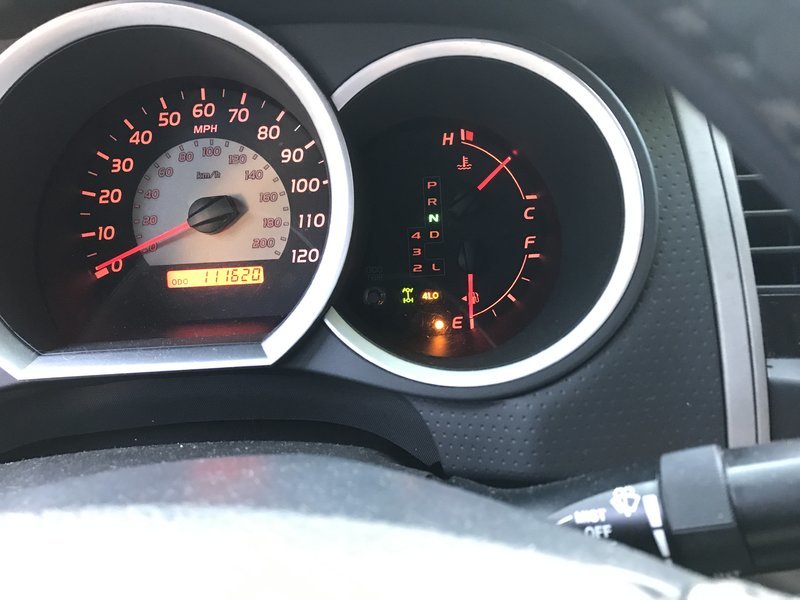

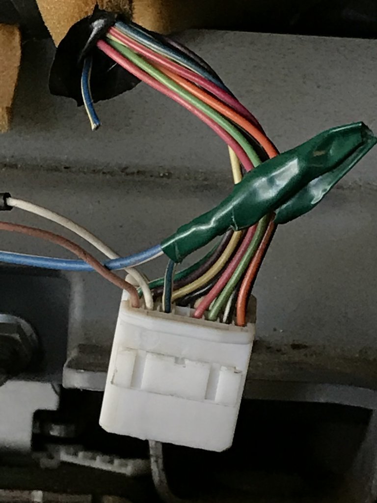

    Today I build a connection to use rear differential lock light to show status of my center differential lock, having a rear mechanical lsd I didn't have a use for that light.

    After watching the video below, I believe this is what is happening in your clip above:
    The first and second movement are:
    2WD to 4WD Locked to AWD
    The third and fourth movement are:
    Hi/Lo
    Is this correct?

    Exactly as you describe
