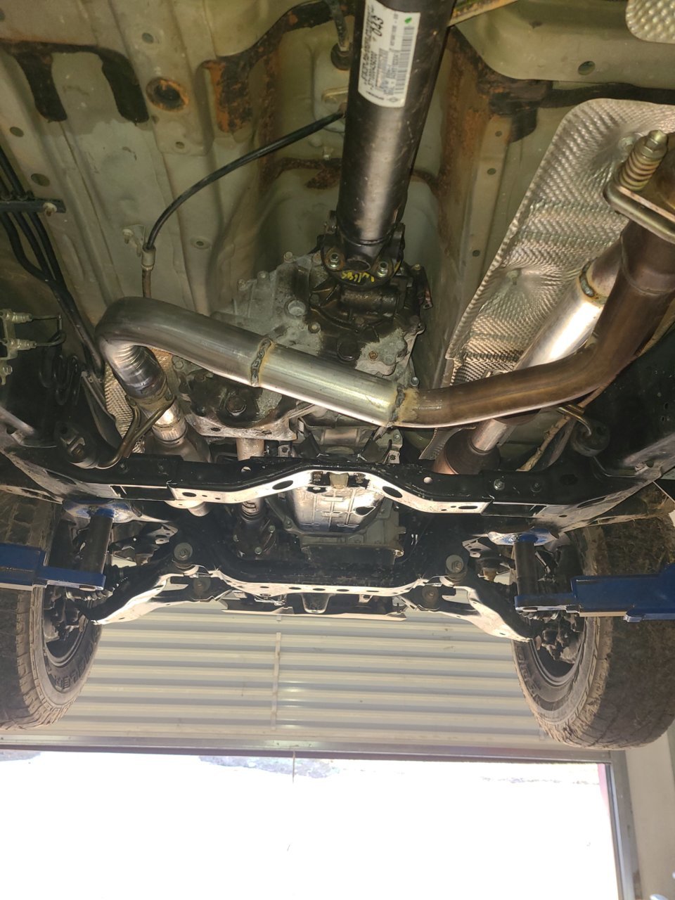

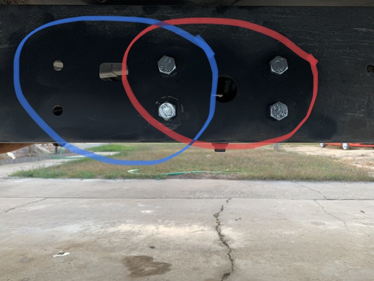

    so I'm going to use a 4x4 driveshaft how do you adjust the crossmember for the carrier bearing?

    For the DCLB I just drilled the rivets and moved the cross member back to an existing set of holes and bolted it in

    i saw that post already but mine doesnt have anymore holes

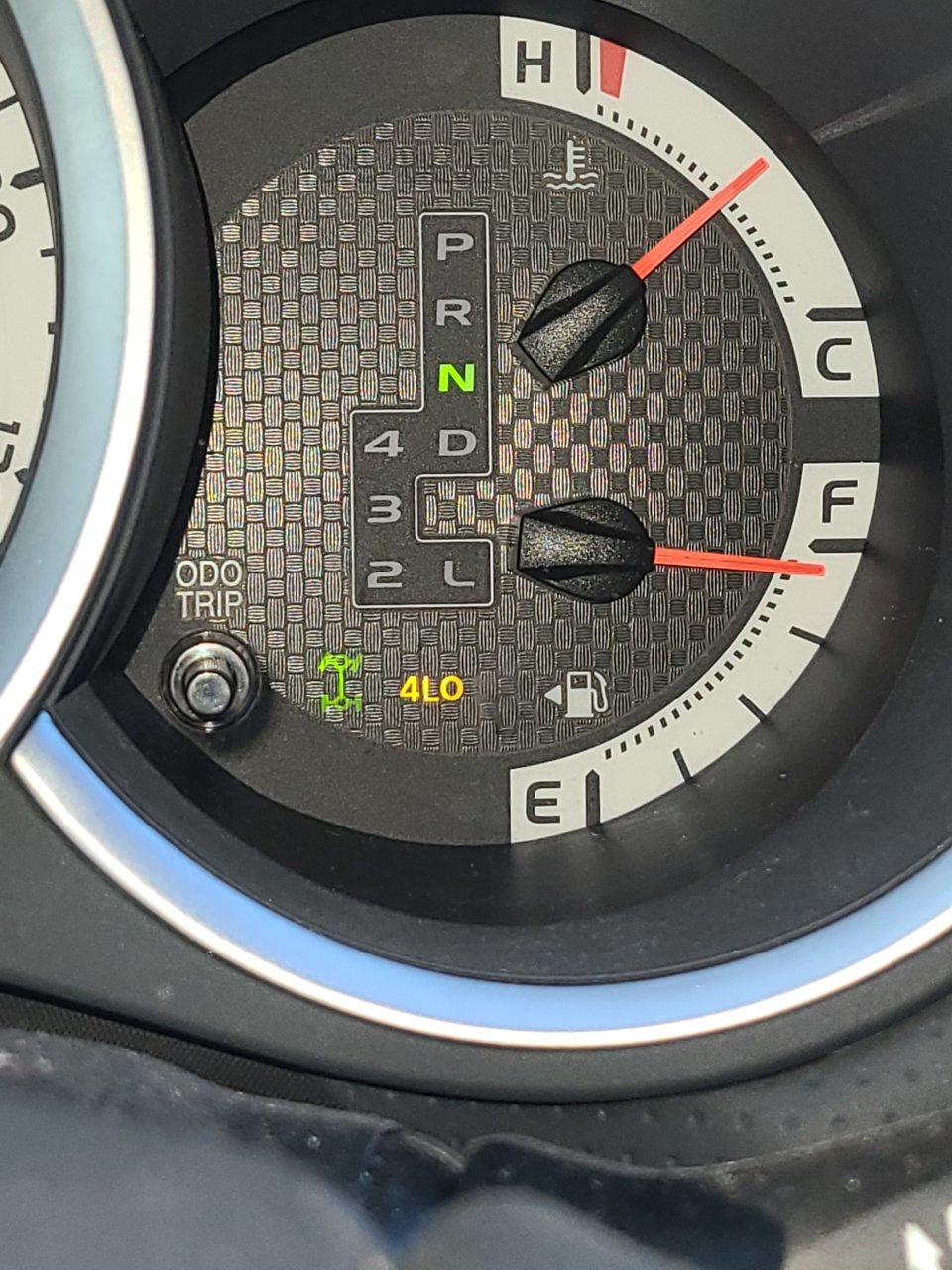

    Just finished my 4x4 conversion today:bananadance::bananadance: thanks for all the info

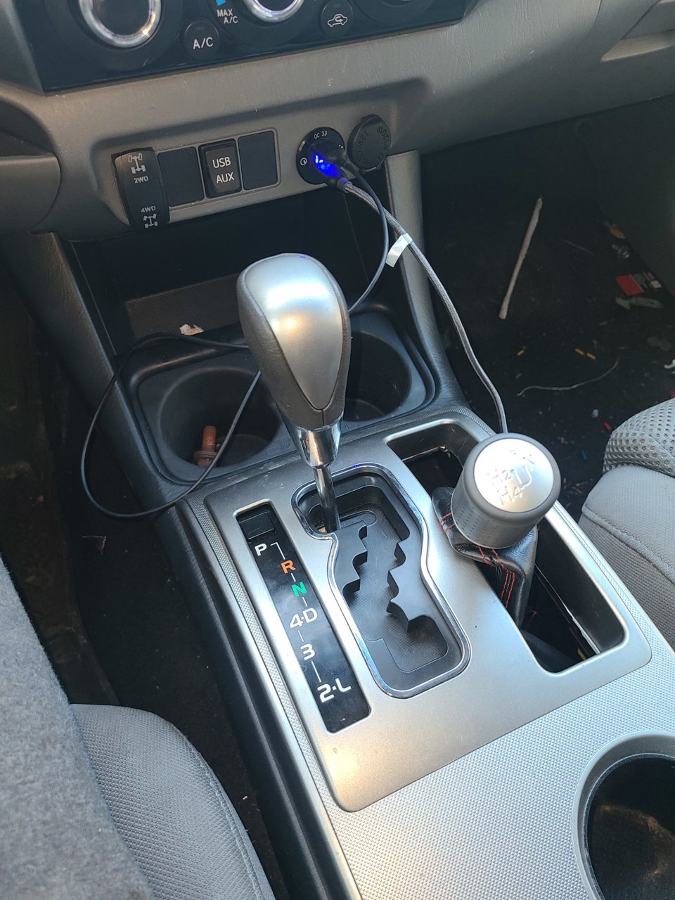

    I just mostly followed this post and a little of others. I did ADD just wired the hardness myself and welded the transmission support ,fuck paying 169 for a switch and 365 for the rst parts( I ain't rich). I went single, one of the members here messaged me and sold me an extra one he had left over. Of and the driveshaft did fit, barley but it fit .

    i need to go back in and wire the lights on the dash on my swap.
    good idea on the center console for the shifter.
    i have mine there as well.

    I approve of your conversion. Shifter is in the right spot, done on the cheap, lights all work. Well done.

    looks great! I’m finishing mine this weekend. Which shifter did you end up using and how did you modify it? I don’t have a welder so I’m trying to get around a complete custom job.

    I just cut the fj shifter near the bottom and rewelded it with some rod and pieces I had to route it just under the coin slot. Had to cut the black piece off the shifter cause it was to thick.
