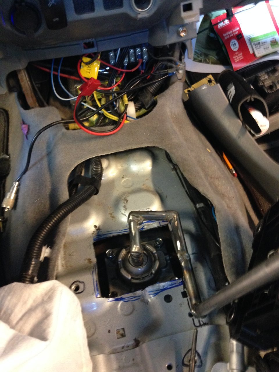

    This is how my shifter looks

    Yeah I saw ur post I was going by ur hole to cut mine but some thing went wrong and I cut a little to much to the left but nothing a little welding won't fix

    Did you have to trim the plastic body of the shifter assembly?

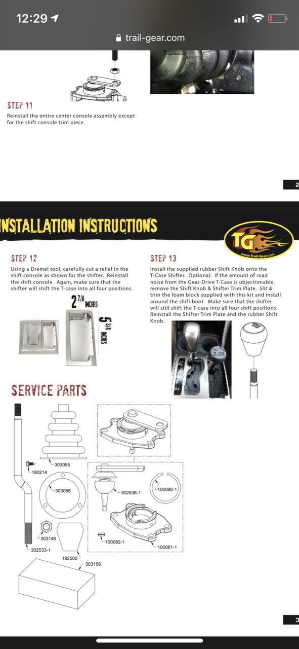

    I’ll let you know when I install mine. I saw a picture somewhere, Trying to track it down, that it comes up through the coin slot without fab. :fingerscrossed:

    Sweet. I sent an email to trail gear asking for a pic and what they mean with modification to the shift console. I assume they mean cut through the coin slot but don’t want to have to cut the plastic on the gear selector

    Sorry, it’s in the instructions.
    says to modify the coin slot a little bit, but I’ll see if I can spin the shifter, since it’s threaded, and finagle it into place. If not I’m going to find a way to secure the RST leather boot I have to cover the cuts.
    https://trail-gear.com/downloads/pdf/instructions/303072-1-INS.pdf

    Oh lit this is awesome. Gonna go ahead and place the order

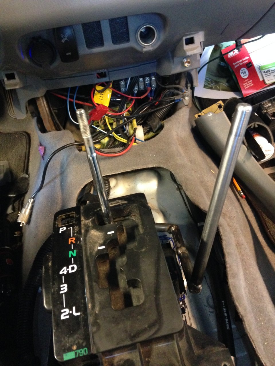

    You will have to cut the shifter console. It’s really not a big deal. If you look in my pic above you can see the left threaded hold for the shifter but the right is missing.
