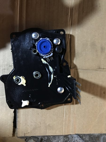

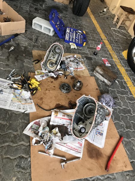

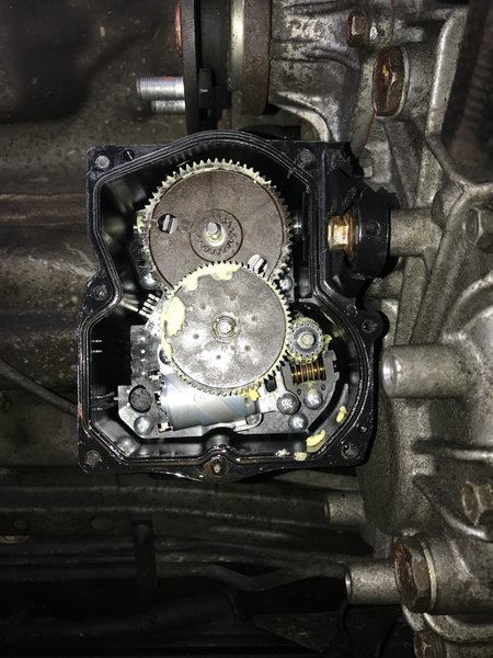

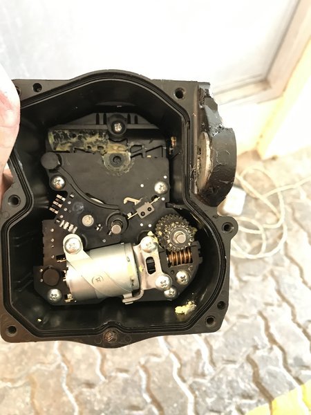

  17. Jun 5, 2017 at 7:31 PM
    #97
    libagui
    libagui [OP] Well-Known Member
    Feb 16, 2009
    #13689
    589
    Dominican Republic
    05 tacoma prerunner
    Bilsteins 5100 set at .085 Rear custom 1" add a leaf 265/70 R17 tires. Custom made aluminum tonneau cover with bike rack. 4x4 conversion with 4Runner transfer case.

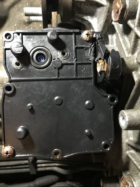

    IMG_0166.jpg IMG_0169.jpg IMG_0170.jpg IMG_0179.jpg Found a problem that I haven't noticed, one of the taps front center differential actuactor was broken, this was causing some issues, apparently because when gears were pulling case was moving not allowing full movement of internal parts. This was a very bad news since everything I have read about this 4Runner transfer case actuactor is that you have to take transfer case apart to replace it.
    Been things this way I said, I will not lost anything if I try to fix it taking it apart, and I Did. Once I took everything apart I just confirmed that there's no way to put internal mechanism in time without a guide, and when I thought everything was f... up, I found a Toyota 4x4 diagnosis manual. This document shows how every Toyota 4x4 works, then I just had to figure out how to put gears in time to get limit switches in its position according to this manual. Right now, I made a test in vehicle and everything moves just right. This weekend I will figure out how to put it back in transfer case ( just reverse what I Did to take it out).
    not_nick and Sleipnir like this.

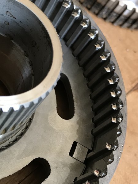

    Feb 16, 2009
    #13689
    589
    Dominican Republic
    05 tacoma prerunner
    After some trials I could notice that shift shaft for center lock and H4 was not doing full travel. Took transfer case down and found a striped sprocket.
    I think I cause the damage before figuring out that transfer actuator was broken.
