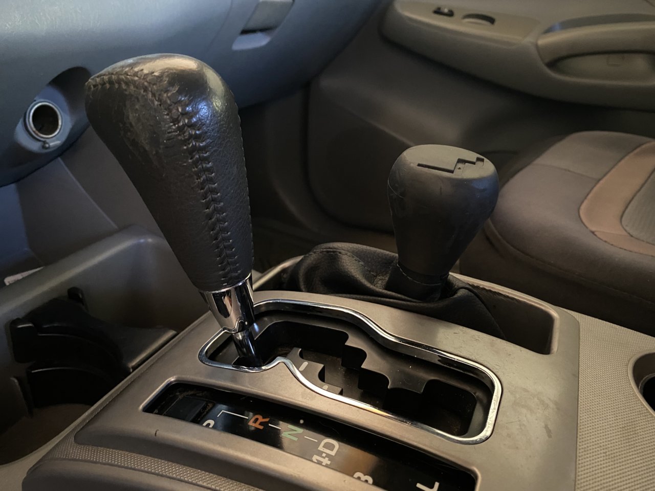

    Looks great. How difficult was getting the shifter setup?
  3. Oct 2, 2021 at 9:17 PM
    #183
    jawmes
    jawmes [OP] Well-Known Member
    Mar 1, 2021
    #357846
    267
    James
    Kauai, Hawaii
    2007 Tacoma 4x4 PreRunner
    I’ll need to take a pic of it, but it’s 3 M12 threaded rods and 2 metal elbow pipe fittings routed up from the transfer case:rofl: I was over getting it welded so that was my solution haha

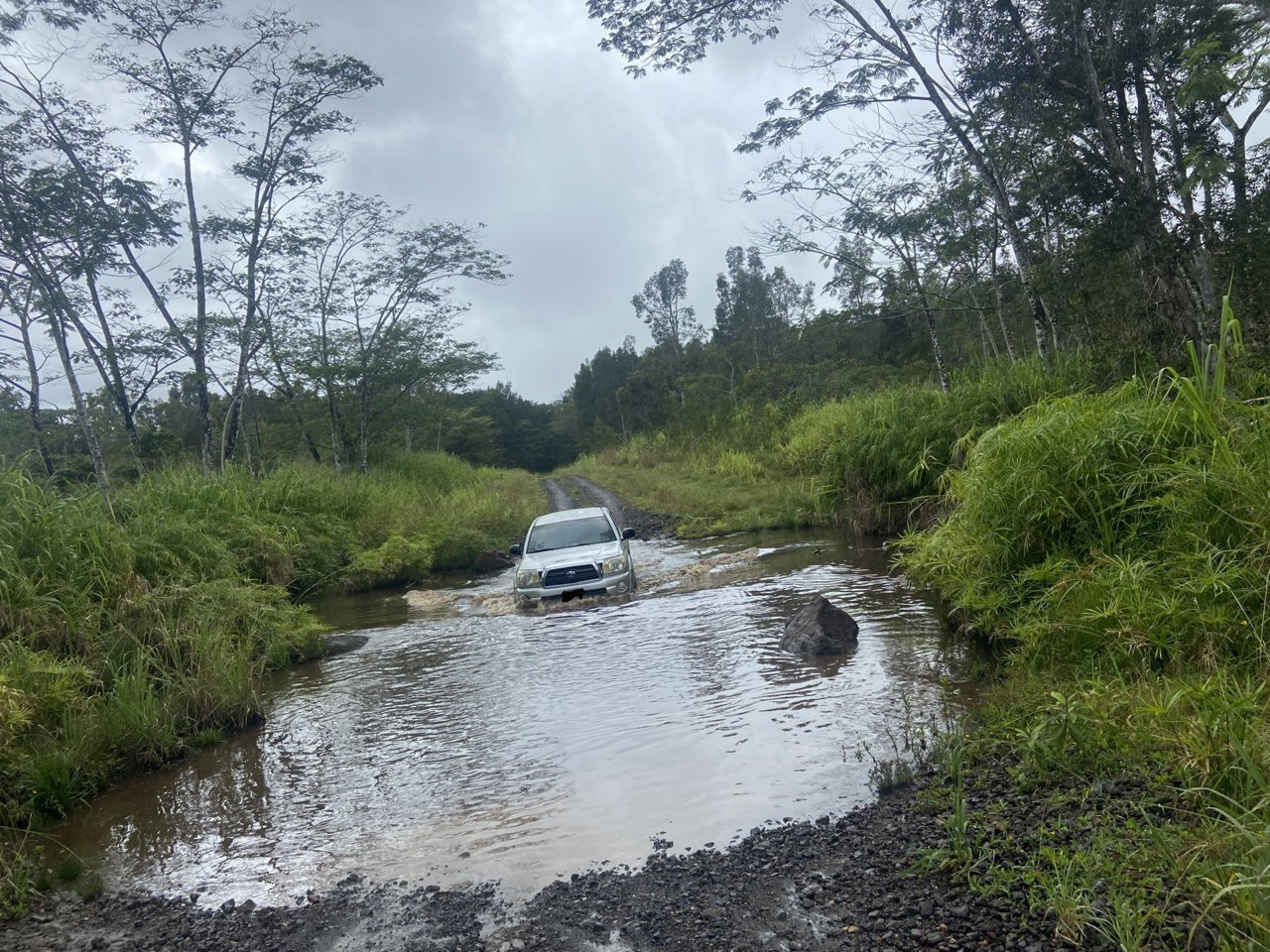

    Time to do one of these :)E2F9F53F-73EE-4689-B9FC-0604EEEA5ABE.jpg
    Longtech and jawmes[OP] like this.
  7. Oct 2, 2021 at 11:11 PM
    #187
    jawmes
    Mar 1, 2021
    #357846
    267
    James
    Kauai, Hawaii
    Haha funny how much higher the water seemed when I was in the truck! I was surprised too how well 2wd could handle

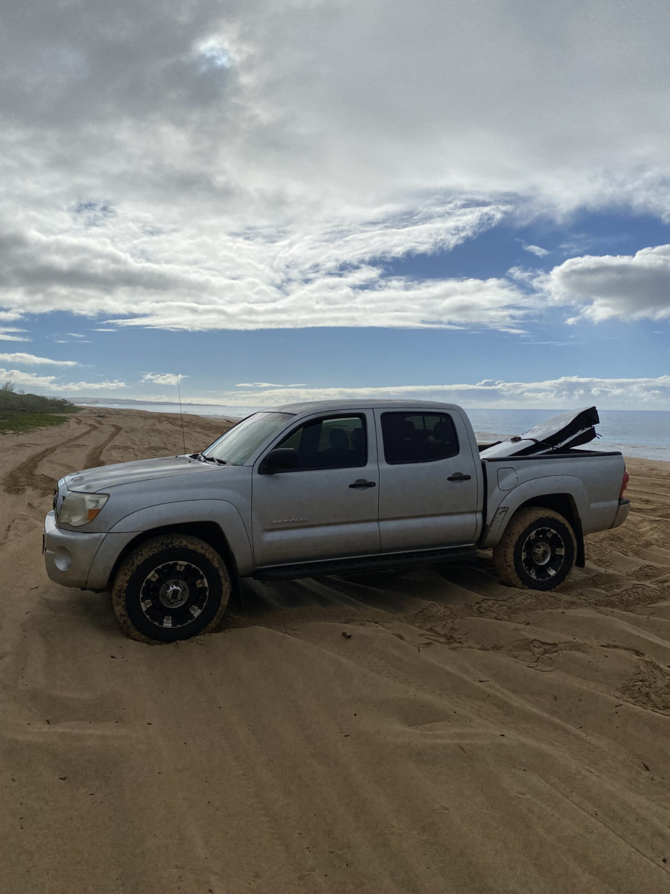

    I think the ADD is broken:bananadance:
    Felt kinda squirrelly on the sand yesterday. Didn’t get stuck, but without the ADD actuated does that mean my prerunner could have made it before the swap? LOL

    In b4 the “shoulda deleted the ADD” comments:crapstorm:
    Get under the truck and have someone else activate the motor, you should be able to hear if it’s working. Or jackup the back wheels in 4wd and see if it pulls.
    Also shower thoughts: since you have to manually activate the ADD now, wouldn’t it just be called the DD? :confused::confused::confused:
