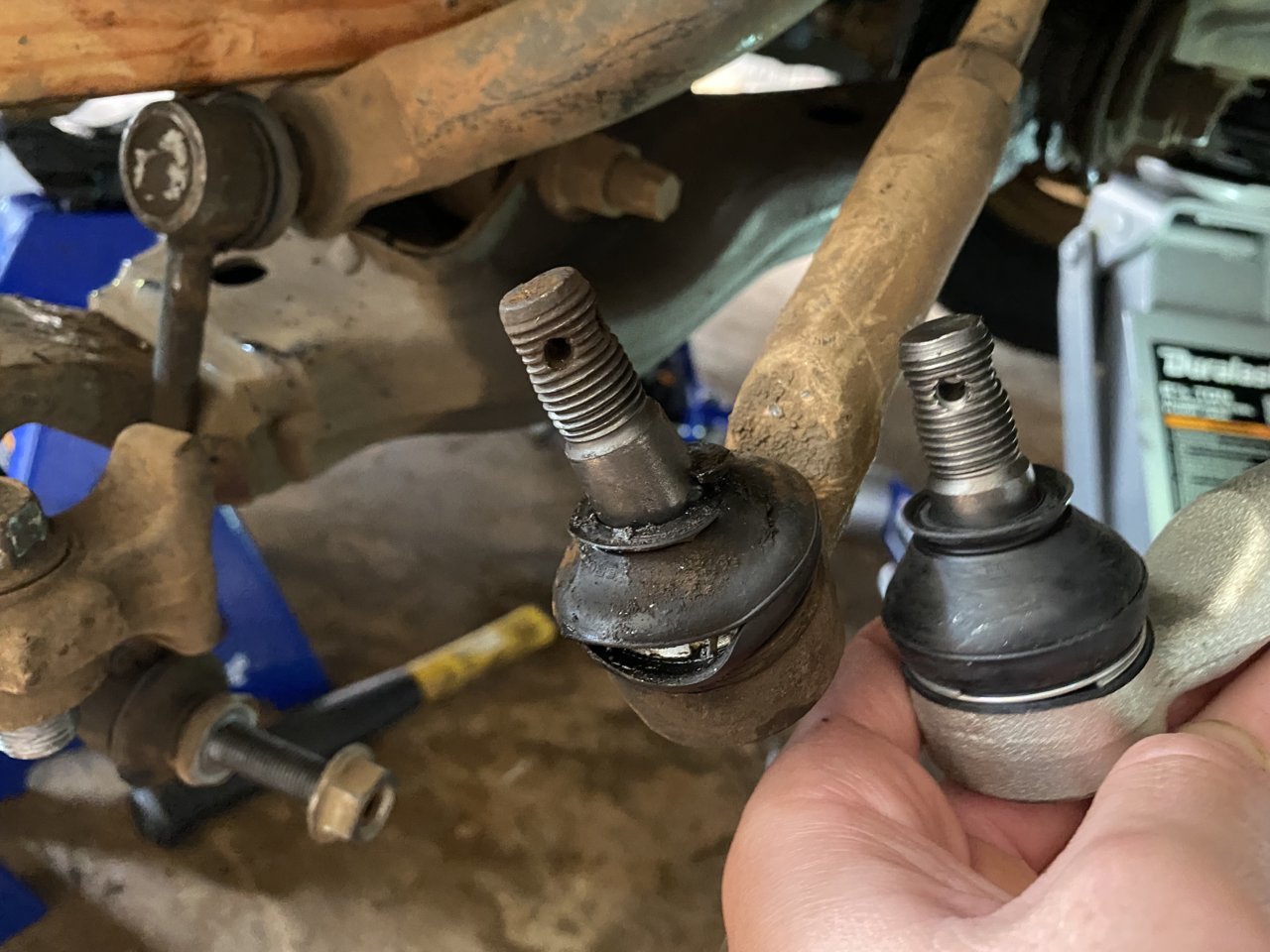

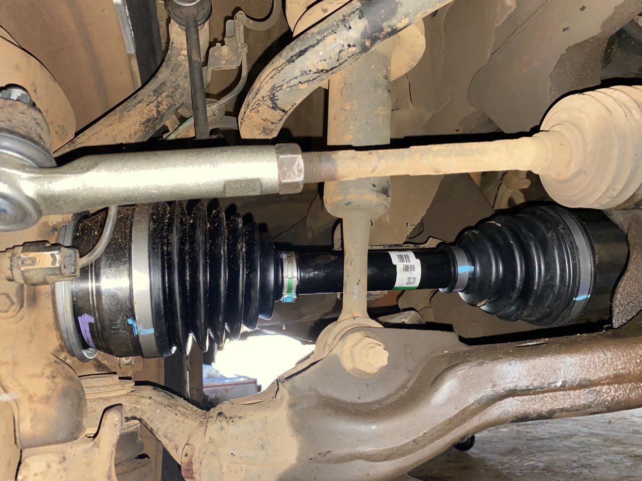

    8 hrs. 26 min. later the passenger side CV axle is in. Even got to replace an outer tie rod end, how wonderful:)

    Hell yeah dude! Making progress. I remember reading constantly about the C clip opening needed to be pointing down, did not struggle at all, good thing is in and making progress dude

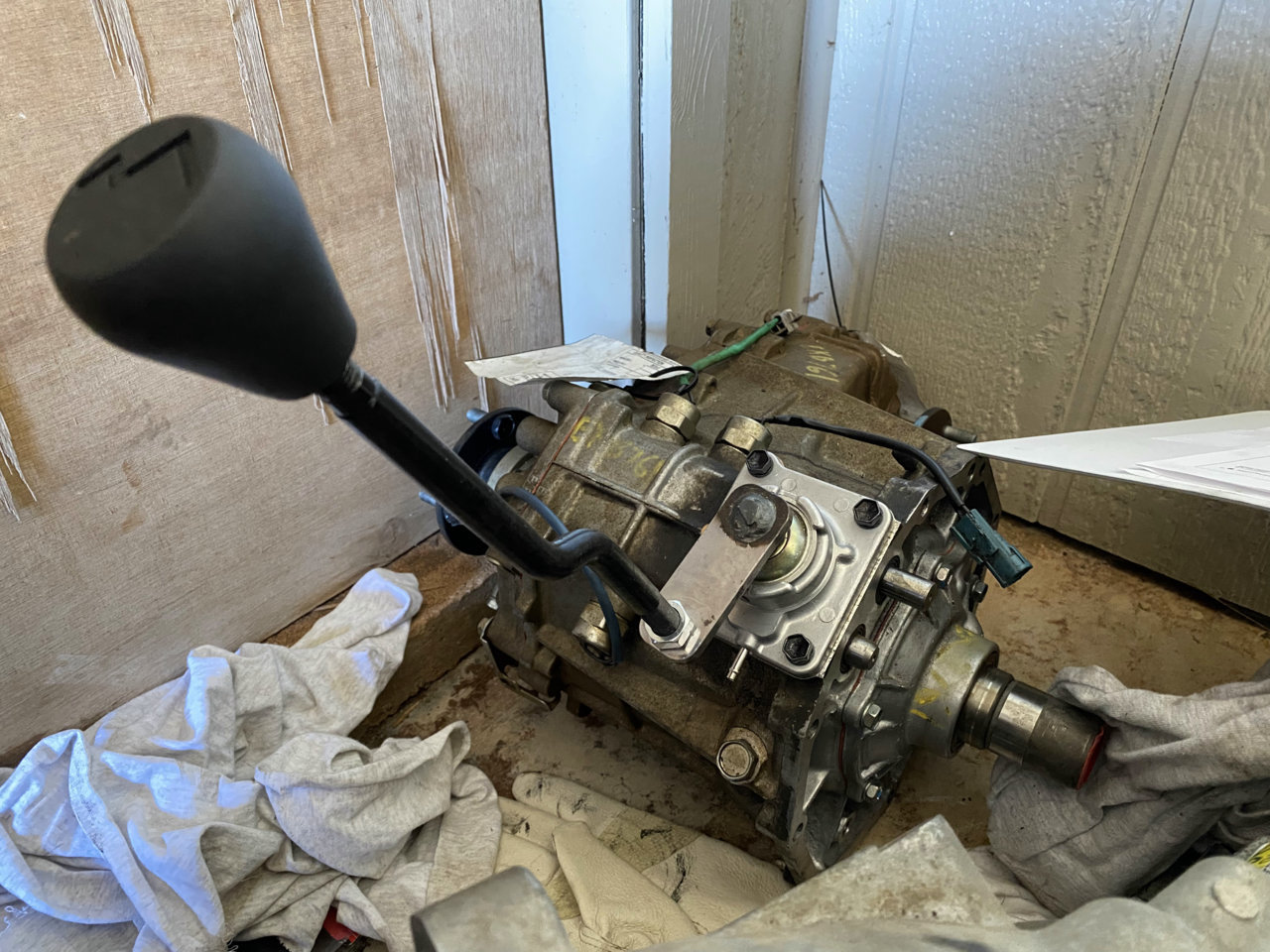

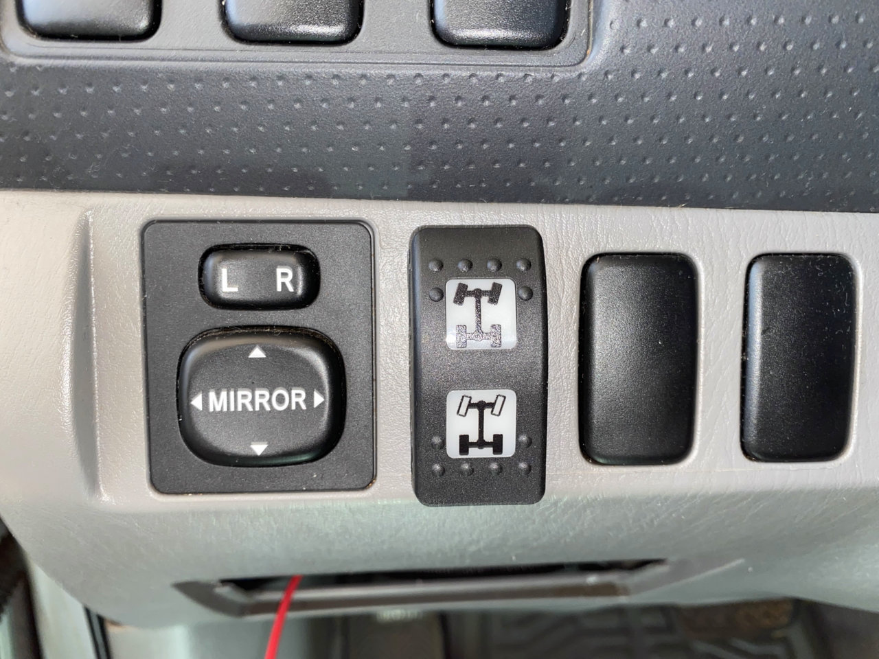

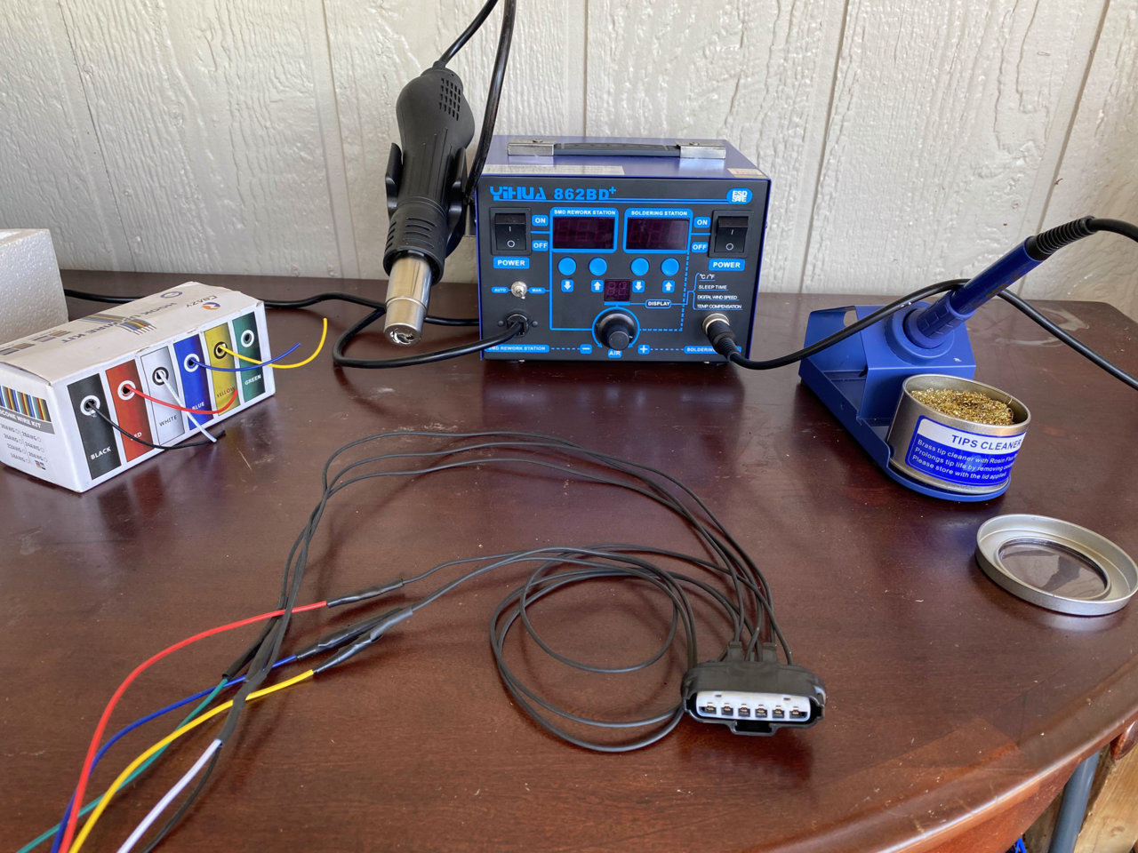

    Driver's side is almost complete, just forgot to order an axle nut. Hawaii's having some barge issues so I'm waiting for the dealer to give me a call back. I'm at 3 hrs. 33 minutes so far, which is ahead of schedule from my last axle change.
    In the meantime, I've been working wiring the ADD Harness and bolting the FJ Cruiser Transfer Case Shift Assembly. Good to make progress on those, shifting the transfer case made me pretty amped lol.

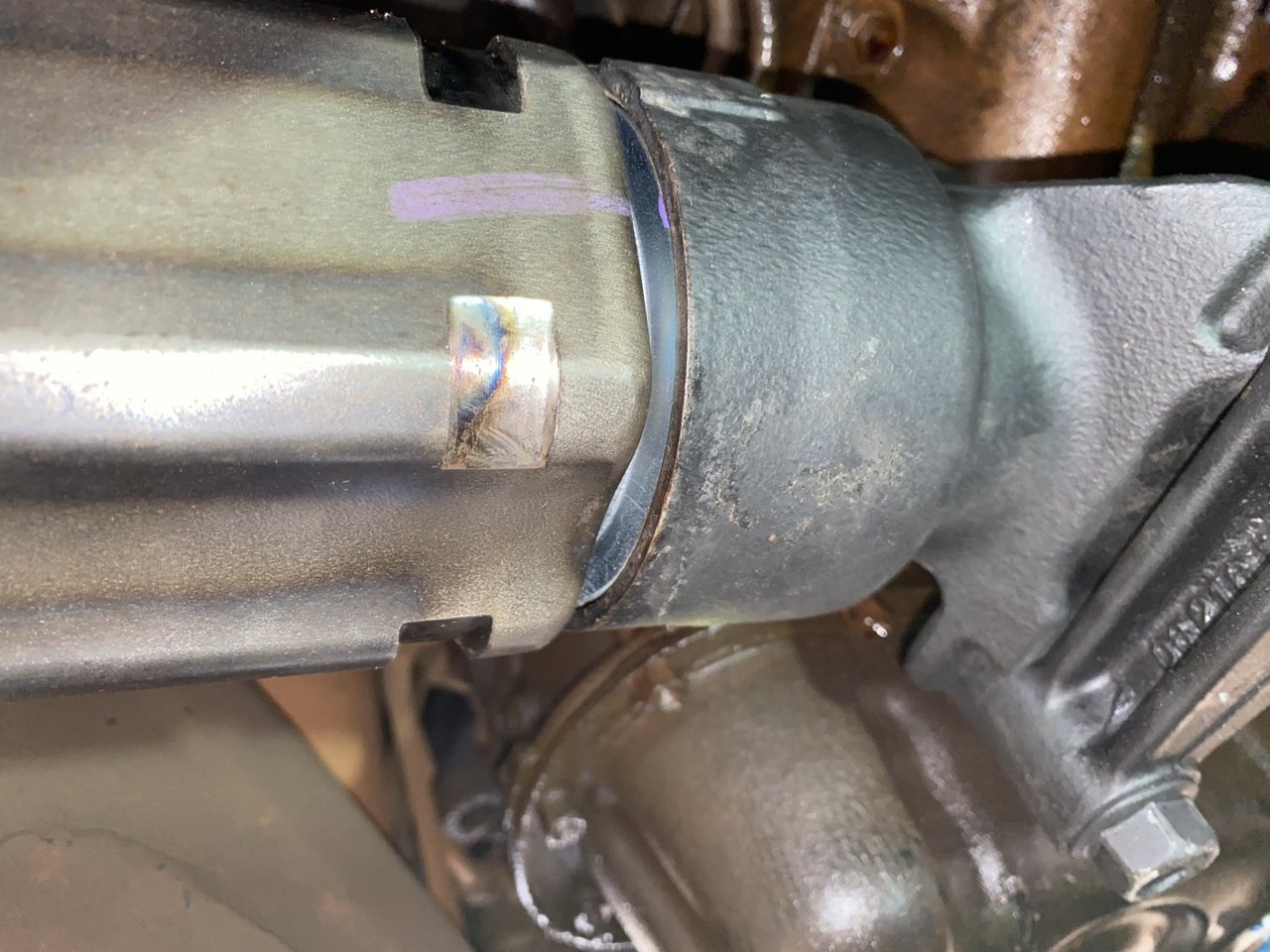

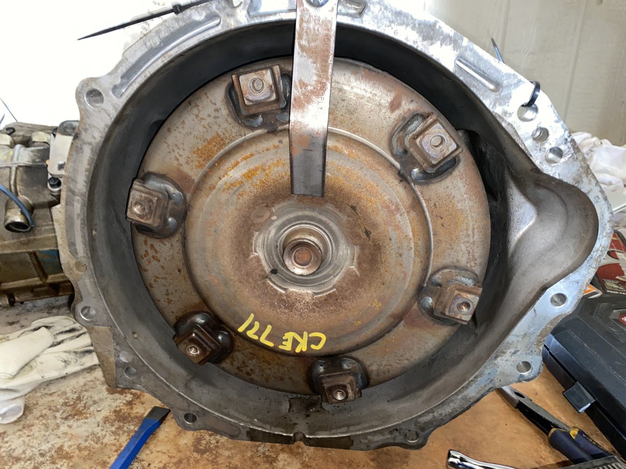

    Should I wirebrush this surface before installation? E2EF97F9-3975-4FB0-A900-93898D4AA14C.jpg

  14. Aug 3, 2021 at 7:59 PM
    #54
    pdaddy
    pdaddy WeLl-KnOwN mEmBeR
    Sep 10, 2019
    #304930
    2,641
    Preston
    Central AL
    ‘13 DCSB Converted Prerunner 4wd
    I didn’t. I figured it didn’t matter since the seal to the engine isn’t airtight anyway. I would make sure the threads are clean tho. When I was threading the TQ to the flex plate, the rusty threads got a bit CRUNCHY and I was worried I was gonna strip something lol
  15. Aug 3, 2021 at 8:16 PM
    #55
    Ricardo13x
    Ricardo13x YT: @UrbanOpsOffRoad IG: @urban.ops.offroad
    Feb 9, 2020
    #318785
    2,879
    Upland, CA.
    05 OR DCSB ProRunner(4x4 conv.), Chevy 63”s, NWF EcoCrawler, 35”s
    Random stuff. Oh! and converted to non ADD 4x4.
    clean the threads and send it.
