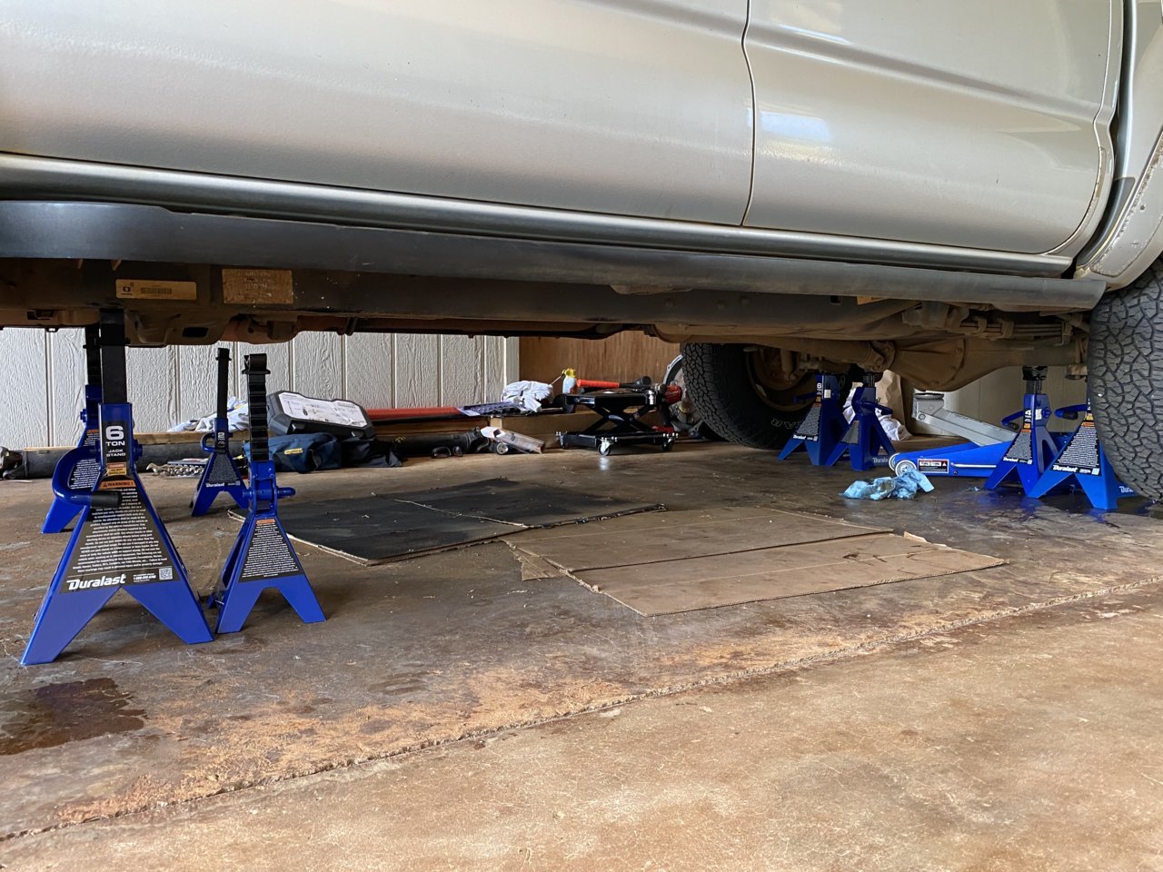

  9. Aug 6, 2021 at 4:54 PM
    #69
    jawmes
    jawmes [OP] Well-Known Member
    Mar 1, 2021
    #357846
    267
    James
    Kauai, Hawaii
    2007 Tacoma 4x4 PreRunner
    6375EC47-45D6-48FC-A654-978C30C937B7.jpg Captain safety

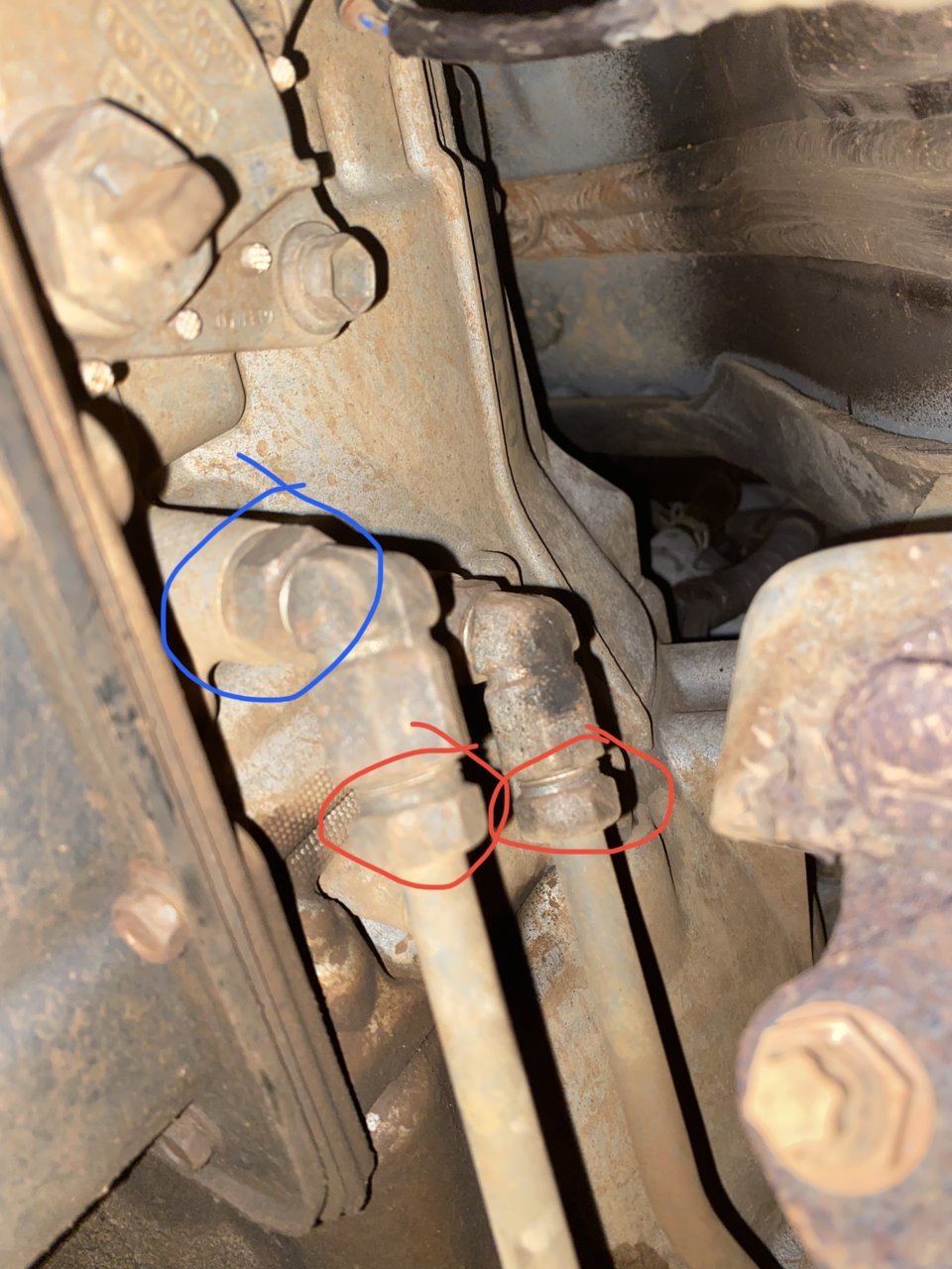

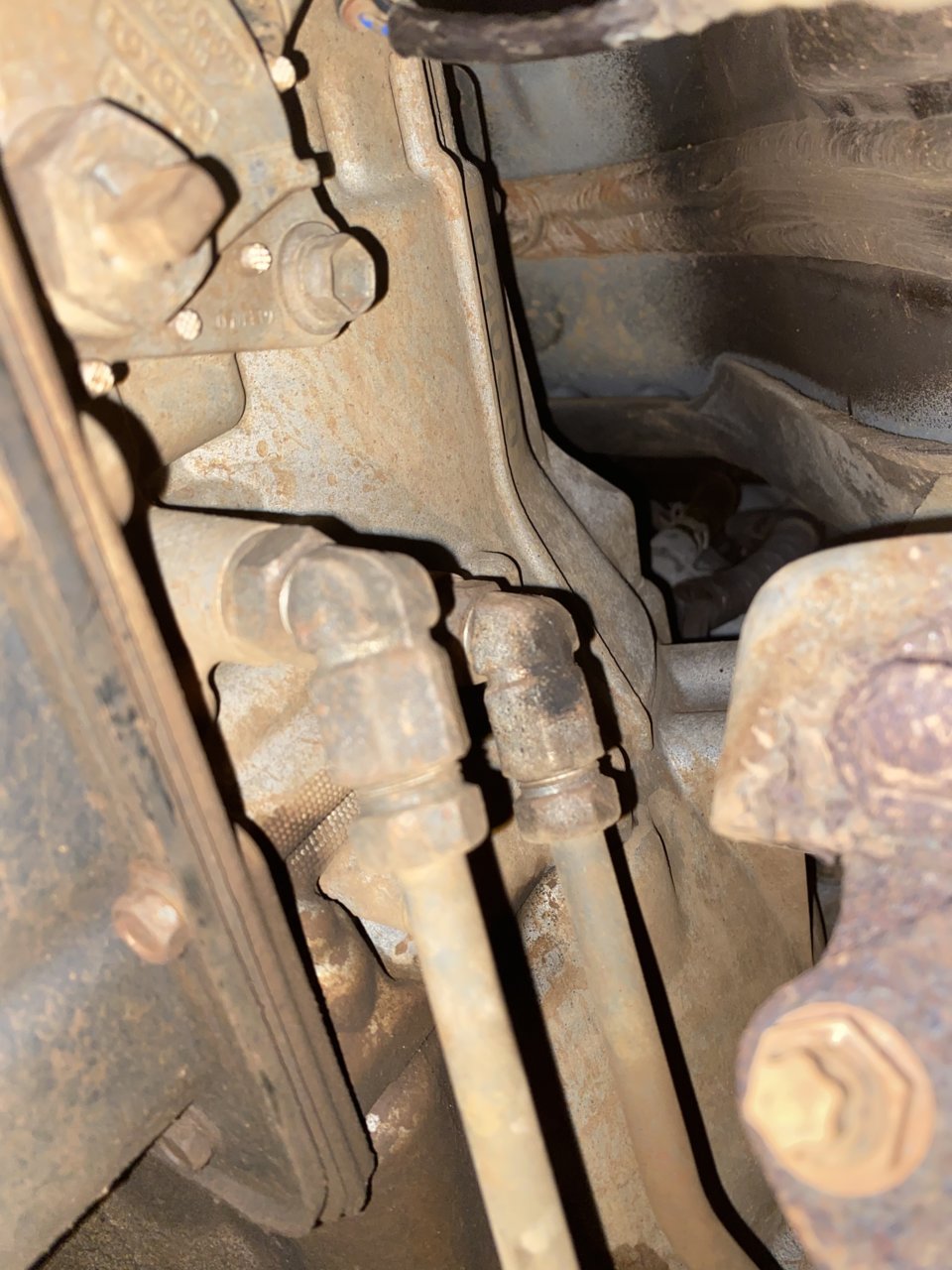

    Mar 1, 2021
    #357846
    267
    James
    Kauai, Hawaii
    These must be trans cooler lines? Just unbolt that after I drain the transmission? 3EAD230E-ED72-4B4D-9054-AC28AF2BC71C.jpg
    Ricardo13x likes this.
  11. Aug 6, 2021 at 6:24 PM
    #71
    pdaddy
    pdaddy WeLl-KnOwN mEmBeR
    Sep 10, 2019
    #304930
    2,641
    Preston
    Central AL
    ‘13 DCSB Converted Prerunner 4wd
    Yes so the blue nut loosens the connector so it can rotate, you’ll want to loosen it before taking out the lines. The red nut allows the tubes to slide out of the connectors. If I remember correctly, you can completely screw off the red nut and you may be able to pull out the lines by rotating the connector. If there not enough slack, it will come out when you drop the trans, just remember to check on it while you’re lowering the trans. There’s not a lot of fluid that comes out but there is someupload_2021-8-6_20-24-34.jpg
  12. Aug 6, 2021 at 7:01 PM
    #72
    Ricardo13x
    Ricardo13x YT: @UrbanOpsOffRoad IG: @urban.ops.offroad
    Feb 9, 2020
    #318785
    2,879
    Upland, CA.
    05 OR DCSB ProRunner(4x4 conv.), Chevy 63”s, NWF EcoCrawler, 35”s
    Random stuff. Oh! and converted to non ADD 4x4.
    Hell yeah! Don’t forget to loose the bolt that secures the line bracket by the bell housing for you to be able to move the lines to the right and slide the transmission out. Let me know if you need extra pictures with measurements for ease of reference when it come to the crossmember.
    Biscuits and jawmes[QUOTED][OP] like this.

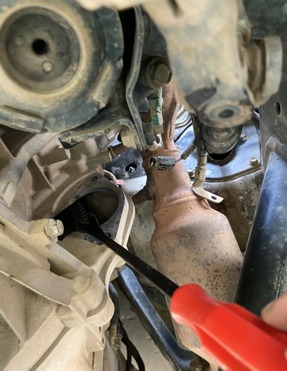

    Trying to turn this torque converter is really making me wish for a 6-speed now:rofl:
    6 gearT444E and pdaddy like this.

    Any other tips for rotating the flexplate? The only tools I have that probably wouldn’t damage it are plastic trim removal tools.. but those don’t seem to be much help. I have the tire off for a better view at least.
    Taking a break before I go ape on it and break shit haha
  16. Aug 7, 2021 at 9:36 PM
    #76
    pdaddy
    Sep 10, 2019
    #304930
    2,641
    Preston
    Central AL
    Sorry I couldn’t think of a better way. I just pushed as hard as could with the plastic push button tool. Can you move it at all?
  17. Aug 7, 2021 at 9:39 PM
    #77
    jawmes
    Mar 1, 2021
    #357846
    267
    James
    Kauai, Hawaii
    Nope, nothing lol. But from what it sounds like I’ll just need something with a little more grip. Maybe eat my wheaties in the morning too
    pdaddy[QUOTED] likes this.

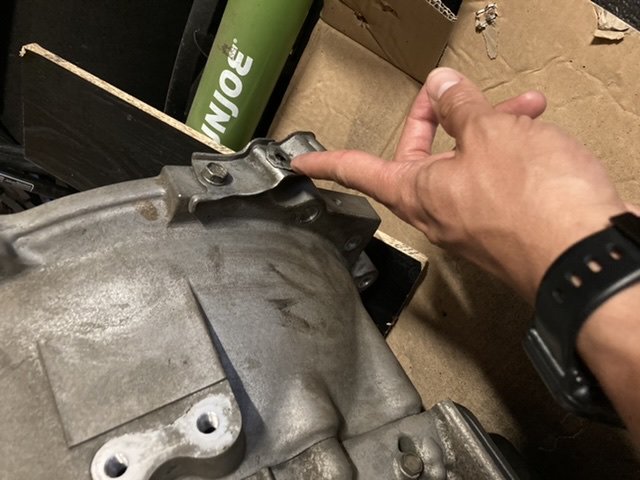

  18. Aug 7, 2021 at 9:45 PM
    #78
    jawmes
    Mar 1, 2021
    #357846
    267
    James
    Kauai, Hawaii
  19. Aug 8, 2021 at 1:47 AM
    #79
    Ricardo13x
    Feb 9, 2020
    #318785
    2,879
    Upland, CA.
    This is it.
