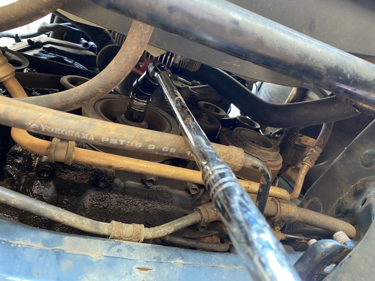

    LETS GOOO this shit works.
    22mm socket with a wobble socket and breaker bar. Rotate counter clockwise looking to the back of the truck

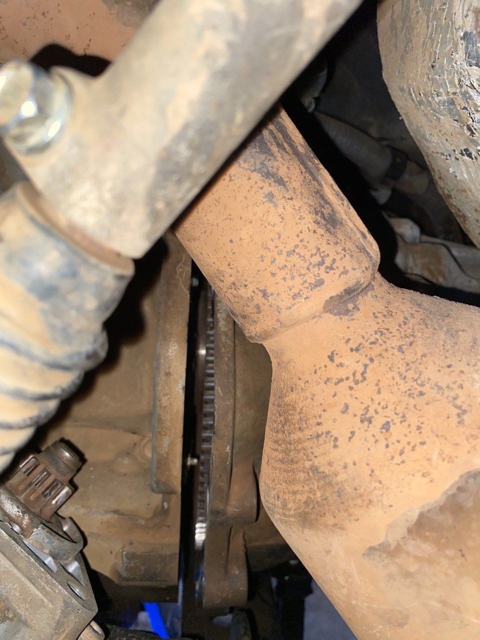

    Made a little discovery. If you happen to drop the flexplate bolts, there’s a little flap at the bottom of the bell housing where it mates to the engine. I popped this and my missing bolt came falling outD4F8FDD9-CC59-481E-AE9E-A6321DCFD410.jpg

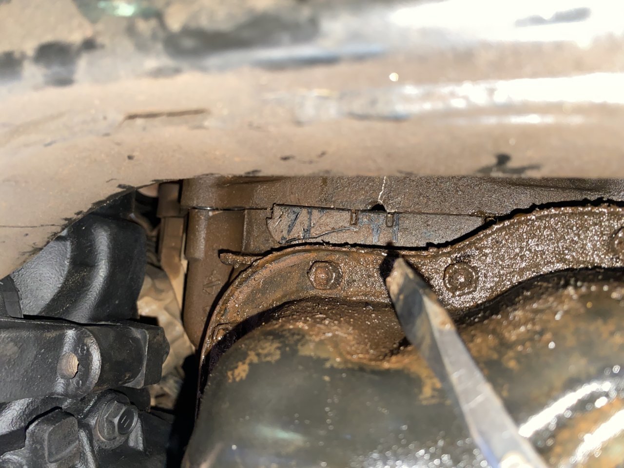

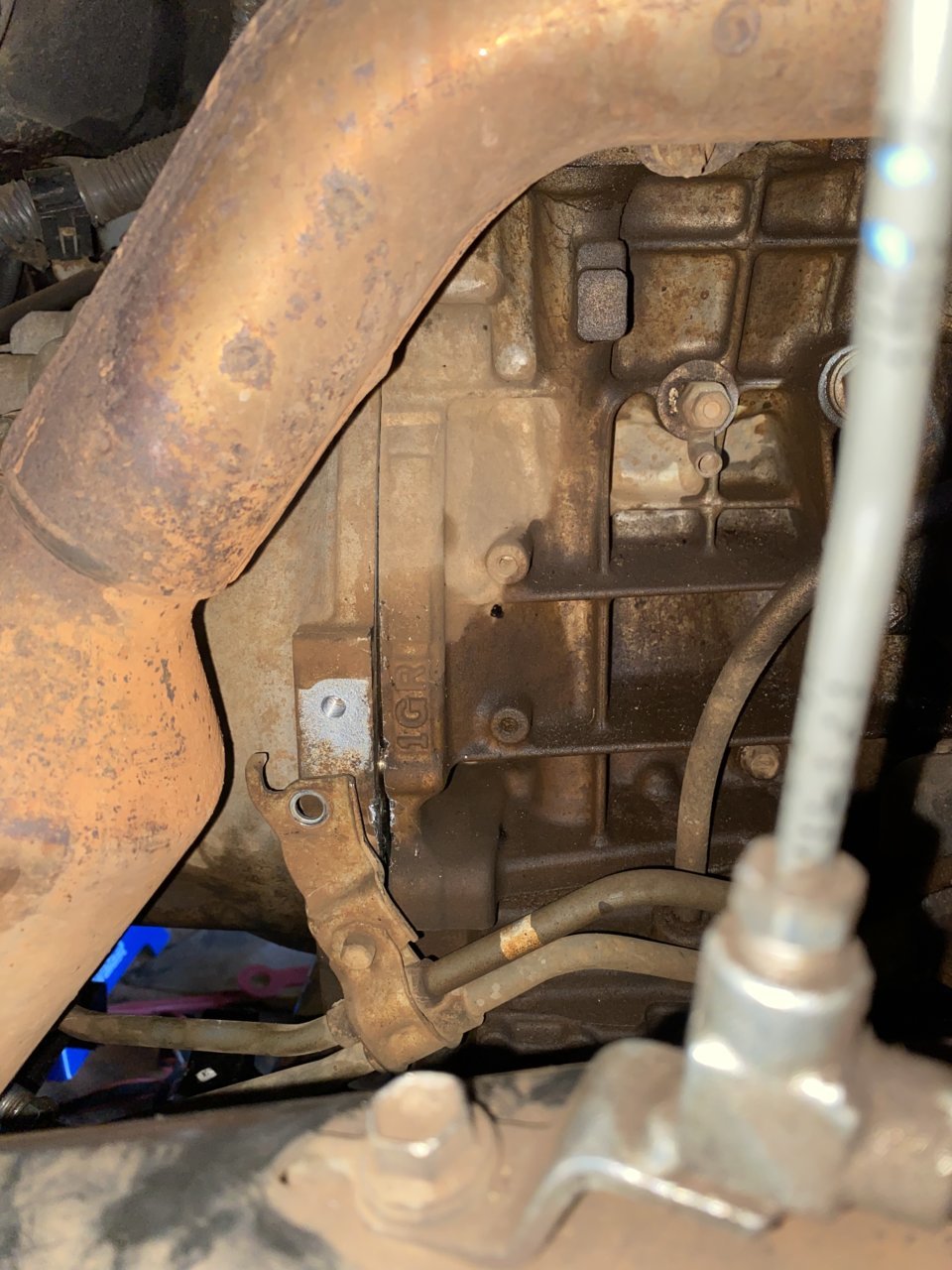

    Think I fucked up on the separation what y’all think?:confused:
    Drivers side:
    Passenger side:
  14. Aug 9, 2021 at 8:58 PM
    #94
    jawmes
    jawmes [OP] Well-Known Member
    Mar 1, 2021
    #357846
    266
    James
    Kauai, Hawaii
    2007 Tacoma 4x4 PreRunner
    There’s 2 dowels correct? I think it’s just stuck on the passenger one but I don’t want to pry too much
    Ricardo13x likes this.
  15. Aug 9, 2021 at 9:07 PM
    #95
    6 gearT444E
    6 gearT444E Certified Electron Pusher
    Feb 3, 2018
    #243372
    7,770
    Deep South
    Herculiner Hootus

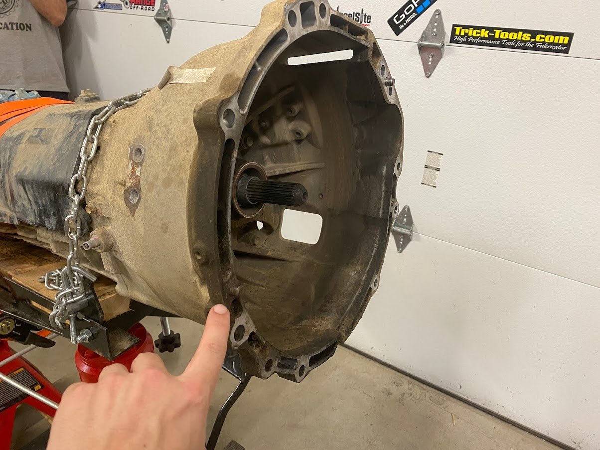

    yes, the passenger dowel is down lower right where it says "1" in the "1GRFE stamp". Id try and move the driver side back in a little. Take a pry bar and ease it off steadily from both sides. You don't want to wedge it into the dowels unevenly otherwise it'll never come apart.

    This is on my 6 speed but you can see the two dowels. The lower one ends up getting jammed up if you offroad because I know I've had water at least up to that line several times LOL
