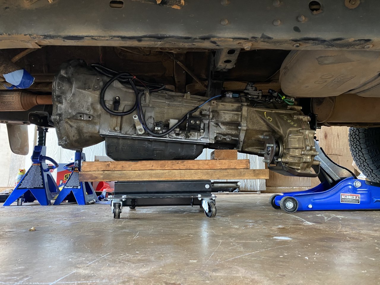

    Turns out I forgot the exhaust bracket bolt:thumbsup:
    Transmission almost out just need to cut the exhaust! Don’t want to disturb the afternoon peace so I’ll be wrapping this chapter up tomorrow:fingerscrossed:

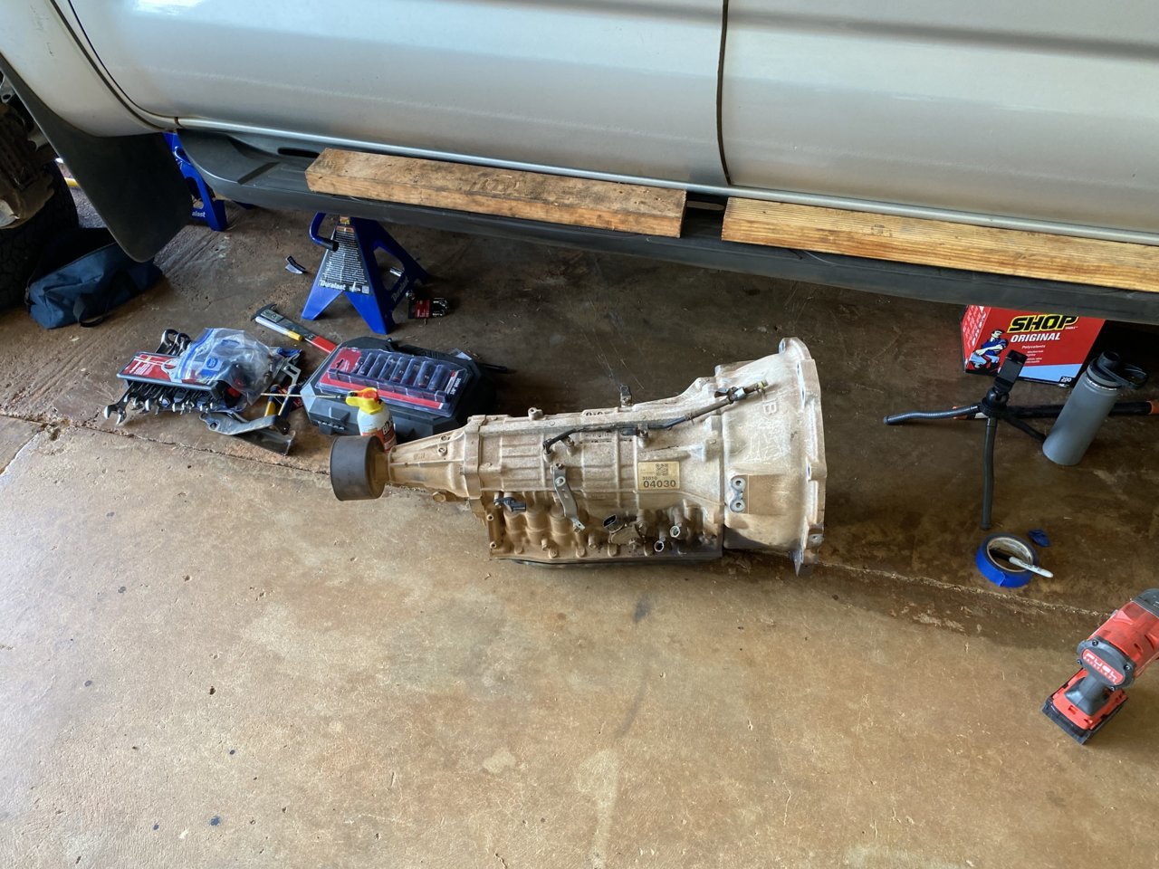

    2007 Tacoma 4x4 PreRunner

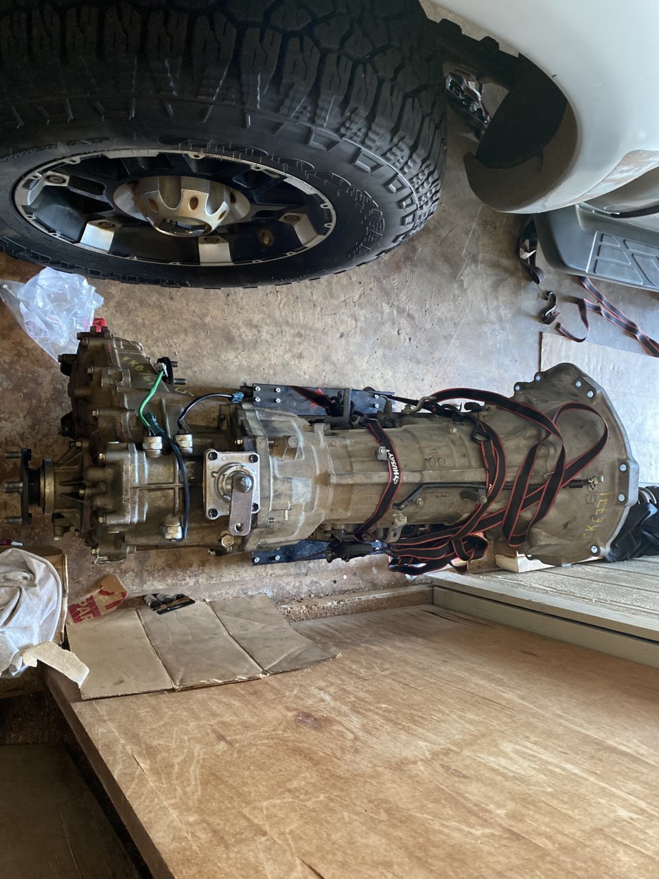

    Just about ready to stab this thing back up in there:headbang:
