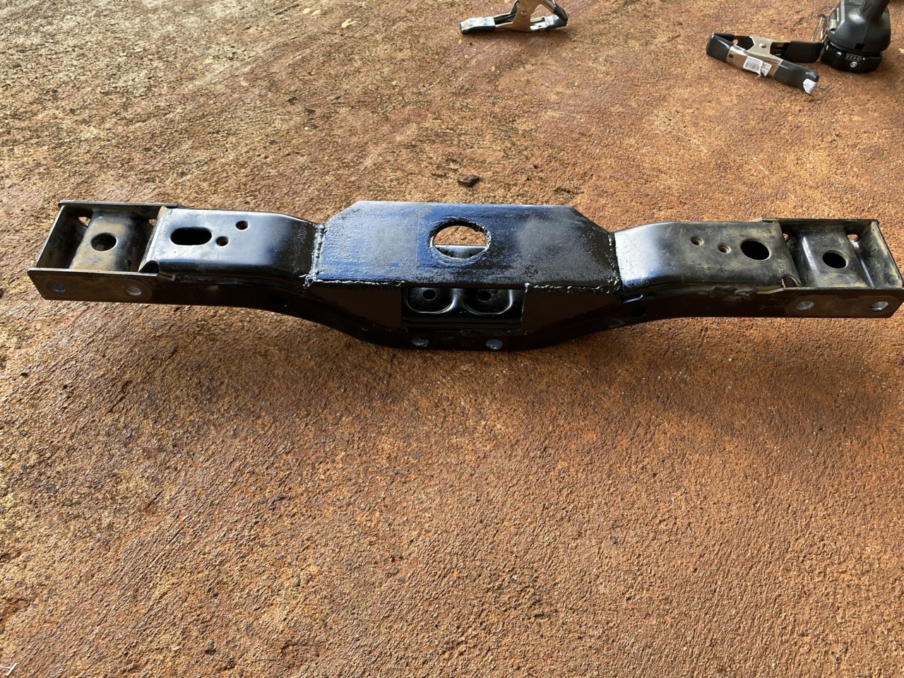

    Had to roll it out of the garage for a couple days but we’re back to it:thumbsup: that gave me some time to bring the crossmember to the welder to add supports:
    6F618FB6-C166-42AB-B938-272D860F1CCC.jpg 1D58A6D0-DCE7-48EA-9968-64E25F17C1E8.jpg
    Still need to troubleshoot turning the crankshaft later.

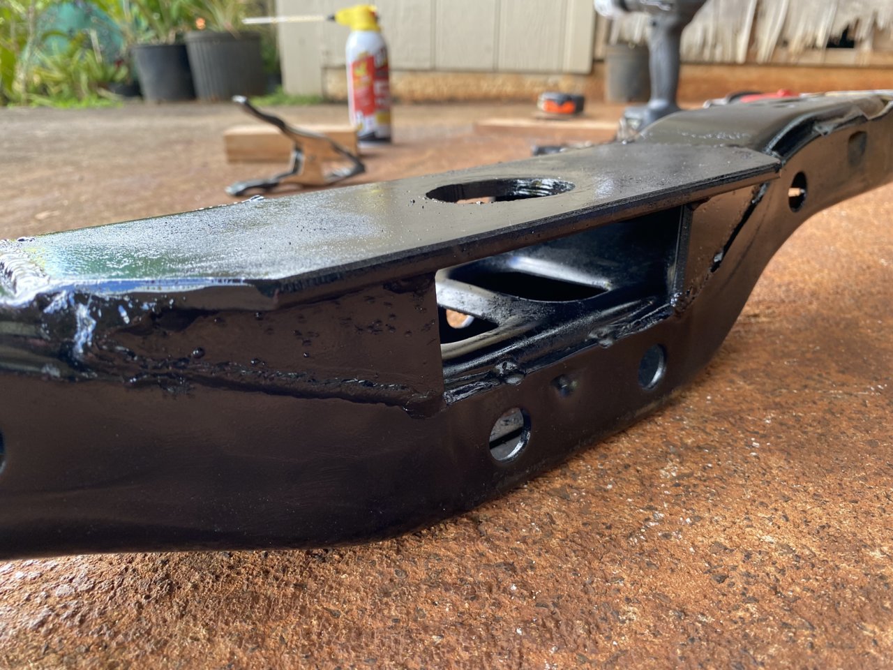

    Bro! I totally forgot that I notched the bottom part where the guide seats, I did that because it seemed kind of close, I don’t believe it’s 100% needed, but I was looking in to the worst case scenarios. So sorry for forgetting about this! You can still do it with the plate in place, because I did. 07A42747-51BF-4A44-A902-468272DE0FCA.jpg

    Thanks! What tool did you use to cut that?

    Well I used PAC, but again check if you need to, I believe I kind of overkilled it.

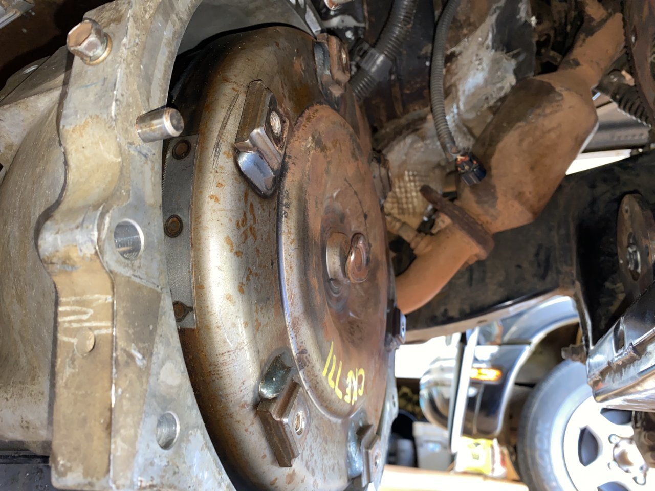

    9022FEA0-45F4-4D06-98F4-6E12249732C6.jpg The issue might be that the gap between the flexplate and torque converter isn’t enough. I can’t rotate the torque converter from behind the flexplate.
    this might be the dumpster fire I was expecting but we will see:)

    After some troubleshooting seems my best route is dropping the trans and reseating the torque converter

    Yea you should be able to easily move it, maybe it popped out during install. Sorry to hear that, that’s a lot of work

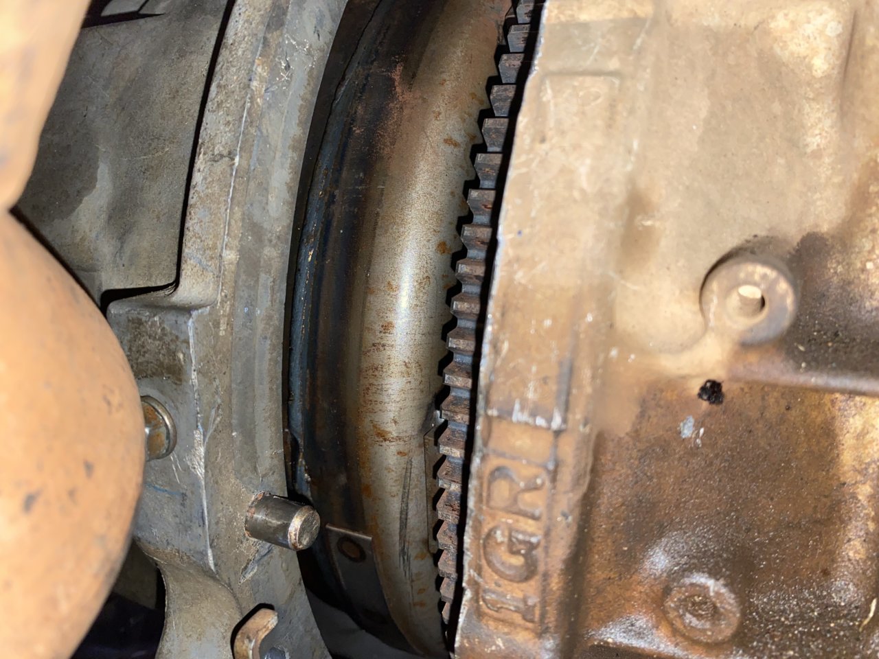

    I’ll let this photo speak for itself:bananadance:

    TC seized to the engine. I’m going to guess I should replace the flex plate, I’m not sure what tolerances I threw off if it got bent during install. Waiting for someone to spot me before I wiggle everything out then I’ll update on the condition of the transmission.

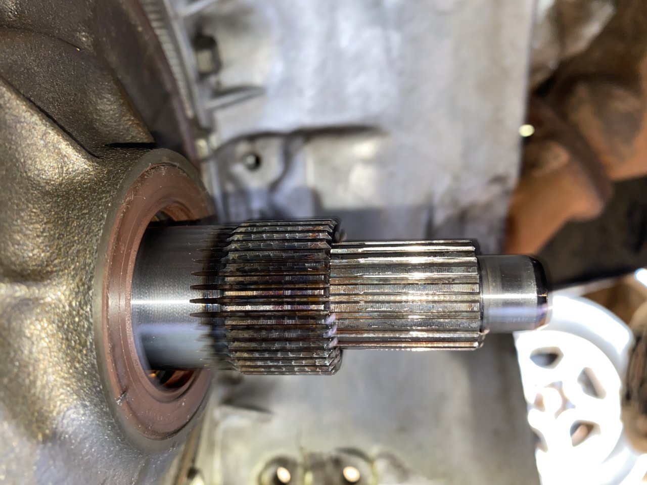

    3809FA07-0A87-405A-8F0C-48DA020A31F9.jpg Press F to pay respect.

    Nothing bent or metal shavings at first glance, I might be a lucky MF
