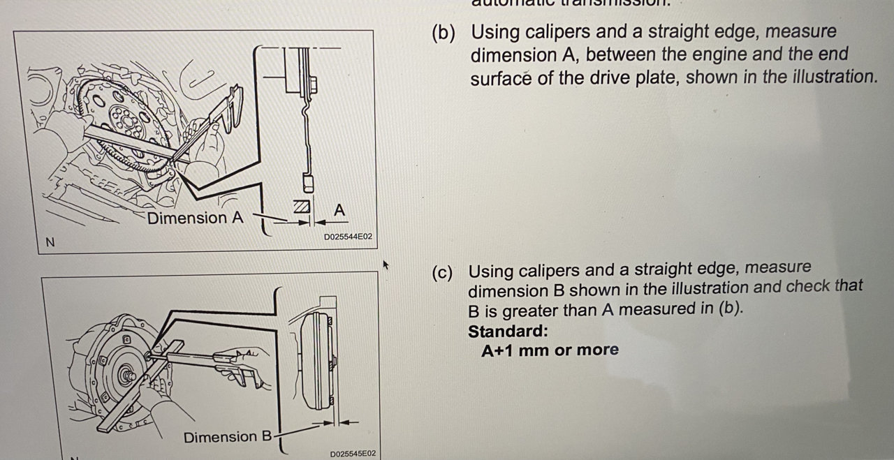

    Following this snippet from the FSM for the A750F. Are there any standards for what these should be, besides A+1mm?

    If it’s out of spec, it could be covered with the warranty, depending on where you got it from.

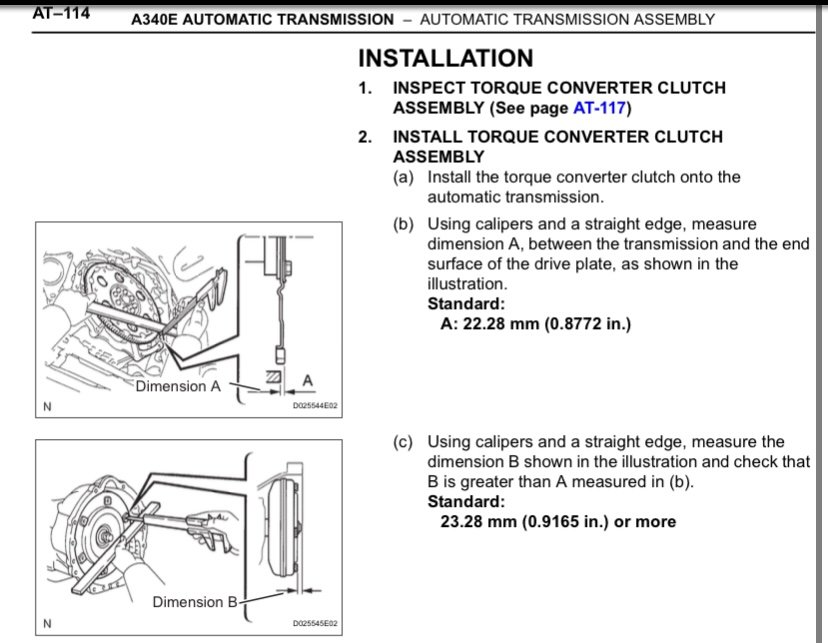

    This is from the A340E section. Why did they put a standard for this but not the A750F? 2C0C2E66-8140-4599-9587-AFA847464AE9.jpg

    My measurements:
    A: 21.1 mm
    B: 26.28 mm
    Ricardo13x likes this.

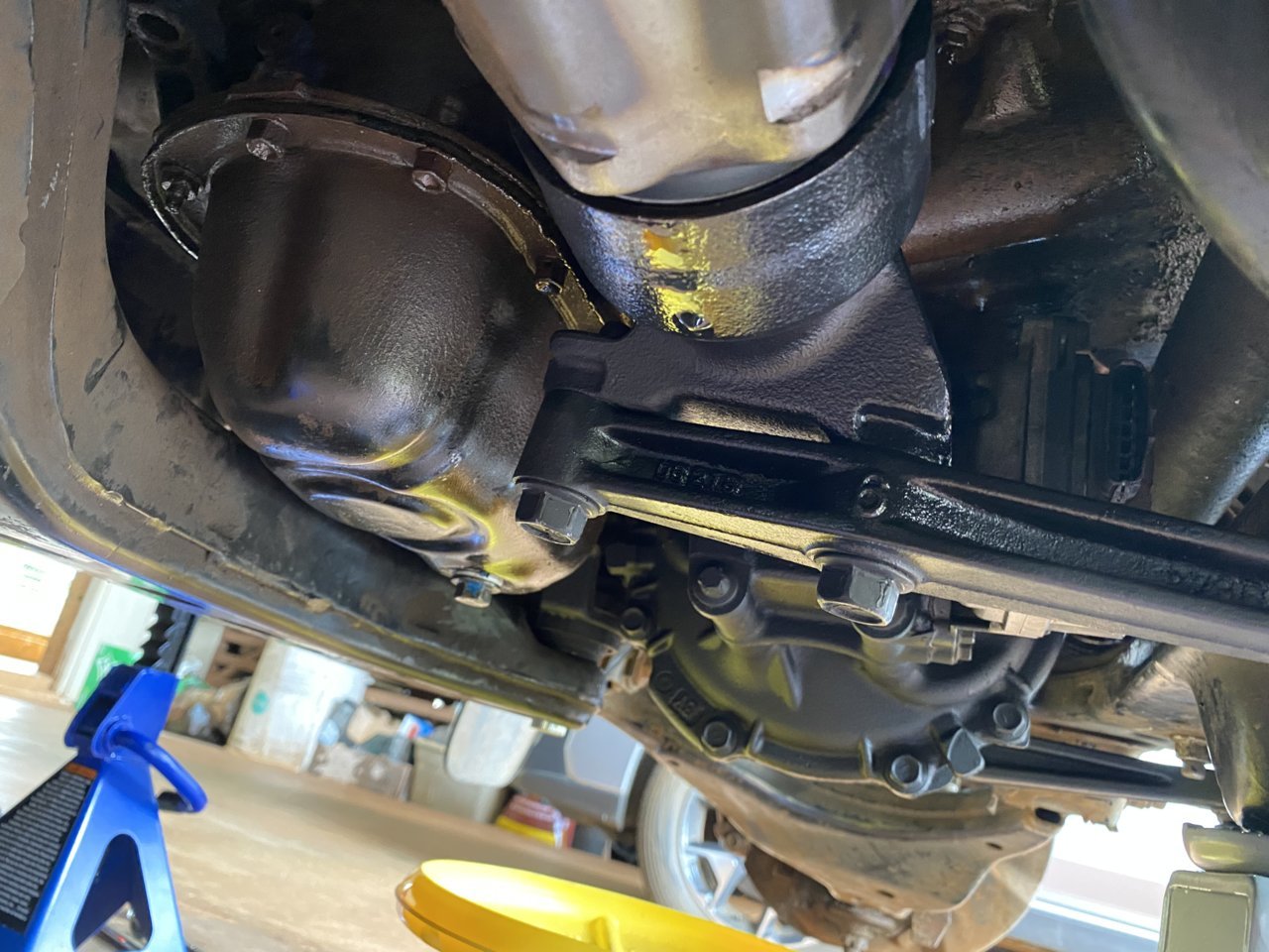

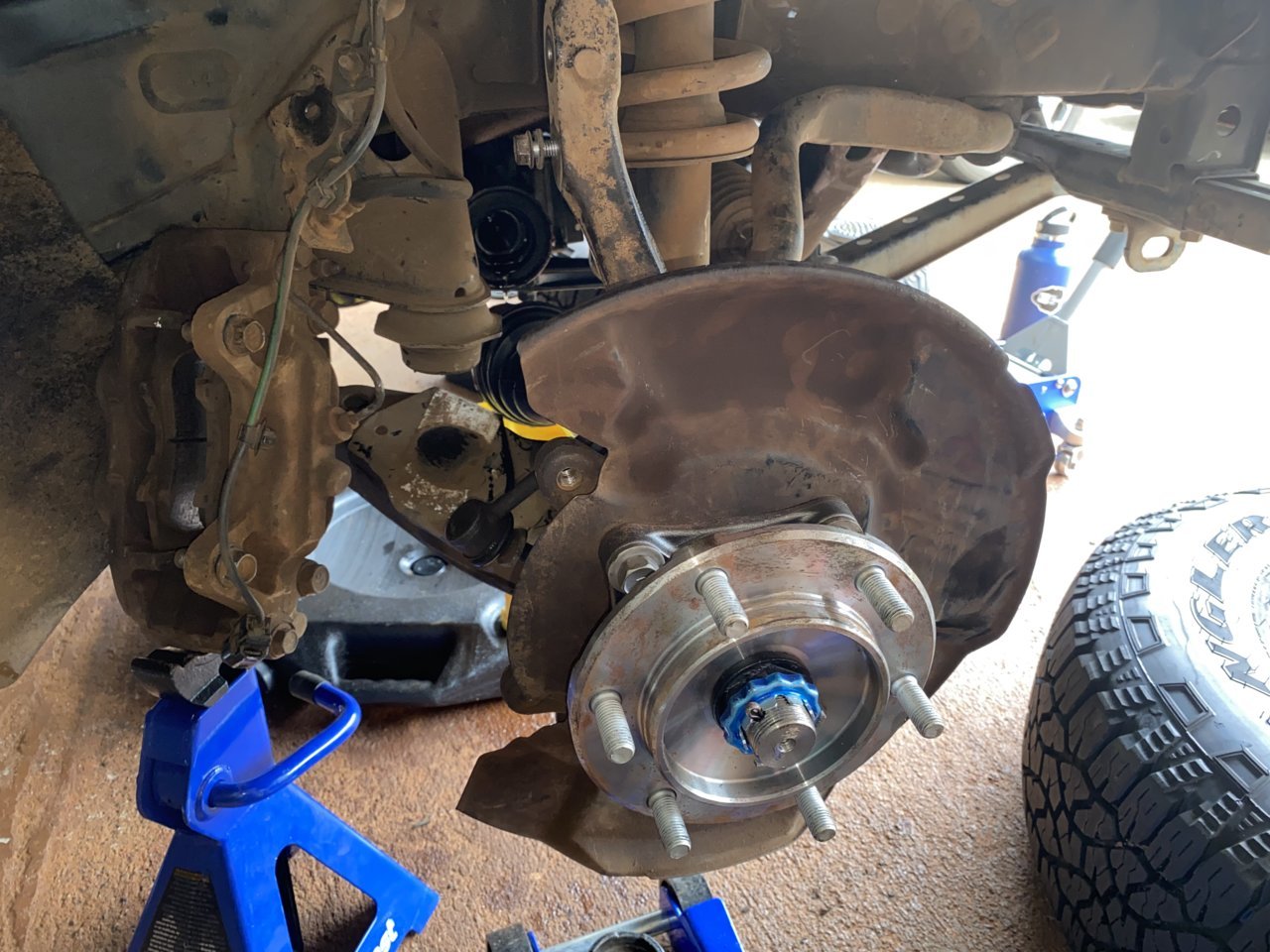

    Front diff was leaking like a waterfall so I changed the seal yesterday. Not too bad getting the axle out without having to remove the axle nut. Almost ready to ride!

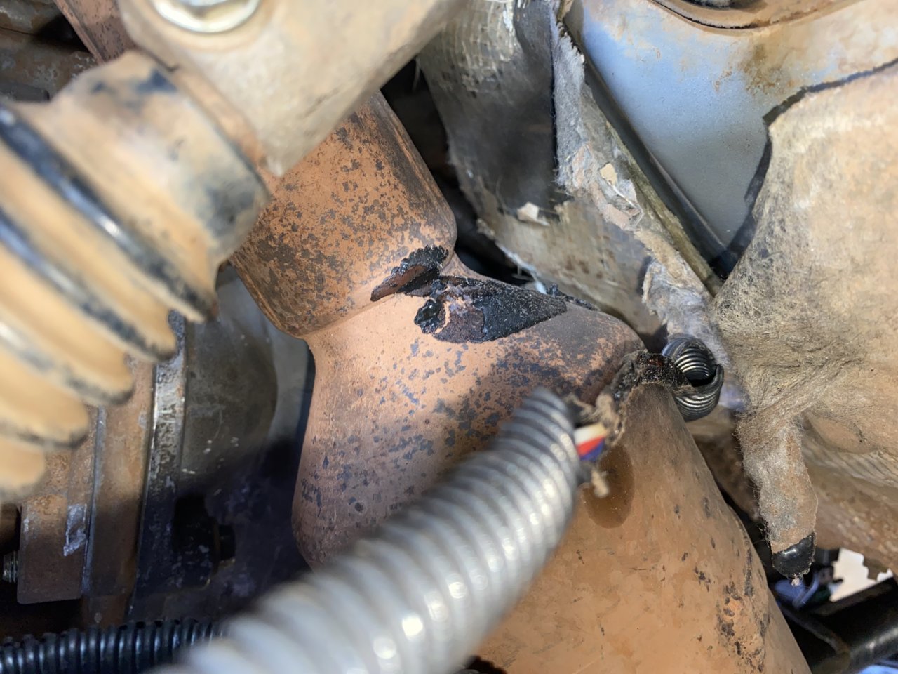

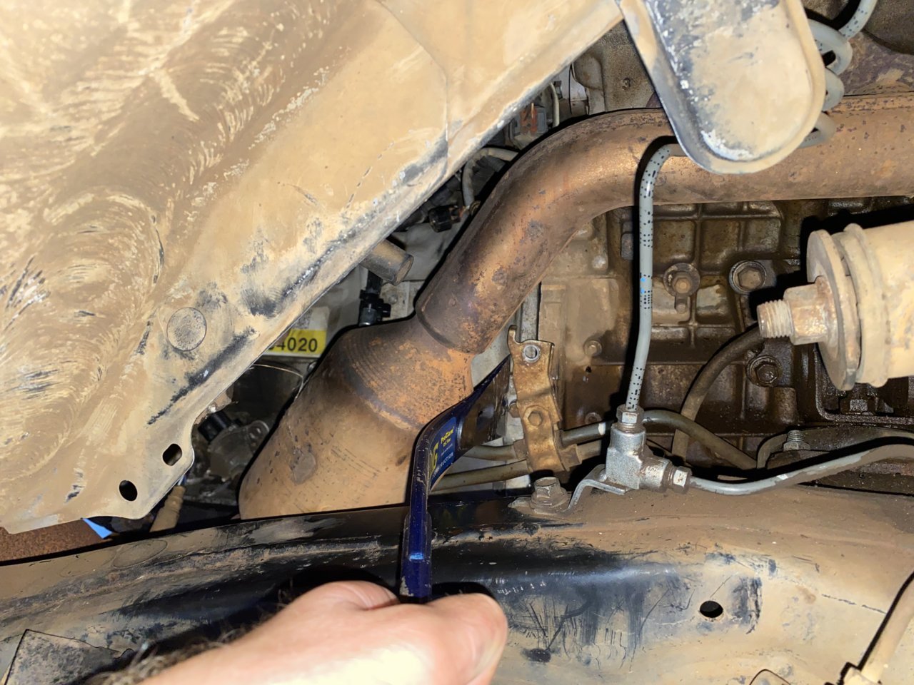

    Just another tip from experience lol. Make sure your nice wire loom doesn’t touch the exhaust. Had my dash lights all working until they got shorted. I think the light got burnt out on the cluster ​

    Oh no, not good man. Shit happens. You’ll figure it out. Sorry brah
