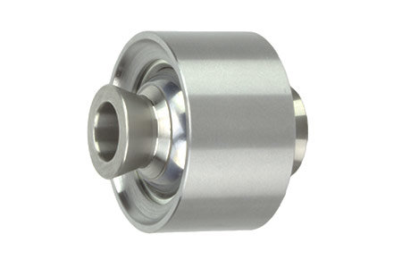

    Has anyone done a swap to a uniball style press in as a ball joint conversion on the ucas?
    Main Question:what size( press in )are our uca ball joints?as in how wide is the press in part of our ball joints?(2000 taco). I want to press out my ball joint on the stock spindle and replace with a press in style uni ball/heim joint
    Pic for example.

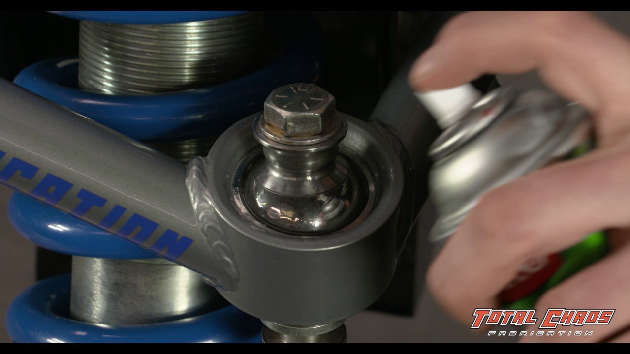

    I don't really understand your question. What is this "adjustable length" and "more beefy stem" you are talking about?

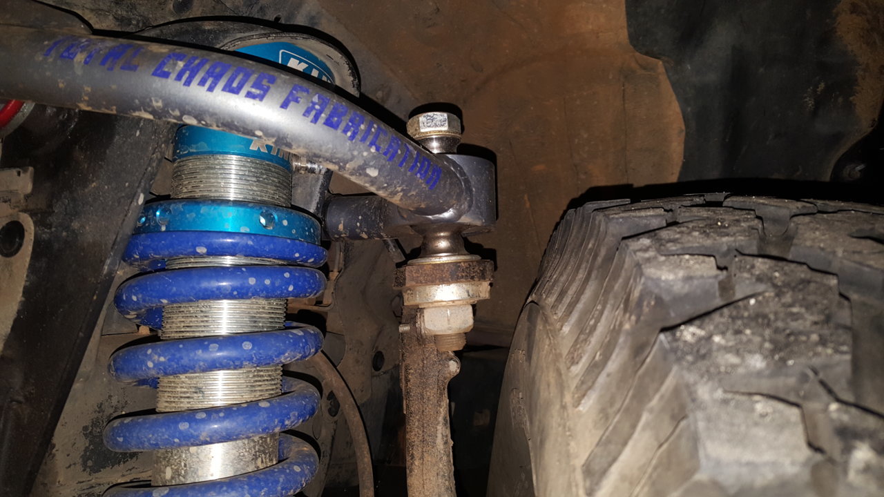

    The TC you posted is a uniball. They come with a plug that presses in to where the stock BJ mounts to the spindle, you then bolt the uniball with that giant bolt to the spindle/plug (see below) - the silver ring between the spindle and the bolt is that plug. Press it in the spindle, then a C-clip keeps it in place.

    I want to press in a uni ball in where the old ball joint is just like the uniball in the pic is pressed into the uca..im going to run a longer than stock and more heavy duty stud up to the uca to correct my uca angle from the lift..i dont know how else to say it..so anyone have an answer to the stock ball joint size?

    That's not pressed in. The UCA in your photo is specifically designed to work with that uniball.
    If you don't want to run ball joints, you need to buy aftermarket upper control arms.

    This is not a press-in thing. The stock UCAs are not designed to accept a uniball.

    That pic is just a reference for what im talking about. Im aware thats a built in aftermarket uni ball but they also make press in uniballs that you can get in the same diameter as the bj bore on the spindle. Im pretty confident in this fab set up im doing. Im going to run a couple spot welds on the cup to the spindle as well for extra hold once pressed in. Then im going to run a longer and more beefy stem such as a grade 8 to the uca
