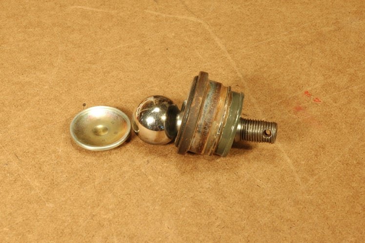

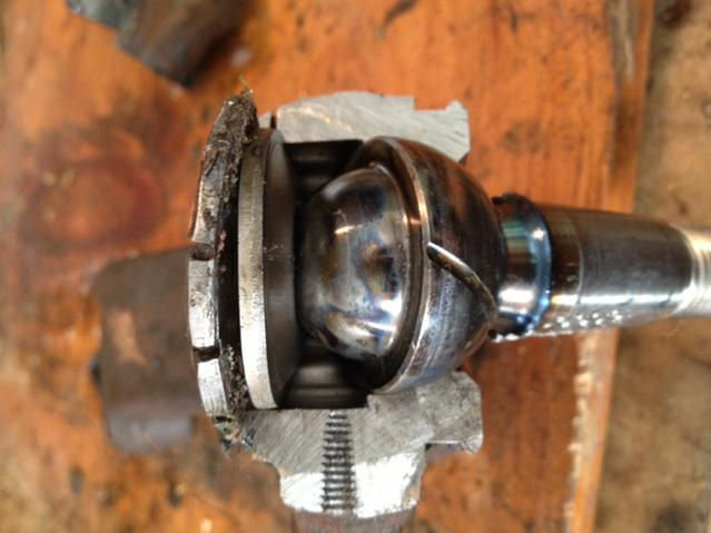

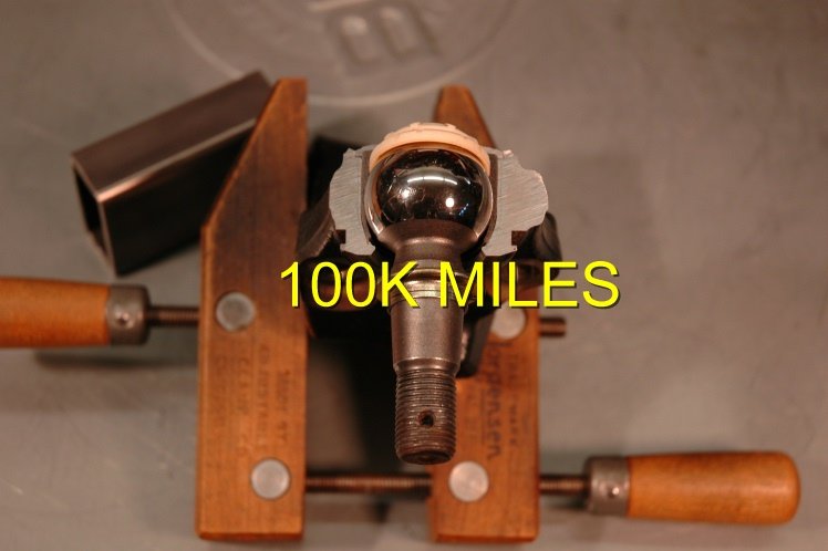

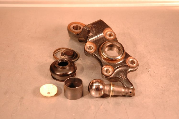

    It's possible to press apart but pointless as there are no replaceable internal parts.
    OEM lower and upper.
    The "Sankei 555" LBJ sold as "premium grade" by Moog, Raybestos, NAPA and others. Metal on metal "half ball" construction, requiring lubrication.
    Superior;) OEM LBJ made by 555 for Toyota OEM applications. Not sold aftermarket. Mirror polished full ball in a PTFE type liner. Among other features.
