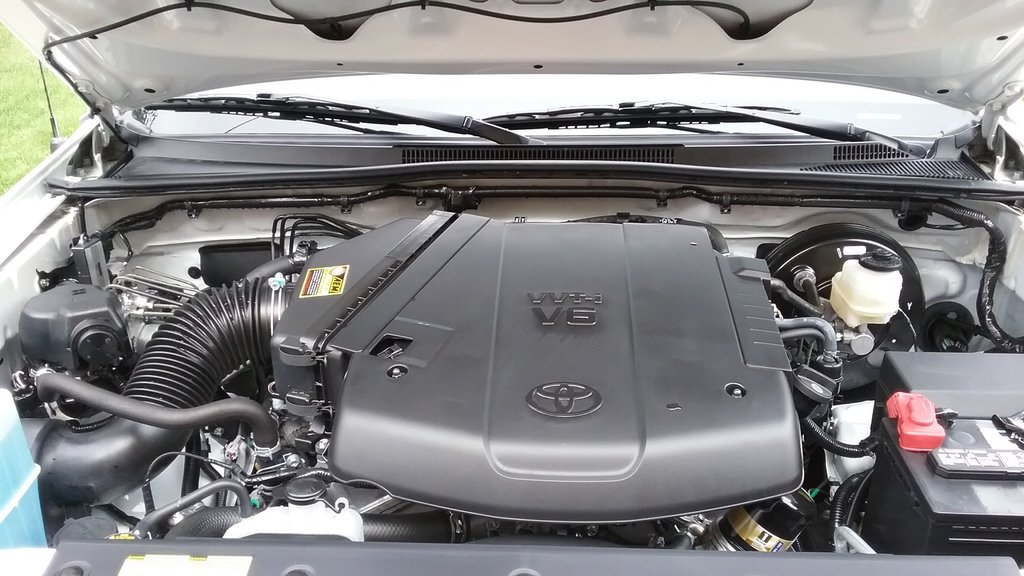

    I just use some Simple Green cut 50/50 with water in one of those pump sprayers. I like to wet down the front-end and fenders first with some cool water, then apply the SG to the cold engine. I let it sit for about a minute and rinse it off with low pressure water (garden hose). Doing this 3-4 times a year makes it easy to clean up without any drama. The engine compartment is not a sealed area and is designed to handle a certain amount of moisture.
    [​IMG][​IMG]
