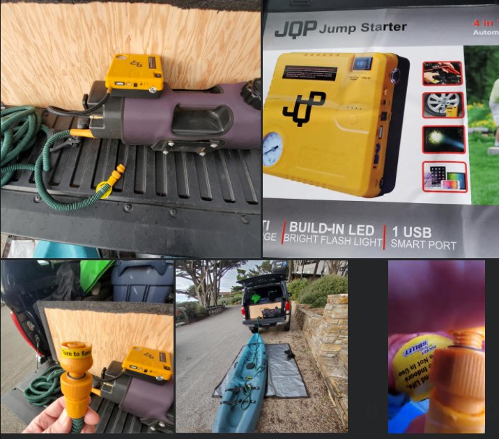

    I use the waterport to get the sand off my kayak after the beach. I use it in tandem with a rechargeable/compact battery charger/compressor. The compressor was the game changer allowing me to really maintain that pressure as the water drains out. Also...very portable which is nice because the spot I rinse the kayak at and the location of my truck are sometimes far apart! Lastly, I added one of those hoses that shrinks up after you cut the water pressure, so that way I don't have to carry the water port around to spray down the whole kayak. Oh...and I used the adapter to put it on the bed rails which keeps it both secure and out of the way.
