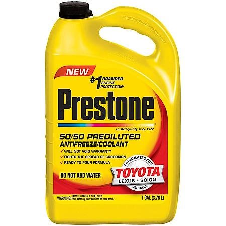

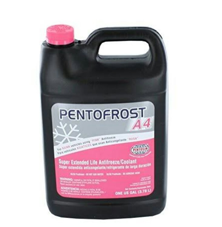

    Hey guys I'm new at this, but tired of all the "Yes this coolant is good for all cars" from an auto part store.
    I'm replacing my thermostat and a coolant flush. Here's an alternative coolant from a very reputable brand.

    anyone using Pentofrost A4 coolant

    I know that brand from old European cars I owned a few years back, it is good stuff. I never thought of that, it may be a better option!!! :thumbsup:

    Yep just did a radiator and engine block drain and used Pentofrost A4. All good

    only thing that bothers me about the PENTOFROST a4 is that their description info says not to mix with other brands of coolant not sure if that would be an issue mixing it with the Toyota SLLC since it basically the same composition. could probably call pentosin to find out about mixing, I plan on just a drain refill, not a full flush refill.
    http://www.pentosin.net/specsheets/Pentofrost_A4.pdf

    It also says the following on the container:
    Pentofrost A4 is mixable with all phosphated OAT’s.
    Meets ASTM D-3306.
    BillsSR5[QUOTED] likes this.

    the ASTM D3306 spec meets the American standard for Japanese vehicles, but the Japanese specs are JASO,M325,JIS,K2234 these specs mean that its safe for the water pump/rubber seals on Japanese cars which aren't listed in the PDF, but I could contact Pentosin easily to find out if it meets any of those Specs if did then I wouldn't have any issues using it.
