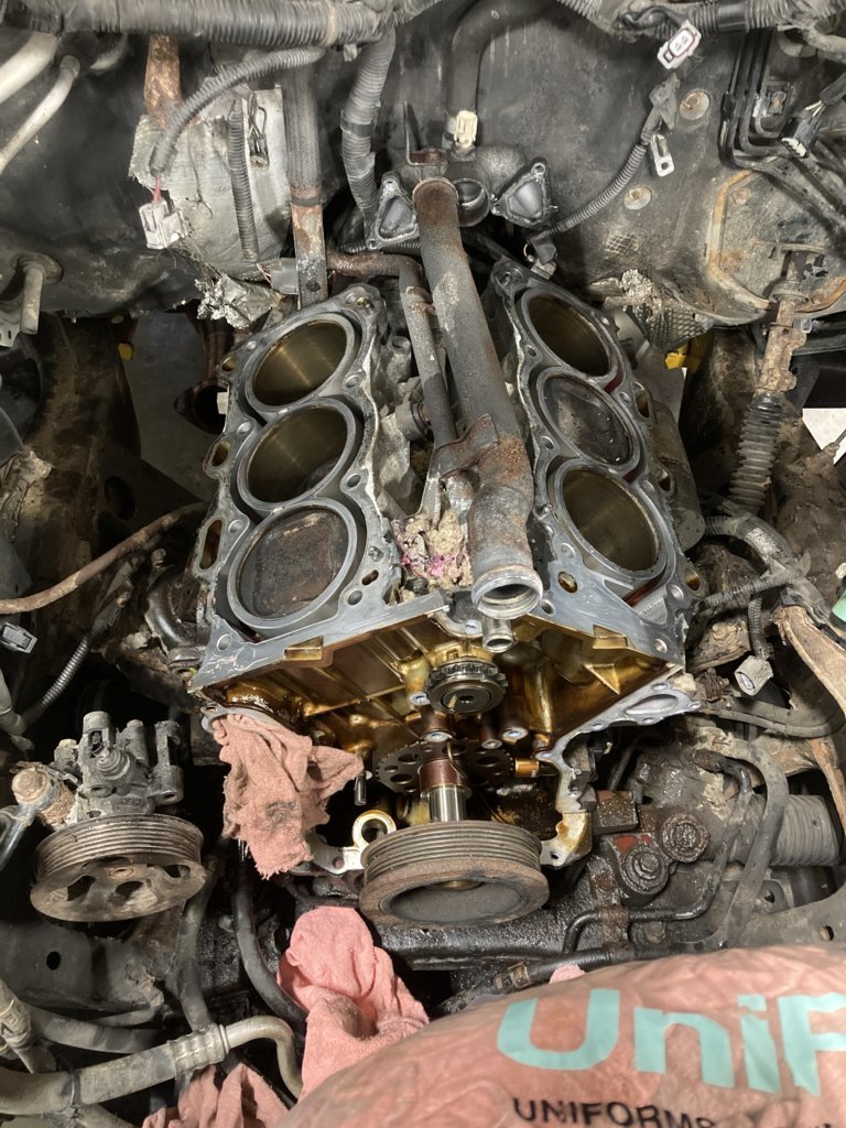

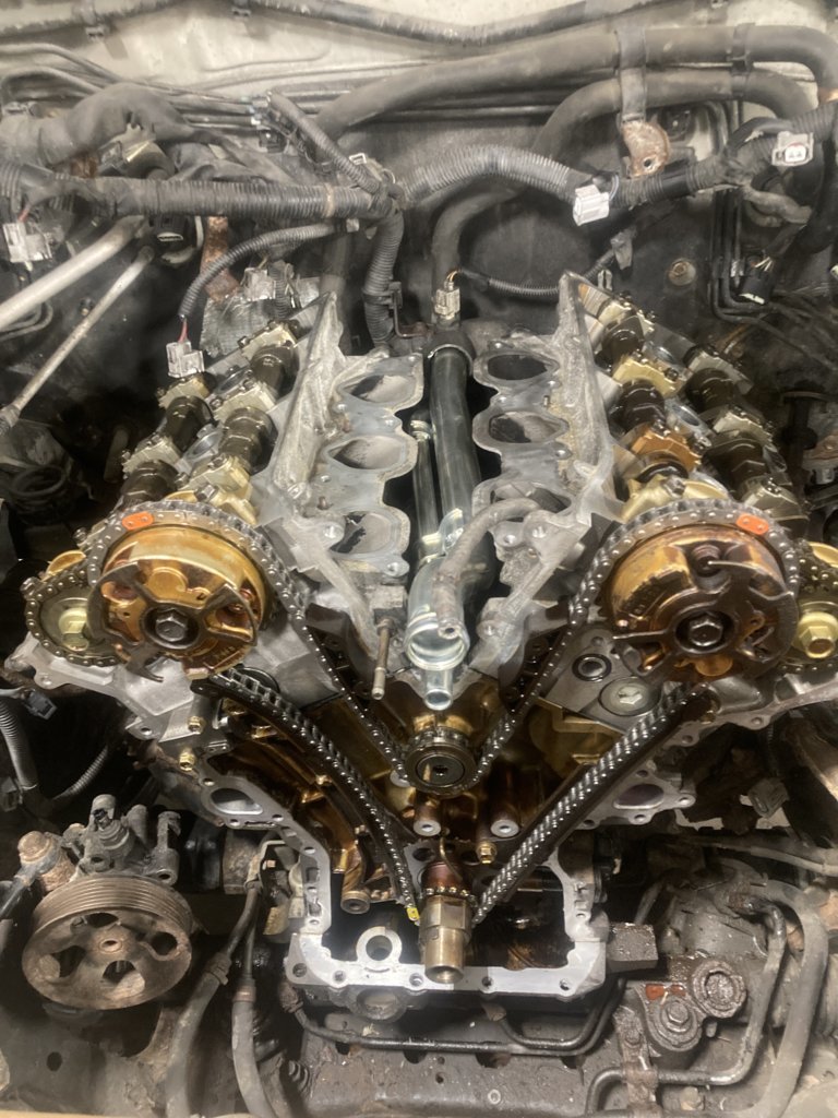

    It’s got a cold air intake so I had the bank 1 coils and plugs off in a few minutes. Already had bank 2 plugs and coils out for the compression test. I got an extra set of plugs so was just gonna throw them in. But I finally finished the coolant pressure test after letting it sit for a couple hours and scoped it and bam… there’s a little puddle of pink stuff. Blown Head gasket. First test proved itself as I did both. I can see the first test working good for a very small leak that you don’t have to wait for 15psi to push coolant through. Anyways now onto the next step. Replacing the HG’s. You said you wouldn’t do the timing chains and guides right or change the valve shims? Why not? Tnx for the advise man!

    It depends. The chain is at a minimum coming of the heads.
    I guess it comes down to how much the chain has stretched and the color of the internals.
    If the internals are tarnished heavily, I'd do the chains, guides and tensioners.
    There no better time than now to do it.
    As for the valve shims, No.
    I wouldn't even remove the cams from the heads.
    See the link below for a general idea of how to "gauge" the chain stretch by the tensioner length.
    https://www.tacomaworld.com/threads/timing-chain-p0018-p0302-304-306.562849/#post-18457731
