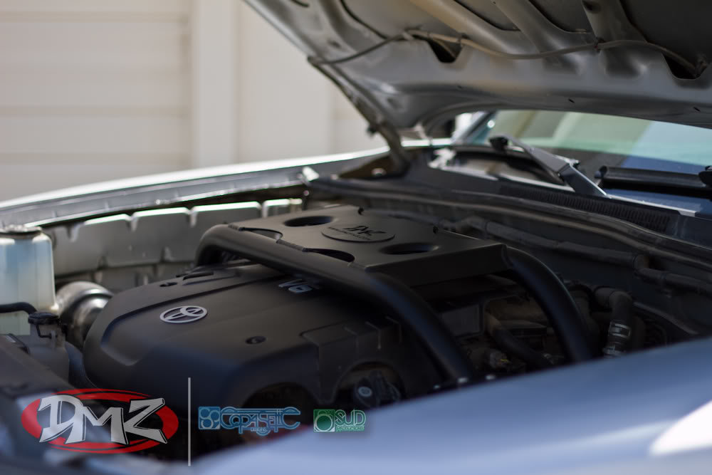

    Although the TC Tower Gussets are a great addition, the whole front frame of the newgen trucks like to flex (or bow) along with the coilbucket. So to further alleviate this I opted to get a crossbar from DMZ that supported both buckets and strengthened the front frame. IMO after it was installed the front end felt noticeably solid through turns and I was more confident after a midjudged hard hit. Visit DMZFAB.com for the price or call.

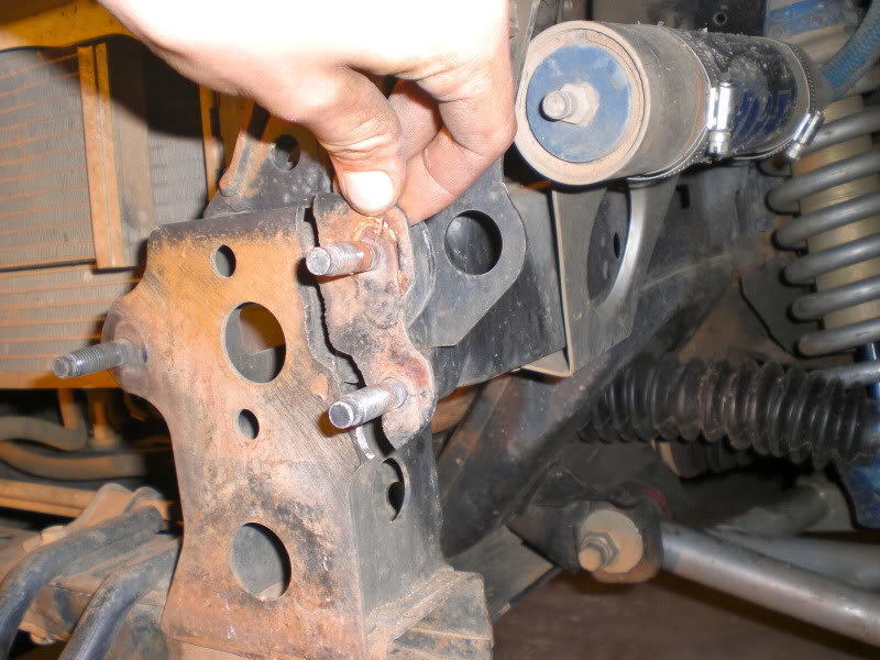

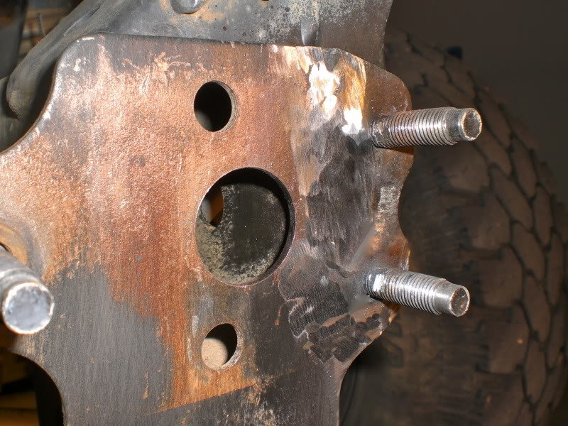

    I've broke my bumper mounts because I was prerunning with a plate bumper. My truck has always been pretty multi-purpose. I have plans in the near future (tube sitting in the garage) to build a tube bumper with aluminum skids and relocate the winch to the rear of the truck.
    The damage:

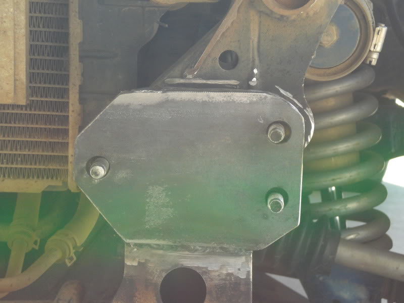

    Repaired:
    Making sure it won't happen again:
    1/4'' steel brace plate welded on all four sides to the stock mounting plate.
    Both sides on, welded, and painted

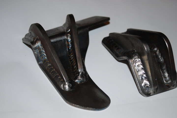

    Mark, do you have a picture with the TC LCA/alignment cam gussets mounted?

    shitty pic of the cam gussets installed...

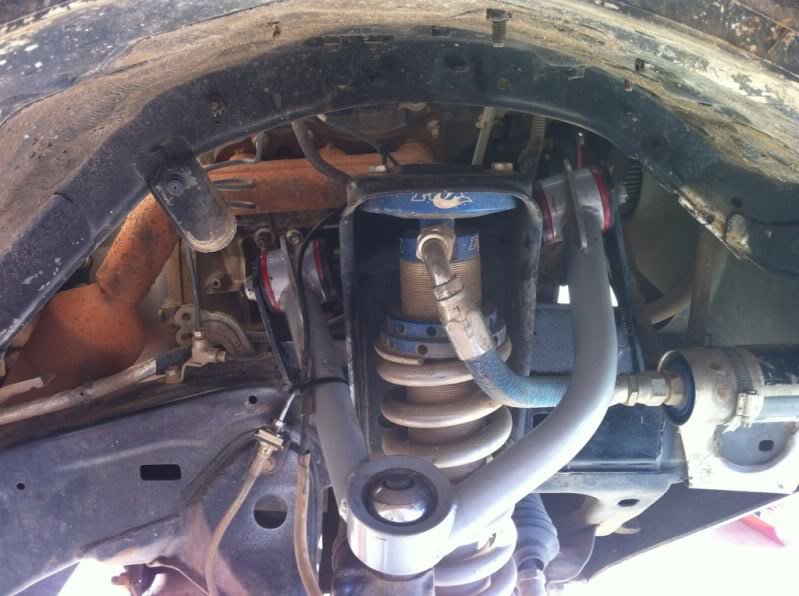

    Cam gussets from tc on 1st gen
    tc uca/coil bucket gussets
    Same side

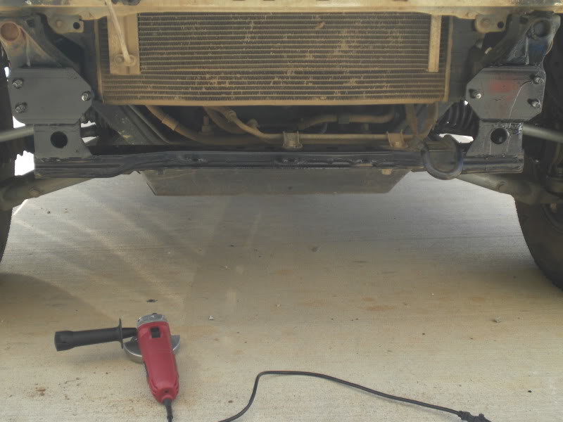

    This is what will happen if you dont gusset your motormounts.....so gusset them first before they break. Once they break its even harder to fix, because you gotta either jack up the motor or remove it. I believe Mpower had to pull his out.
