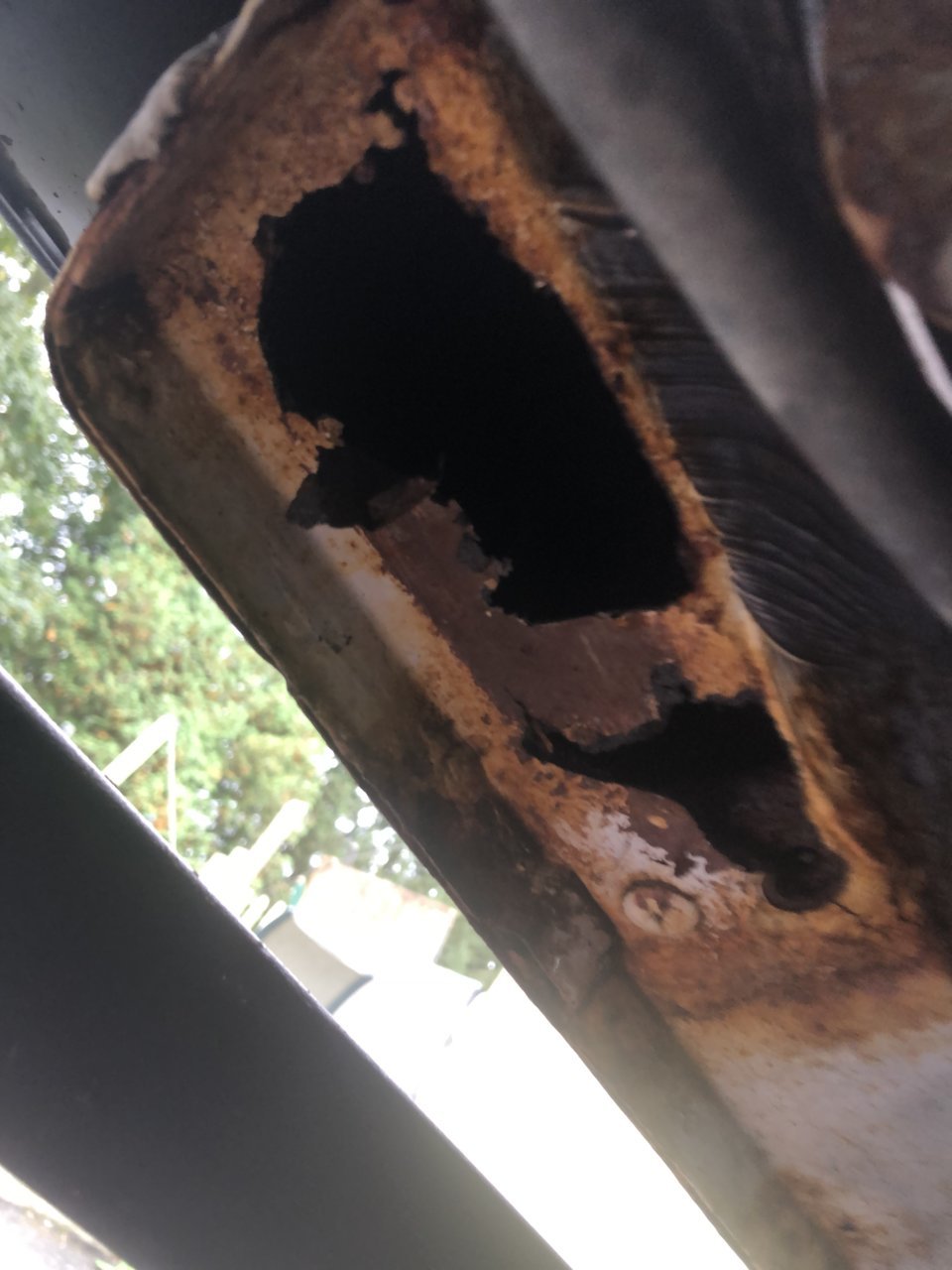

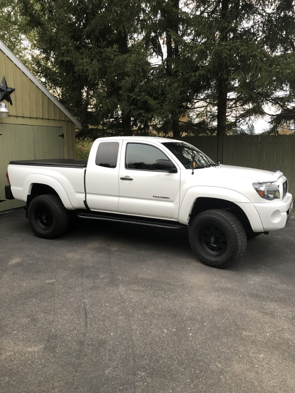

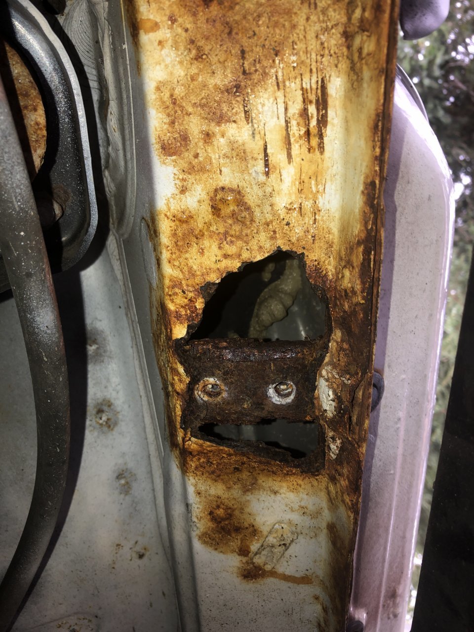

    2008 that I bought new . Always washed underneath and cleaned and painted . Been applying rust prevention for the last 6 years . Nothing stops rust :mad: this is now going to cost $3400 to replace rocker panels . Some of the cost is due to removing and rewelding the sliders back on the frame . Other than this crap my truck is like new . New frame in 2018 ,new suspension in 2017 . Only 138000 miles .

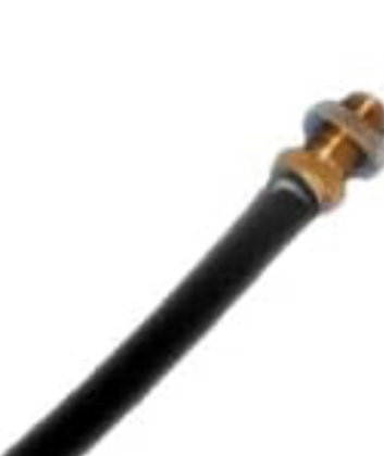

    This is the best pic I could find quickly. That screw adjuster has a bigger impact on how much comes out of the gun than the pressure itself. I know this because I was cranking the psi way up and still not getting much out of the gun. Then I started adjusting that connection and it really opens it up to what you want. If you screw the extender all the way in, it almost cuts the flow off completely. You’ll know and I mean as you mess with it.
