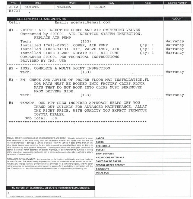

    Cutting kind of short but I'm taking my '12 in to the dealer on Monday. Just have to remember to take the Uni Filter off & put the original back on.

    Thank you Toyota

    Does your truck now run the SAIS at shutdown as well as startup?

    Not at shutdown

    Ahh ok. I wasnt sure if that service campaign for the 2012's would re-program the ECU to do the purge cycle at shutdown. Or if it was just new parts

    Really they did this?, of course like frame recall I dont qualify for that. Moisture in an unlubricated valve causing failure is no surprise. Seals brake down, steel and aluminum become one. The valve only operates once in a use so in a period of 10 years using it a couple of times a day thats only 7,000 times the valve operates.
    Maybe reprograming the the ecu to purge the valve at turnoff might be the best preventative maintenance? Seems like a really easy precautionary measure.
