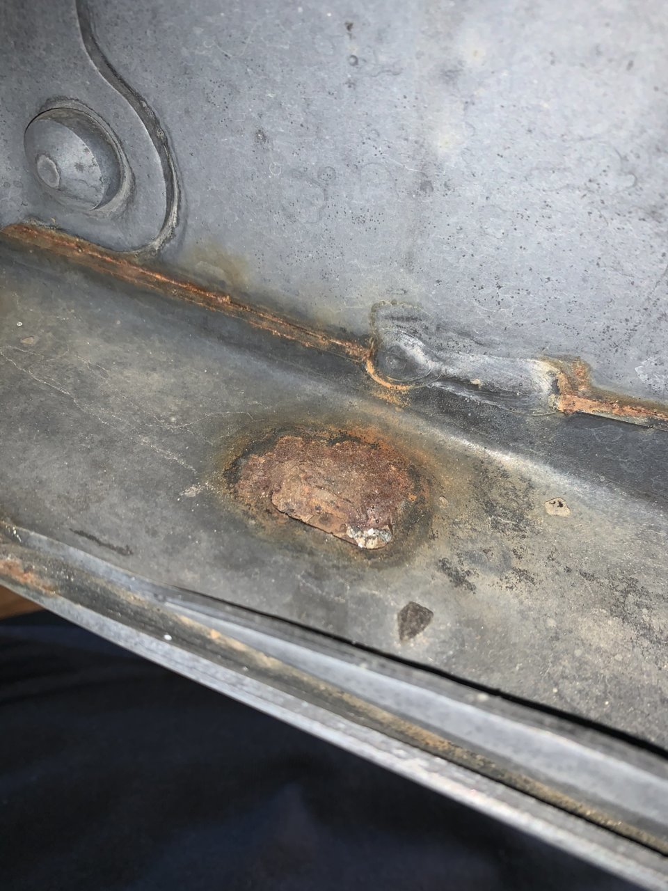

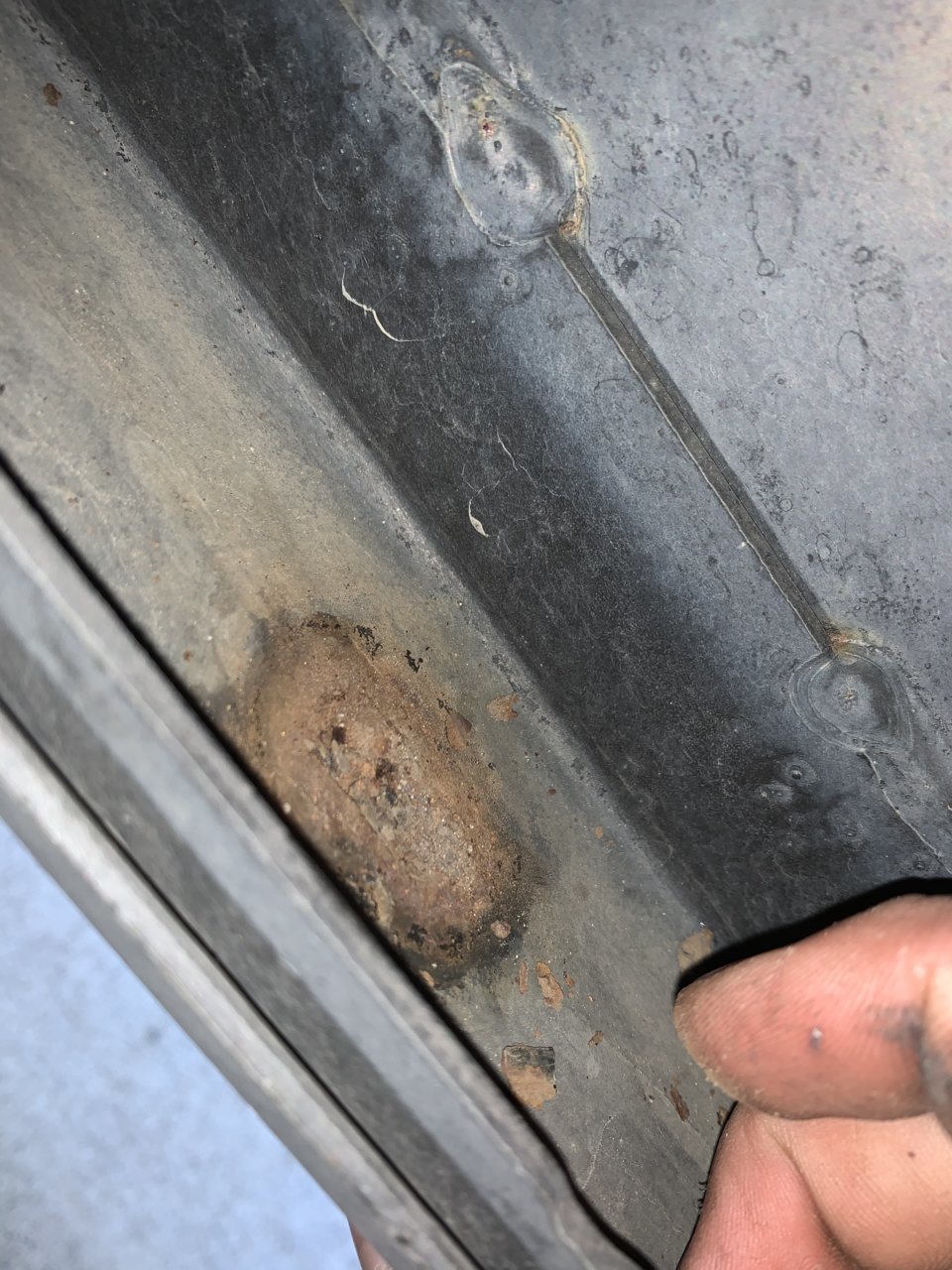

    Now I got a new question, I’ve seen the rust holes some of these 2nd gen frames get, and it seems mine is beginning to start. I dealt with 4 frame patches on my 2002 wrangler I sold removing huge rot each time. I’d prefer not to have to do that down the line with this truck :)
    I do have a whole POR15 kit I was gonna use on said Jeep, degreaser/etch/paint and a few cans of it, is it recommended I sand this first or go right over it? It is called paint over rust I guess. Or is there another method people prefer here? I’ll probably fluid film it this winter or at the very least get a car wash package that blasts the underside of it. Thanks all

    From the pictures/photos: This is what I call a poor or bad design, being that the slots aren't completely filled in with weld and the formed lip going up allows moisture to be trapped in the lower part of the frame rail. Moisture means rust where ever road chemicals are used and don't forget coastal areas, sea/ocean water, and humidity.

    Solid advice, just need to find the time. Selling dealer is an hour away and I would assume a local dealer would care less if my vehicle didn’t qualify for the campaign, however Toyota figured out who qualifies.
    Poor design I agree, I couldn’t really do anything about the rust that forms in between. I’m no stranger to rust after having 4 sections of a wrangler frame cut out and replaced. Was just hoping to avoid with a newer vehicle, although I knew about this kind of stuff on Tacomas from prior research
