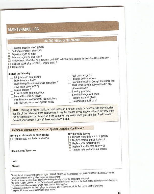

    ummm.... you dont have to change the plugs at 30,000
    edit...only 1gr-fe has to change plugs at 30,000

    Don't forget to change your rear differential and if you you have 4x4 then add front differential and transfercase oils.

    and grease grive shaft if 4x4.

    How do I attach a PDF in here? I have one of the 30k maintenance schedule from the manual.

    Shouldn't you grease the drive shaft and pilot shaft regardless of drivetrain. You'll just have half the work in one. Unless they're ungreasable.

    I know that the pre-runner drive shaft is not grease able and the 4x4's are.
