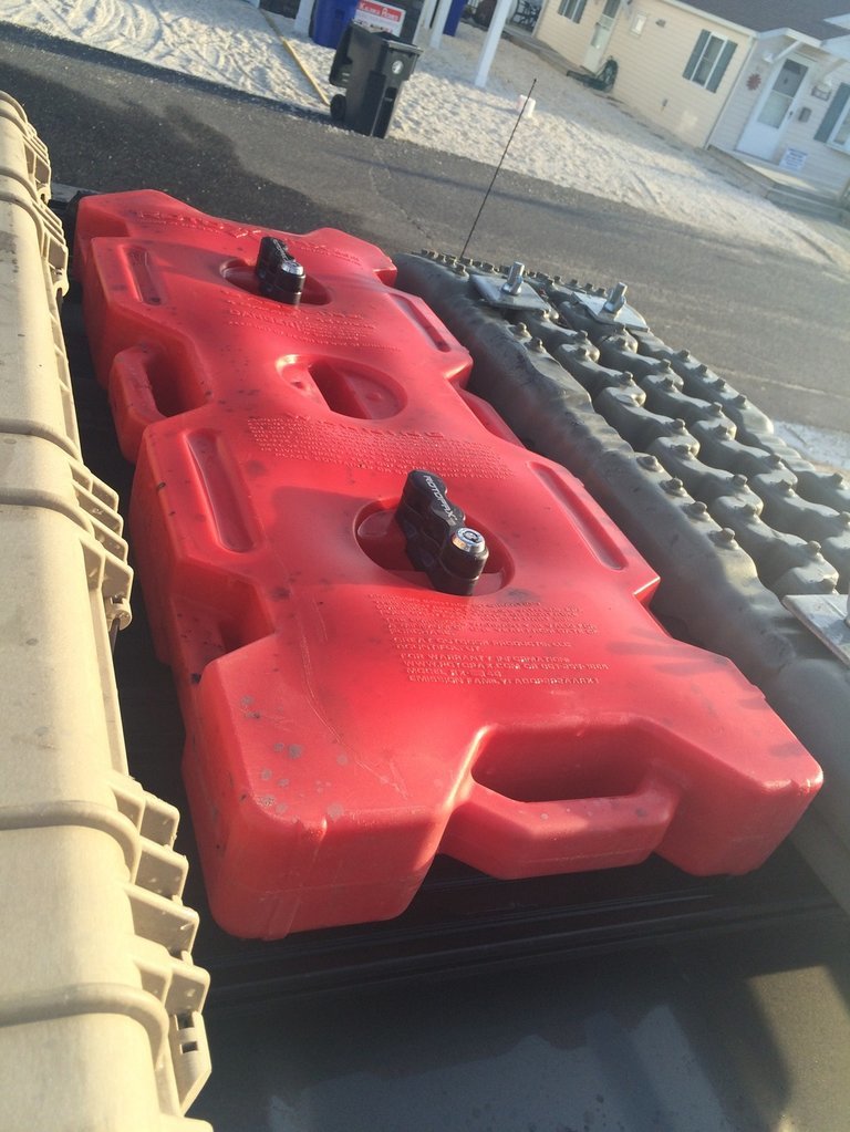

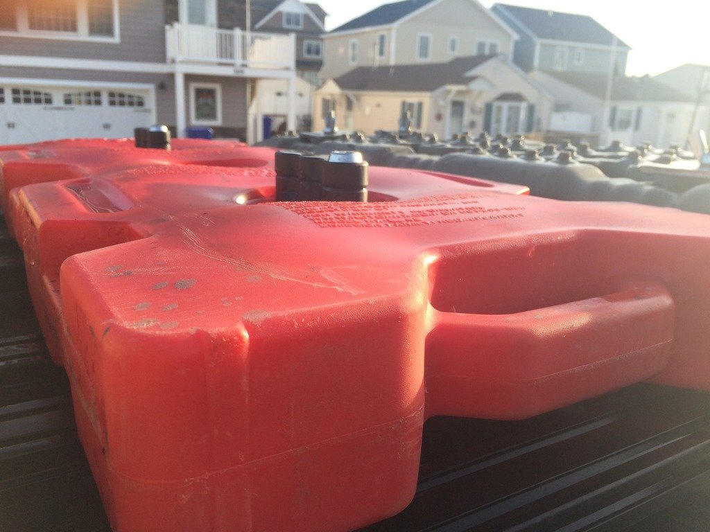

    Hey Zak, got a serious question for you. Do you still have your 4gal on your rack? Do you keep it there all the time? Have you noticed the can warping from pressure? I do keep it on the rack at all times, not always full but recently (maybe as it gets warmer) I've noticed the can warping really bad. I'm worried I might have it end up leaking. Any info on this appreciated. Don't know how much I should be concerned.

    I took mine down the other day temporarily. I have had it on the truck full since I got it. It is swollen and warped a bit like you have shown but it has never leaked. I was curious just like you. I stuck it under a big bundle of extrusion the other night and it flattened out and reformed back to the normal shape.
    I doubt that leaking will occur but I am not sure how to keep it from swelling other than to not always fill it which defeats the purpose in my opinion. I am going to talk to Rotopax and see what they have to say and if they have any recommendations.

    Another thought, how would I be able to stack cans after this warping :notsure:

    I had mine stacked before and honestly they didn't start warping till after I removed the top layer. I had the storage and first aid combo on top which I think shaded and shielded the fuel from heat. Maybe that is the best solution.

    You know that crossed my mind today. But seems like a very expensive solution. I would need longer T handles and I really don't have a need for more cans. The only thing I could wrap my head around working would be an aluminum plate same size as the 4gal can just to deflect the heat and sunlight. Other wise like you said I don't wanna put 3gals, in a 4gal can lol. Anyway would love to hear Rotopax feed back bout this.

    Figured I would chime in on the rotopax convo. Mine has been swelling up and talked to a couple different people about their experience. Its good practice if you leave them up try to either have them empty (stupid i know) or relieve the pressure every couple of days (kind of a pain since you need to take them off). Another member had a can leak at the seam and talked to rotopax and they took care of him IIRC.
    With my bumper coming soon (hopefully) I decided against the rotopax mount and going with jerry cans so I don't have to worry about swelling/ breakage, and leaving the rotopax off unless I need them for a big trip.

    I tried contacting the person I was working with to become a dealer and haven't heard back. I researched on a few other forums and found similar conversations with no solutions and little feedback from rotopax.

    I also "bleed" the rotopax every so often to let the pressure out. I've had mine for 1.5+ years with them outside the entire time. They did warp a bit but haven't leaked. Sometimes I just leave the caps slightly loose so pressure doesn't build when they're not in use. Zach I got the mount thanks again!

    Good to know. I still have't heard from rotopax so what you are saying is probably the best bet. Sorry the mounts took so long.
