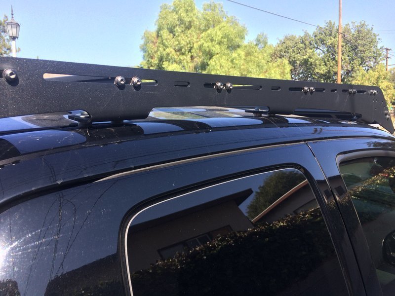

    I am getting close to purchasing this but have a measurement question,
    Can a set of MaxTrax be stored with the pin set via the stock bars that come with the unit or am I going to need to purchase an additional bar to have the spacing I need.
    Make sense?
    TIA,
    GB
    10-22, I think I have my answer by looking closer at this pic...
    So your using two cross bars for the front and rear support and the remaining can be slid forward or back in their respective slotting locations?
  11. Jun 4, 2018 at 7:48 AM
    #231
    GHOST SHIP
    GHOST SHIP [OP] hates you.
    Mar 9, 2015
    #150537
    22,385
    GHOST
    All the crossbars are adjustable fore and aft. The mounting feet for the rack are an integral part of the siderails and it is not necessary to have a crossbar immediately above them. Ideally, you'd want a crossbar at the furthest attachment points fore and aft for "boxing" purposes, but they are not fixed in that location if your setup requires them to move as well. The smart design of the Prinsu allows you to have as few or as many crossbars as you'd like. The extremes of that statement are that you can have only two crossbars to create a perimeter frame rack or have the entire rack occupied by crossbars, making a solid platform if you so desire.
