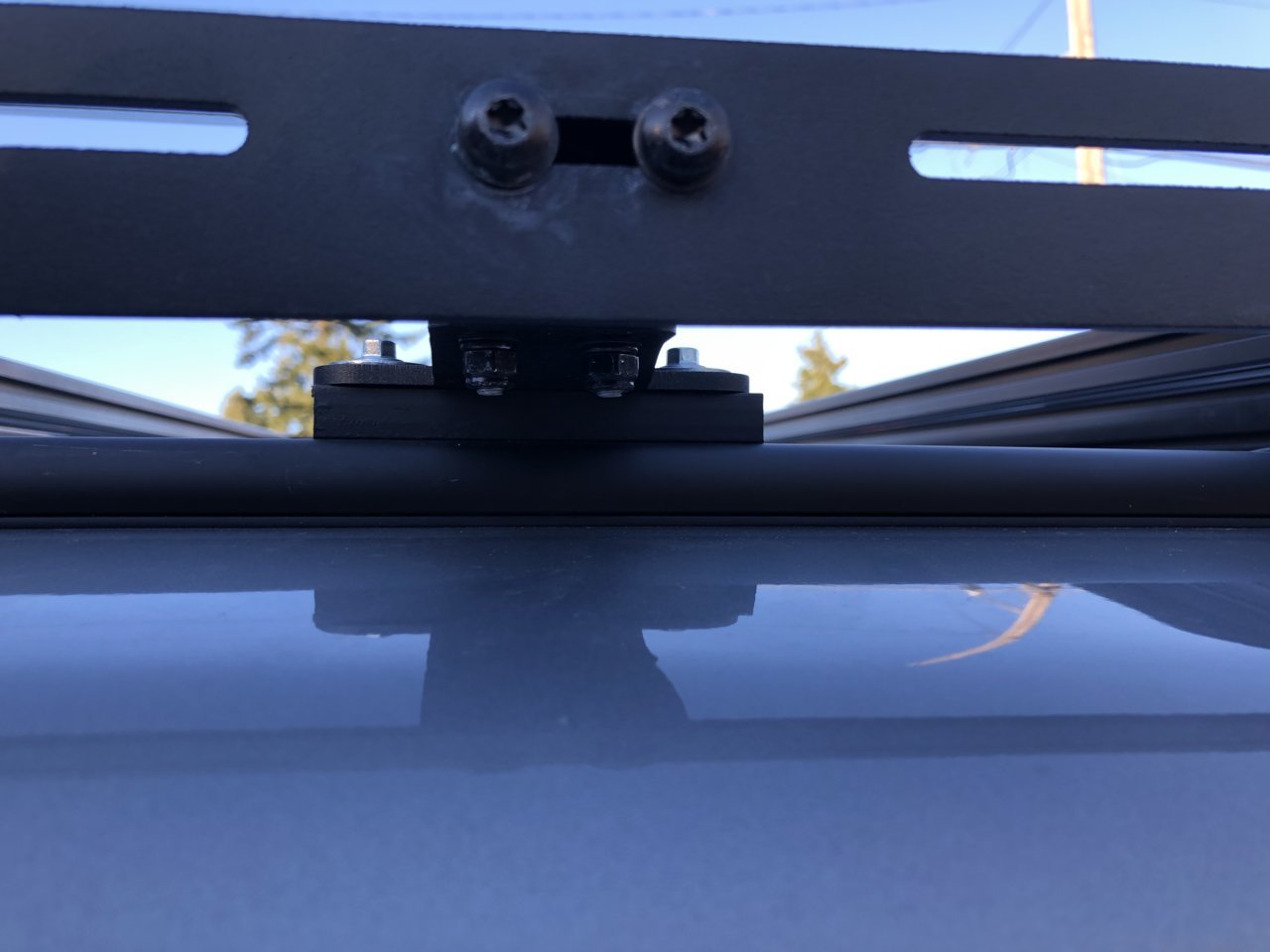

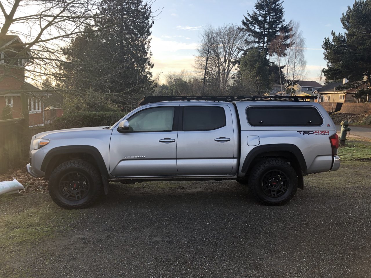

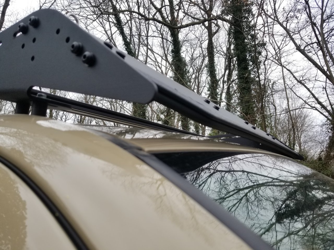

    So I'm one of the people who had the Cabrac and the Coprac *NOT* sit level. This was on a 2019 Tacoma OR and a Leer XR built in December 2018 with Thule rails (my dealer didn't give me an option to chose between Yakima or Thule or whatever rails). The Toprac sat higher than the Cabrac by 1/2 an inch. So I had to buy the low profile brackets from Prinsu, and those had the Toprac sitting 1/2 inch lower than the Toprac.
    I don't know who was "to blame" for this, but I doubt the change is to the truck cab height/bed. And Prinsu hasn't changed anything. And I notice the Thule rails sit up a 1/2 inch up from the top of the canopy...so maybe that is it? Anyway to fix it I just ordered 4 lengths of 1 inch aluminum flat bar that is 1/2 inch thick from metalsdepot.com, cut to the lengths of the low profile brackets i got from Prinsu. Then I drilled two holes in these and used them for spacers (painted them black) and I'm in business. OCD-level shit there for sure.
    toprac sitting high
    leveled
    spacer

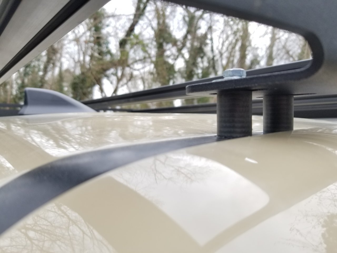

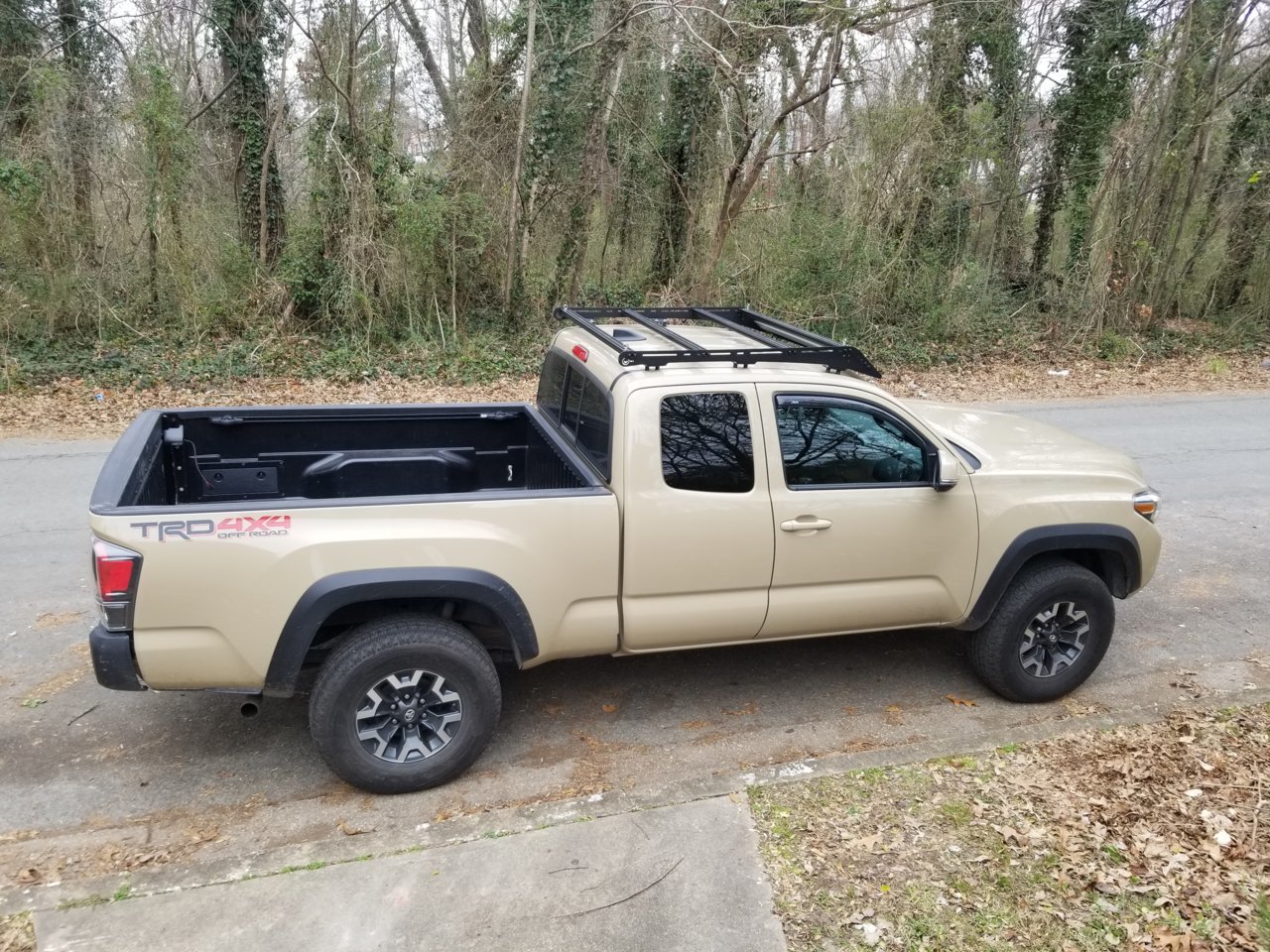

    20190227_120725.jpg My cabrac sat 9/16" below the sharkfin for some reason, also lower than my toprac, so my buddy had a guy he works with make me some new spacers the proper height out of some kind of high density polymer type material. Everything is better now, other than the noise reducing edge trim not touching the roof anymore.
    I can't tell if it's louder than before or not. It was definitely whistling before I got the edge trim.
    Camper shell not in the pic cause it's at the shop having the roof rails resealed.

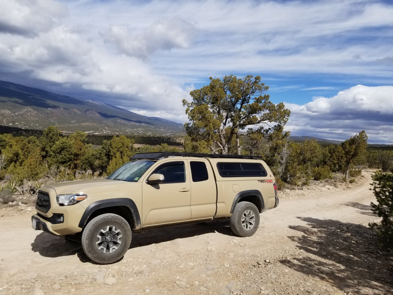

    Pic with the cap back on with new cab spacers. Both level now.

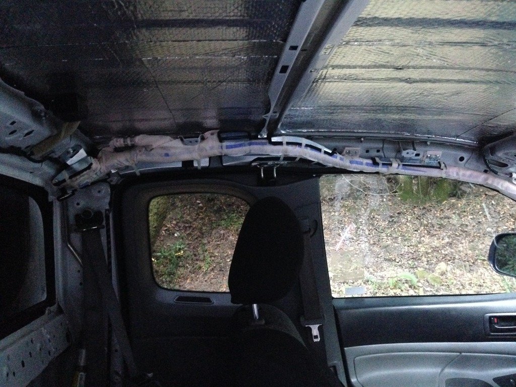

    If you're dropping the headliner then you don't need either nutserts or the tool, just use stainless bolts, stopnuts, and washers. Rhino racks supplies bitumen patches for each of the drilled holes for their ditch track hardware(placed between the mounts and the roof) which seems an excellent idea and deck tape is the same stuff. I also added a dab of caulk inside and out before placing/tightening the bolts. You might shit bricks when you see how close the air bag curtains are to the channels over the clamshell doors but if you remove the bolts holding the bags in place over the doors and loosen the two on each side C-pillar that secure the charge cylinders and feed tube, the curtains can be moved aside far enough to access the underside of the channels at the back(over the front doors there's some plastic headliner spacers but nothing else. Here's a pic of my AC from when I added noico and the ditch tracks. AC7FC63E-043D-42C9-A200-238C7C4E3878_zps_cd500f7b57b6ee7db8fd296212bfb67d9368c65d.jpg
    You're not touching any sensors or air curtain wiring to move them and not removing anything but enough bolts to pivot the curtains to the side a few inches.
