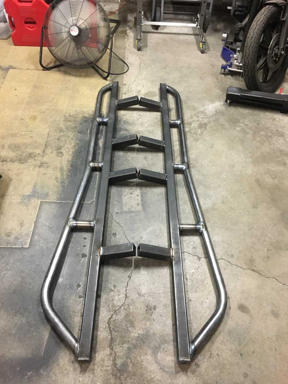

    If one of you guys had a welder for me to use, I'd be doing fab work over there. Just built these little guys last night:

    hmmm we do have access to a little mig. whos truck are those for?

    GHOST
    :anonymous:
    A buddy. They're getting installed this weekend.

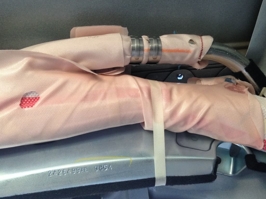

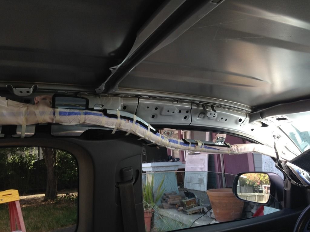

    Drop the headliner first so you can see where you're drilling. Then you can use nut/bolts or rivnuts. Use bitumen patches inside and out. I loosened the air curtains too because they looked to close for comfort.
    150E977B-E09C-4D95-8675-47B81DAFF1BC_zps_462fbaeba8795e3dd70e5c3f8d073f3547fa7ed1.jpg
    This is one of the rear holes on the passenger side with the air curtain bolted back up.
    B2214795-2077-4DF3-B48C-0F253D1EB531_zps_78c9c0cc6c1b72cab7bee3a555857ed22e42e6e2.jpg

    Does anyone have pictures for 2020 SR AC with headliner dropped? Or if SR even has airbags there?
  19. Jul 4, 2020 at 10:39 AM

    All of our trucks do from the base model on up. I highly recommend dropping the headliner and removing the airbag bolts so they can be shifted out of the way if you’re going to drill. Over the driver's door there’s some room but above the clamshells it’s very tight. This thread has some good pics as well as step by step instructions that are close enough for us.
    https://www.tacomaworld.com/threads/removing-your-headliner-and-insulating-sound-deadening.394469/
    FWIW it’s easier to remove the headliner in an AC than the DC because clamshells instead of B-pillar.
