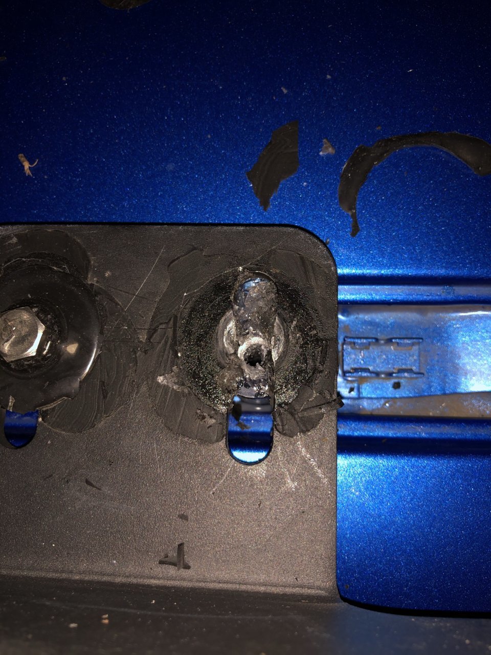

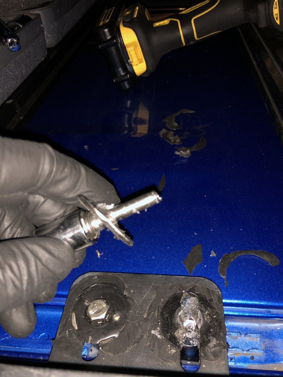

    Well I snapped one of the bolts trying to torque it down. Any ideas on what to do now?

    For reference I had the wrench set at 30lbs.

    As you already learned the bolts don’t need to be super tight. The two issues (for anyone reading this and hasn’t attempted install yet) That could arose are snapping a bolt or stripping the threads out of the rivnut. The rob it’s themselves aren’t graded so they can strip out- Remember how easy they were to crimp down when you installed them.
    for a repair you’re left with drilling out the remnants of the snapped bolt and replacing/resetting the rivnut in the roof. Or you could ditch that mounting bolt altogether and just packing the hole with silicone. There won’t be a loss of functionality for the rack but the lack of symmetry might bug the hell out of me.

    I’d grind the lip off the rivnut, push it through and install a new one. No risk of hitting the air curtain if all the work is on the outside.
