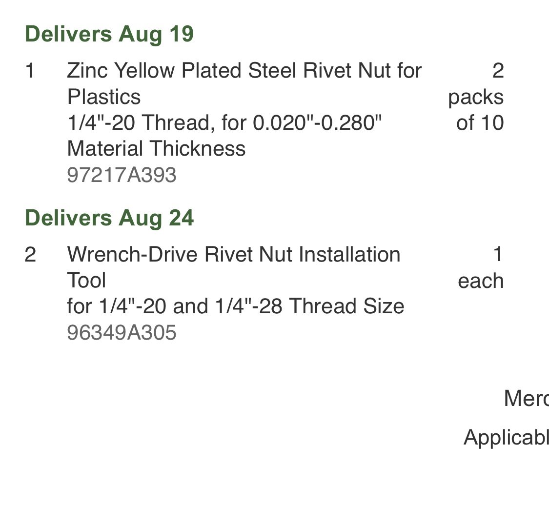

    Currently have open holes in my roof and am finding I'm two riv-nuts and two spacers short. Storms are coming, no one local sells. Anyone know the exact size so I can order online and hope I don't have an open roof all weekend?
  7. May 13, 2021 at 6:28 PM
    #307
    WestCoastBestCoast
    WestCoastBestCoast Well-Known Member
    Jul 12, 2018
    #259158
    676
    Wyn
    Portland, OR
    2005 SWB TRD 6MT 4x4
    No clue what Prinsu sends you, but these are the ones I bought from McMaster since I got my rack second hand.
    And sorry I don’t know the spacer, maybe just measure one and make sure it is 1/4” diameter?
